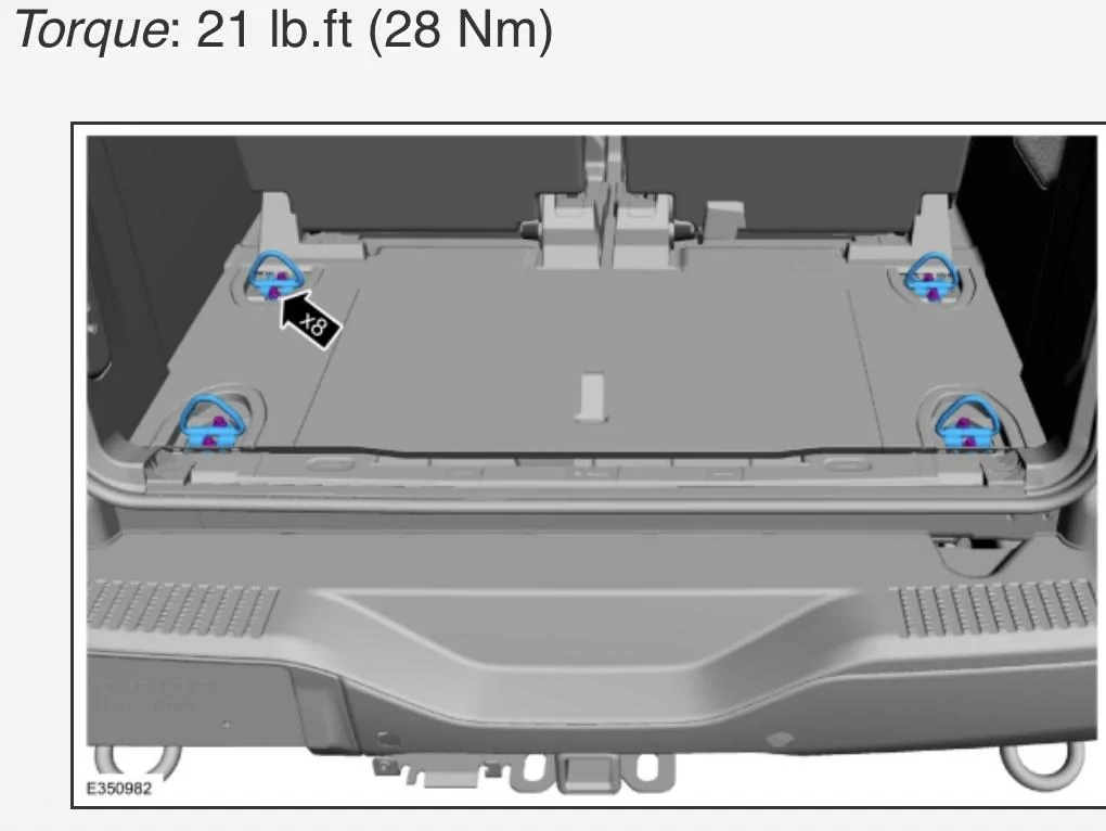

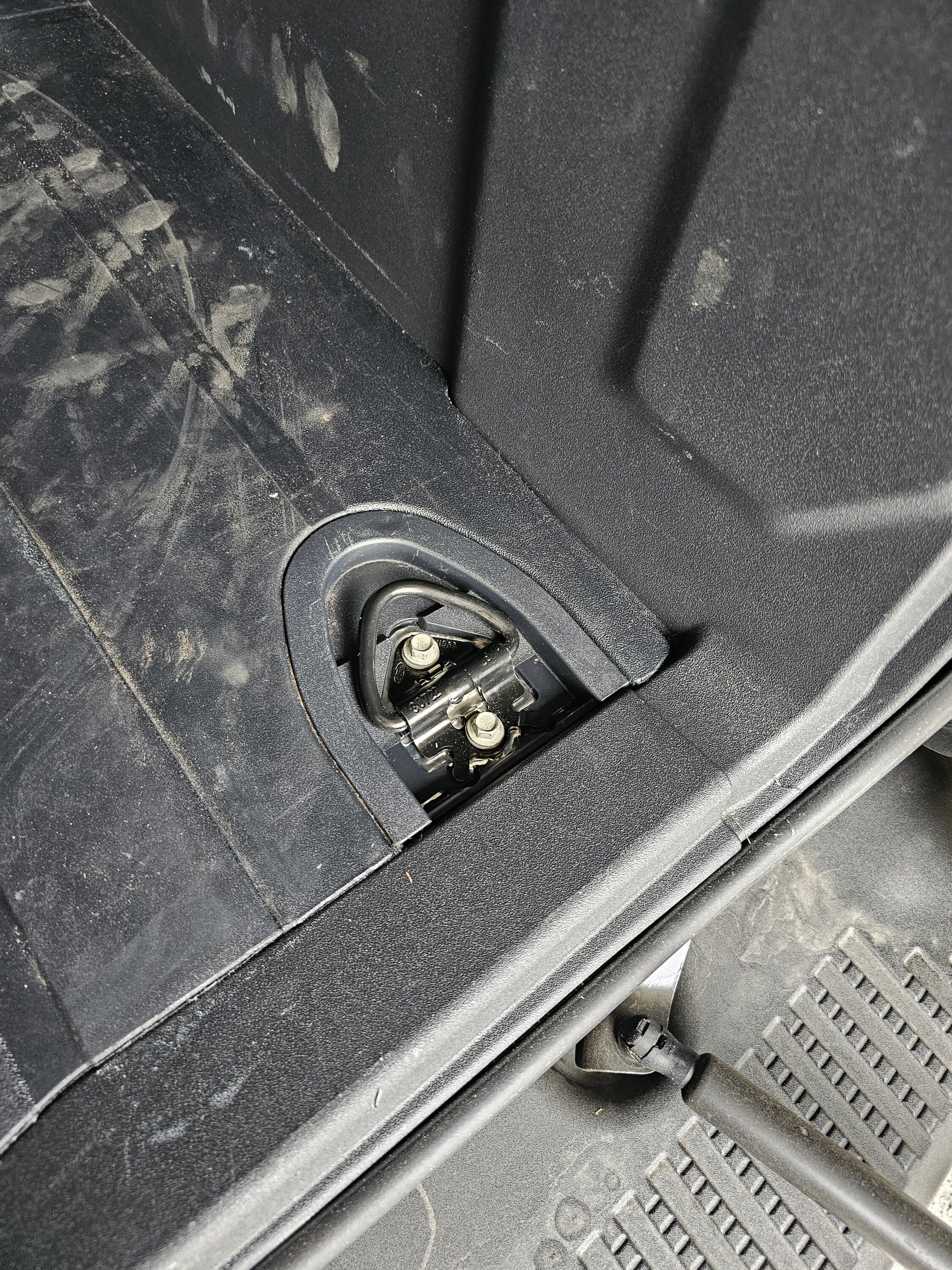

Does anyone have the torque spec for the trunk tie downs? Installed some soundproofing underneath my trunk mat but couldn't find the torque spec for these
Ford Bronco Torque Spec for Trunk Tie Downs 20230917_094912

Where'd you get this drawing? I see people post electrical drawings too. Is there a digital service manual floating around?
I’m a technician. There may be a digital copy of the manual around here somewhere though.

Just snug them down decent not everything needs torqued to specific number.

I'm just used to making sure everything gets torqued down correctly due to my field of work.
Also, what I thought was "decent enough" when I first tightened them down was still 1-2 rotations away from 21 lb ft so I'm glad I asked. The tension on these screws is pretty different than most.
