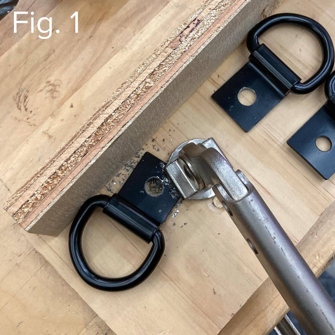

(Fig. 1) The mounting hole needed to be drilled out a little -- 5/16" drill bit. Pinning them against a backstop stops them from spinning.

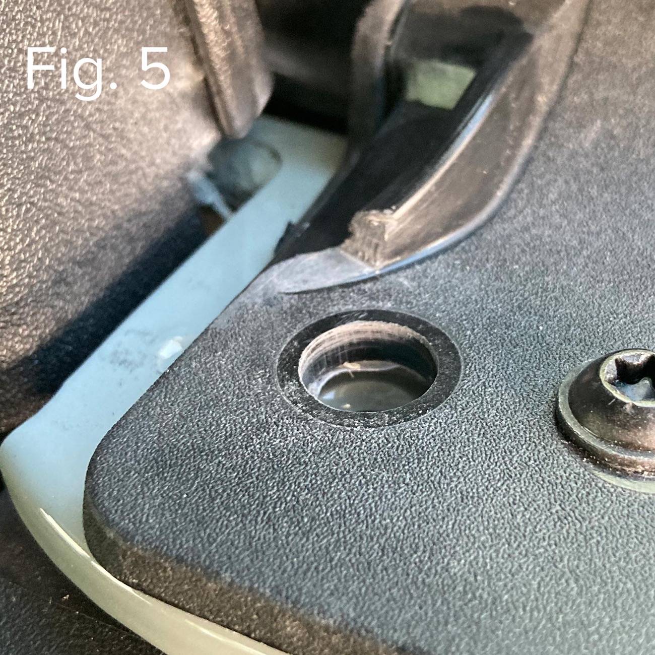

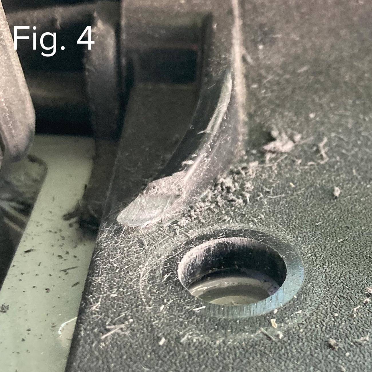

(Fig. 4) Then shave tiny slices off the top. It cuts very easily (pretty much turns to powder). Add to the stop cut after each few shaves. Keep going until flush. (Fig. 5)

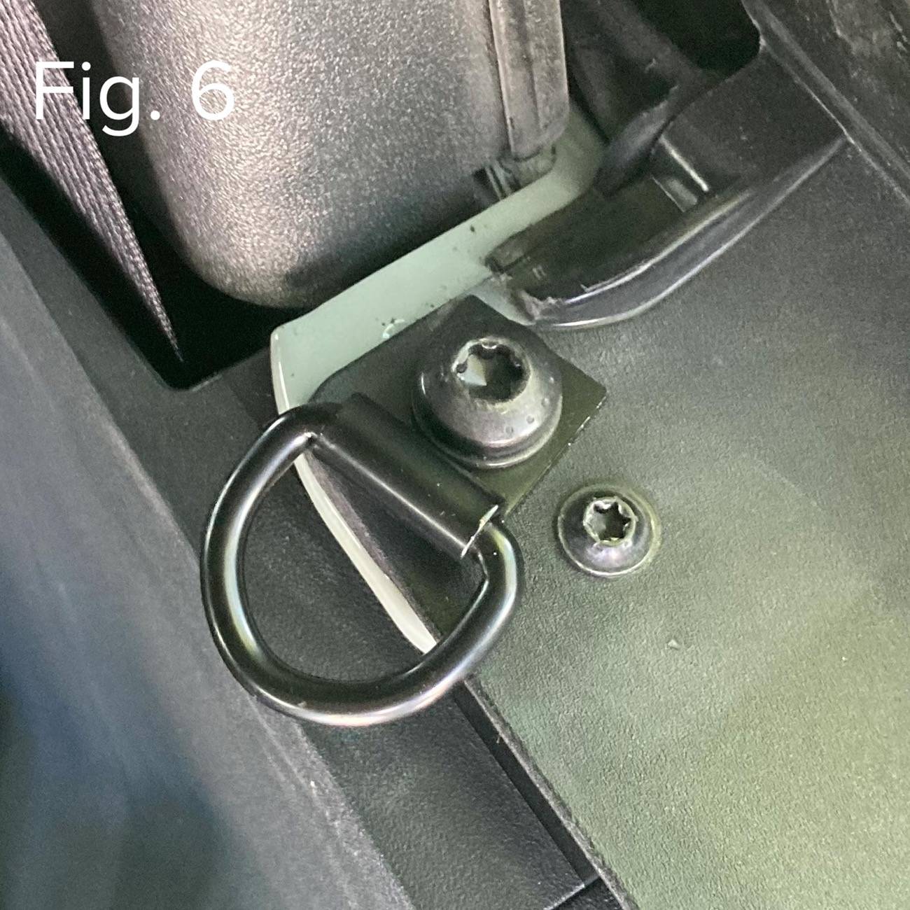

(Fig. 6) I angled this one a little assuming it was usually going somewhere diagonal, but I cut the flange so it could be perpendicular.

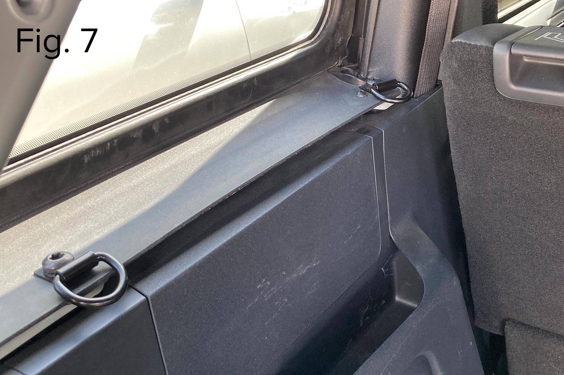

(Fig 7.) Installed on the left side.
So far they don't rattle on my local rough streets, and when there's a load, they'll be under tension anyway. If they do rattle, I figure squirt some white glue in the hinge, let it dry, wiggle it loose, and that should fill up the voids.
