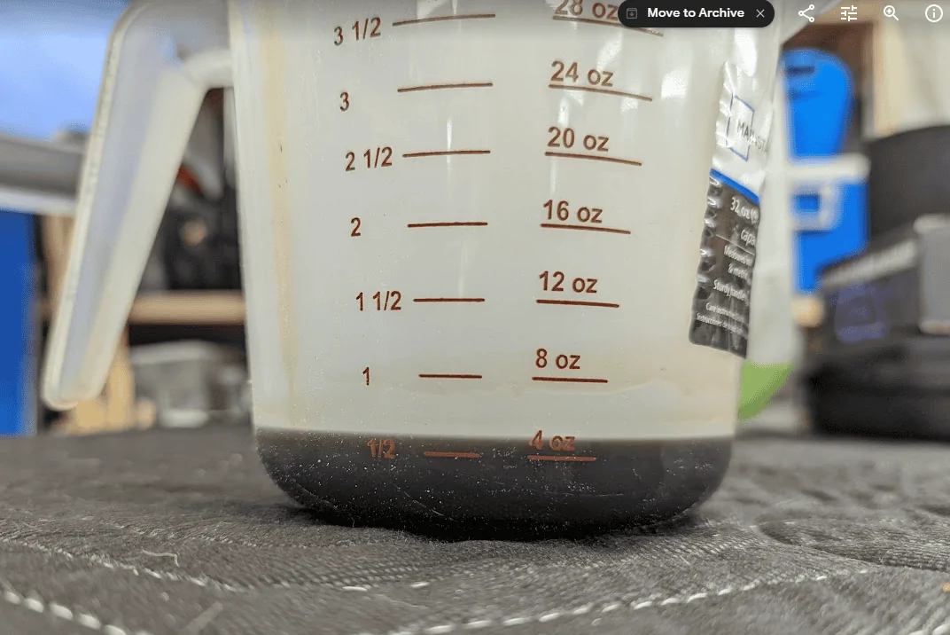

First oil change this past weekend at 3,000 miles on my 2.7L. Didn't realize this had already been discussed so tried the extraction method (since this is my first topside oil filter). After extracting, I also drained the remaining oil at the drain plug and got another ~5oz.

So did you get most of the oil out via extraction/suction and only 5oz came out of the bottom?

Yes, that's correct.
what diameter tubing did you put down the dipstick tube?
I installed the Ronin drain plug during my first oil change and didn't bother trying the suction method, but if there's only 5 oz left, I might revert back to extraction and the drain the remnants afterward - less containers to transfer used oil to and from...
6mm tubing
Also worth noting. I filled with 6qts, have the original dip stick and my oil level is perfectly at the top mark (hole).
