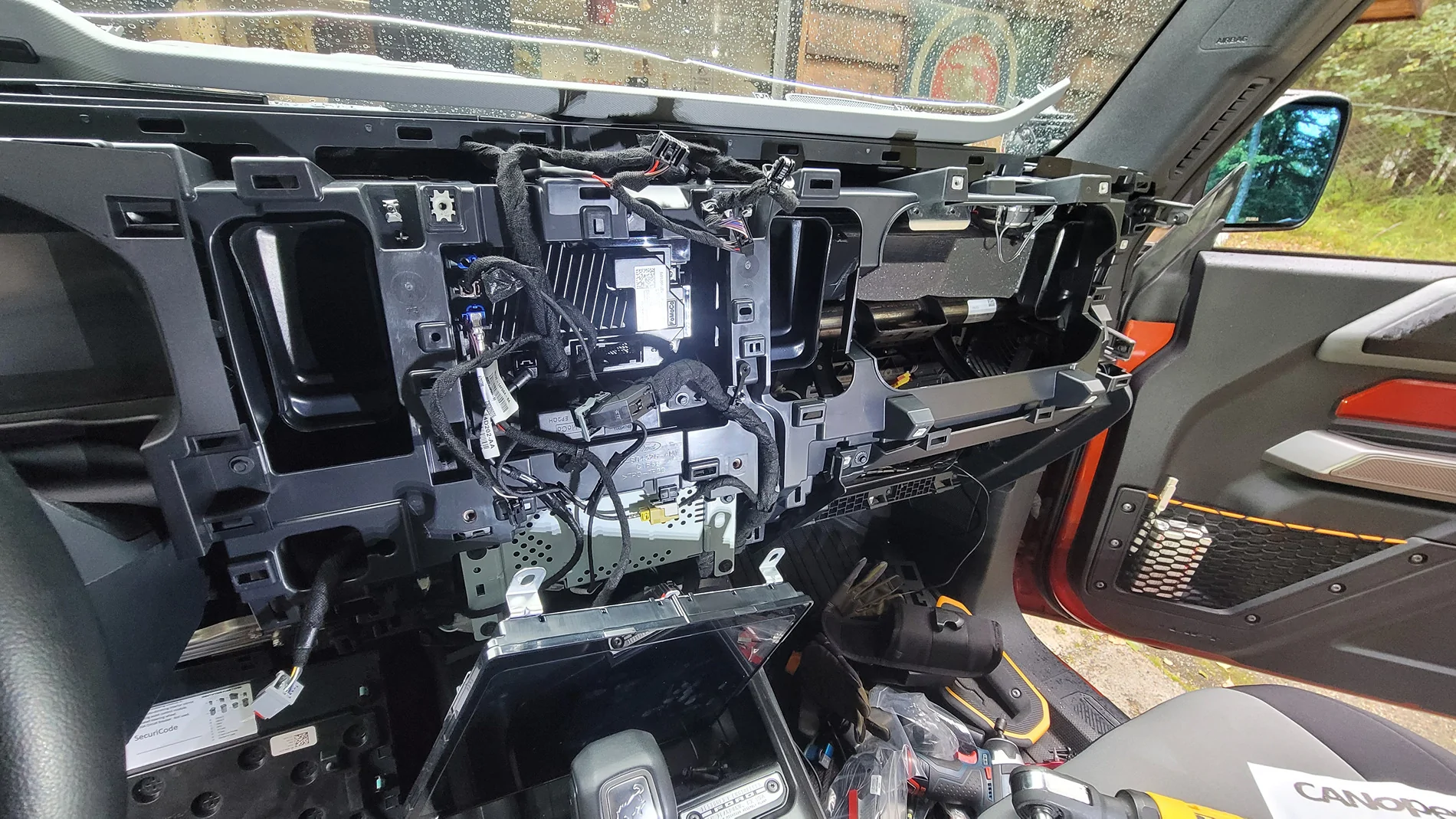

Agree with the above. Installing the 4DTech CANopener give me no audio symptoms initially when the connection behind the HMI screen was not seated all the way. Fully reseating all connections got it back.
Taking your dash down that far to check that connection isn't exactly for the faint of heart though.
Ford Bronco No audio from any source – 22WT 20250901_163735
I was in it for a number of other installs, so it was necessary.
