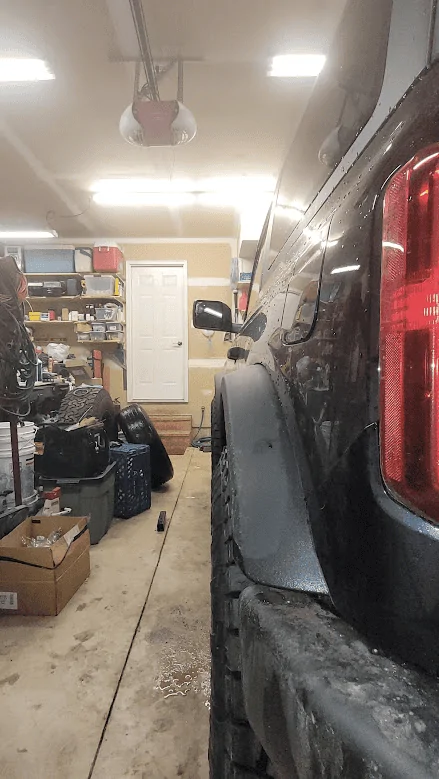

This whole offset thing just blows my mind. Sorry for being so dazzled about it.
I have a 2023 Black Diamond 4-door running 285/70r17 Toyo Open Country RT tires on stock steel wheels with 1.25” spacers. The tire edges _just_ poke out from the flare edge.
The factory wheel offset is 55mm. The wheels I want have a 39mm offset.
I will remove the spacers when the new wheels are installed. I’m thinking I should end up with about the same amount of poke as what I have now. Is this a correct assumption?
Thanks for any help on this.

The difference in offset is 16mm or .62 of an inch. If you remove the wheel spacer, then end result will be .63 of an inch tucked in under the flare
