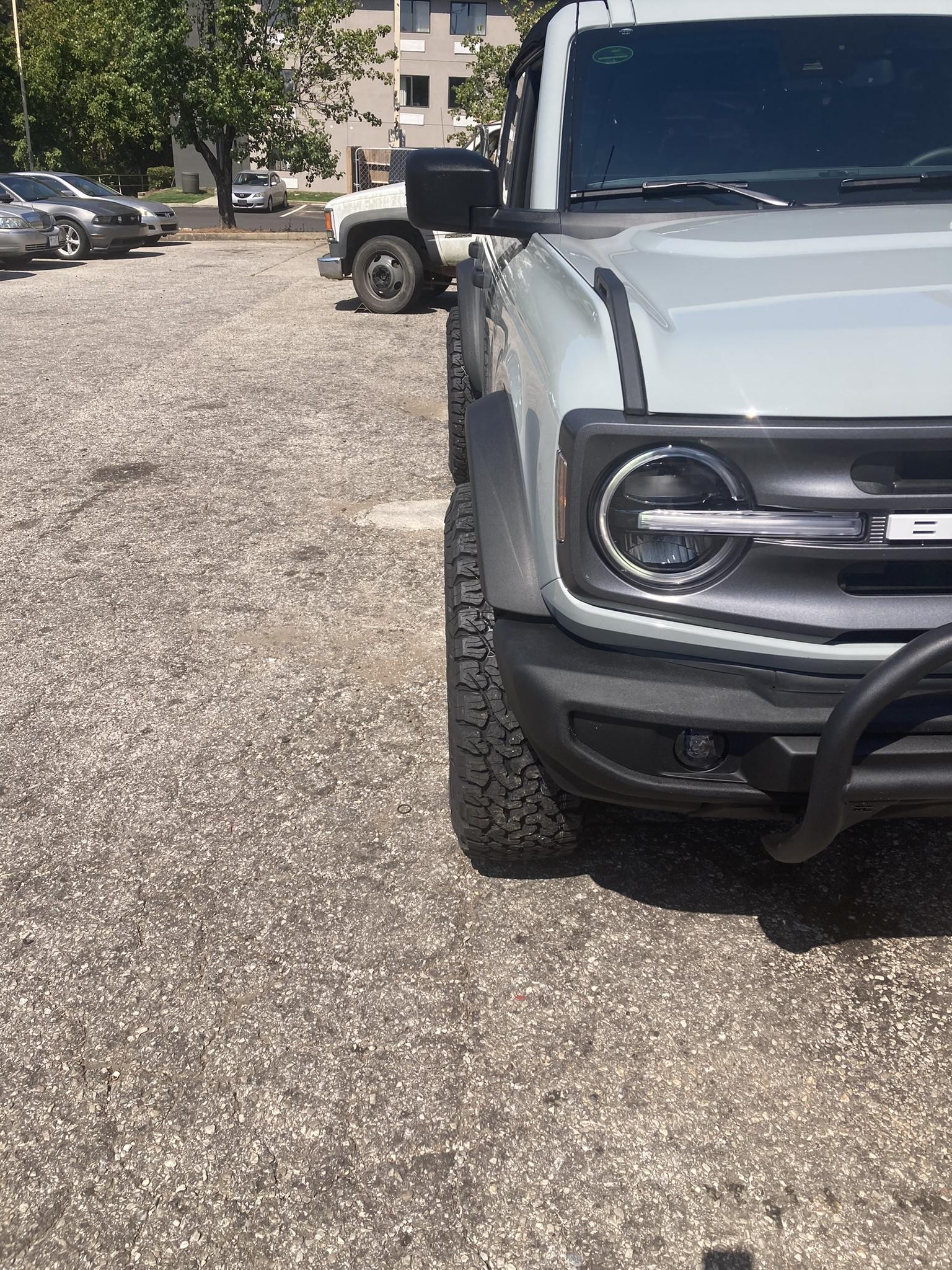

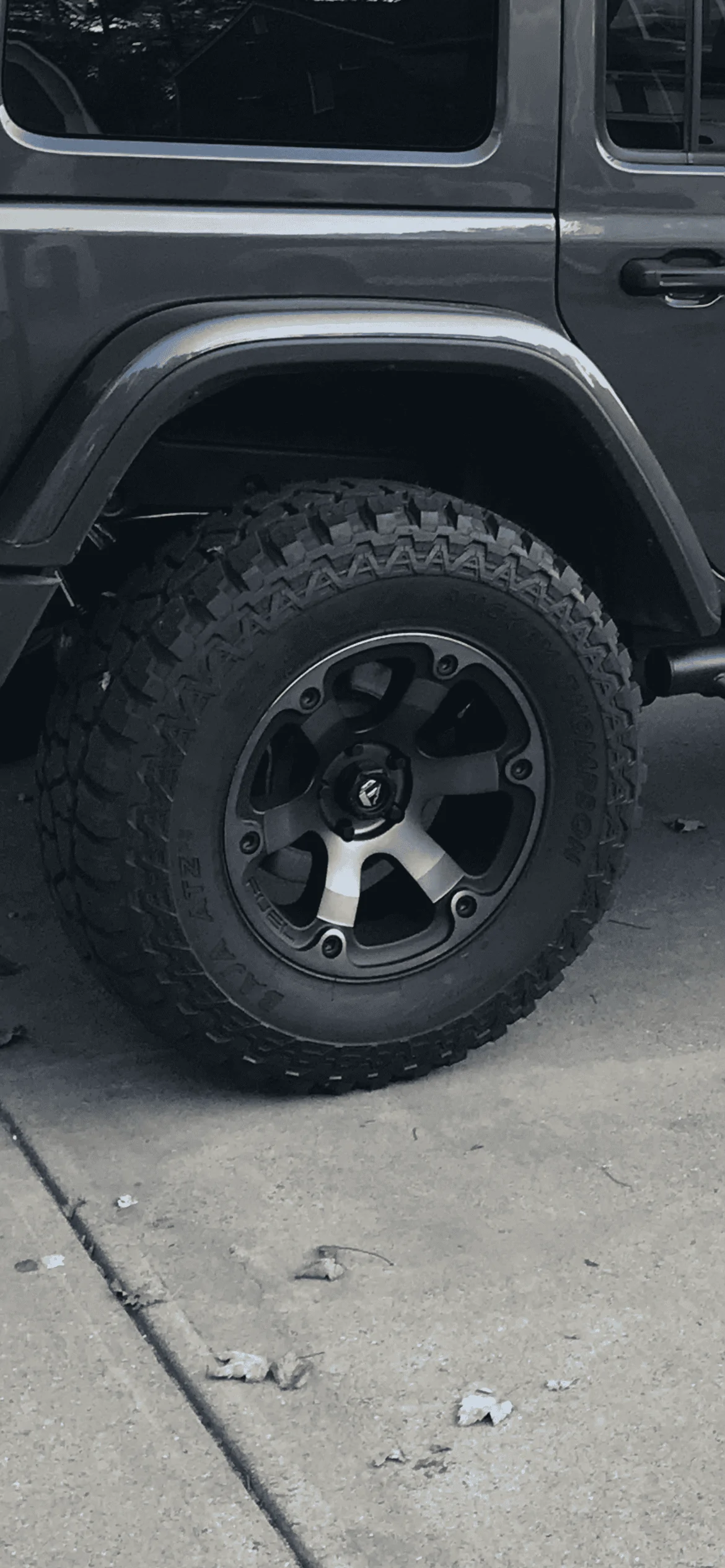

Ok, I have tried the search. I have found some info but I’m always confused on offsets. We just took delivery of my wife’s 2023 Wildtrak with Hoss 3.0. I have some 35x12.50x18’s Mickey Thompson’s I had on my Rubicon for about 500 miles. I am wanting to put them on the wife’s Bronco and get new 18” wheels for it. I have Rockblokz XL for the front and I am wanting to get a little more “poke” than factory. From what I have read I think I will need a 0 offset, but still unsure of myself. Attached is the Bronco and the tires from the Rubicon. Can anyone please assist? Pictures would help too. TIA

The factory wheels are 17x8.5" wheels with +30 offset.
If you get an 8.5" wheel with 0 offset, it'll have approx. 30mm more "poke" than stock.

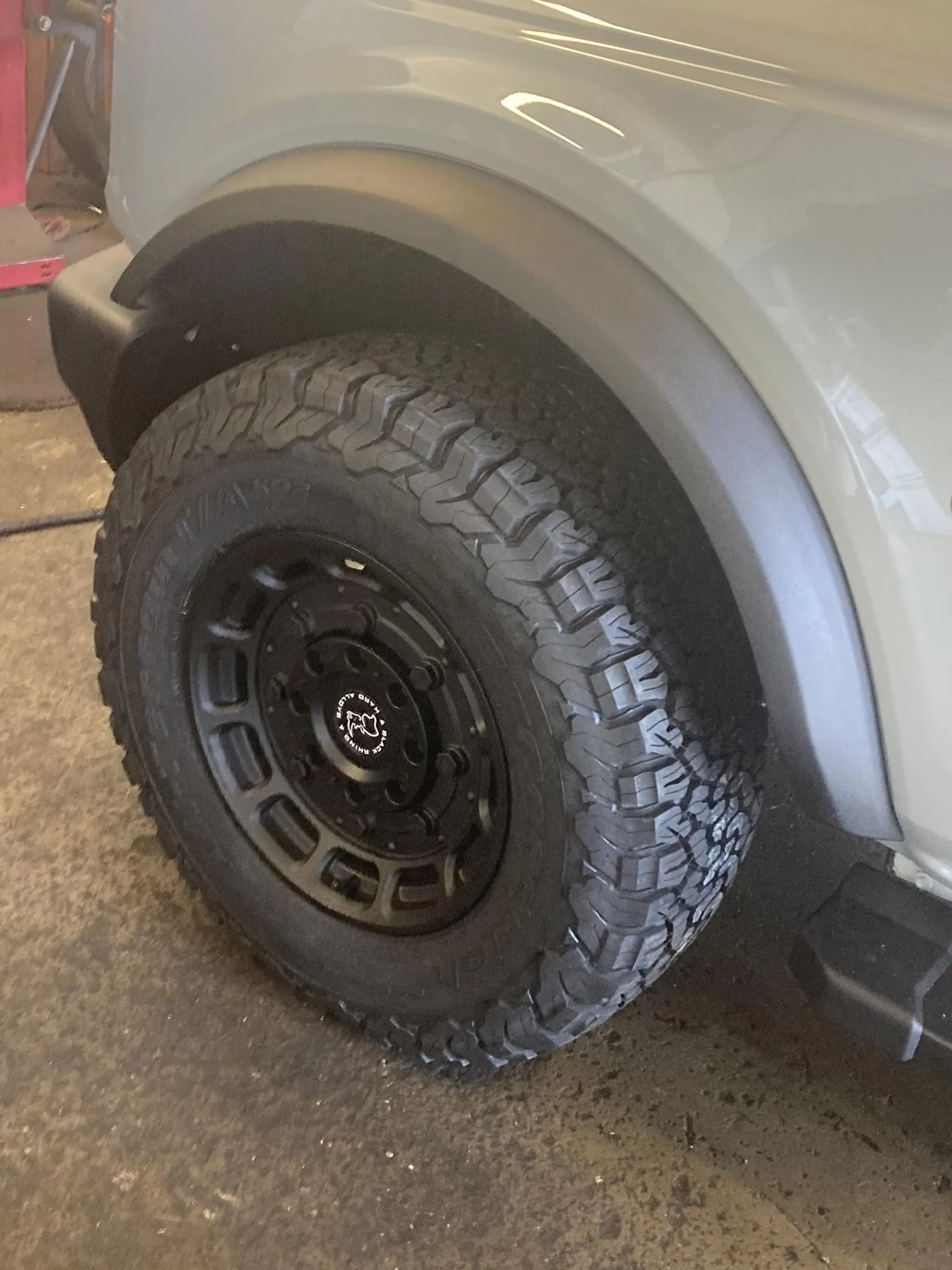

Here is poke with 0 offset and. 11.5 wide tire if it helps?

0 offset looks great. I went with 0 offset RTRs. RTRs are very light.
