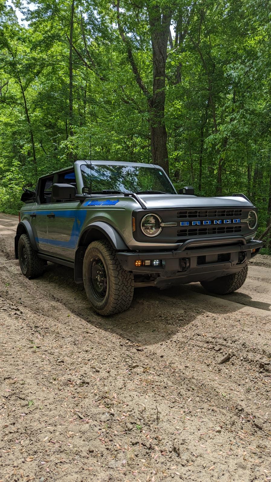

For those who have installed negative offset wheels on non sas models, I'm curious to know what mods you had to overcome. Examples I'm looking for are What rim width, tire size, lifts, crash bar removal, etc.... IM looking at -12 offset with either 33's or 35,s. Also curious if you have rubbing or bottoming out issues while offroading, with or without a lift. Driving on road without wheel rub is one thing, but I'm more curious about off road implications with suspension travel.

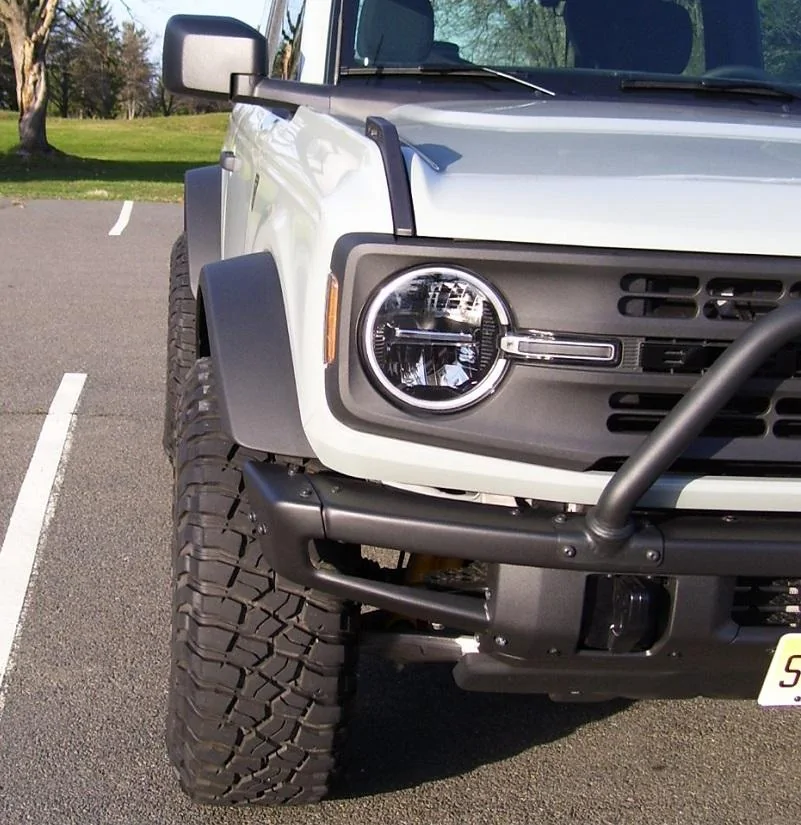

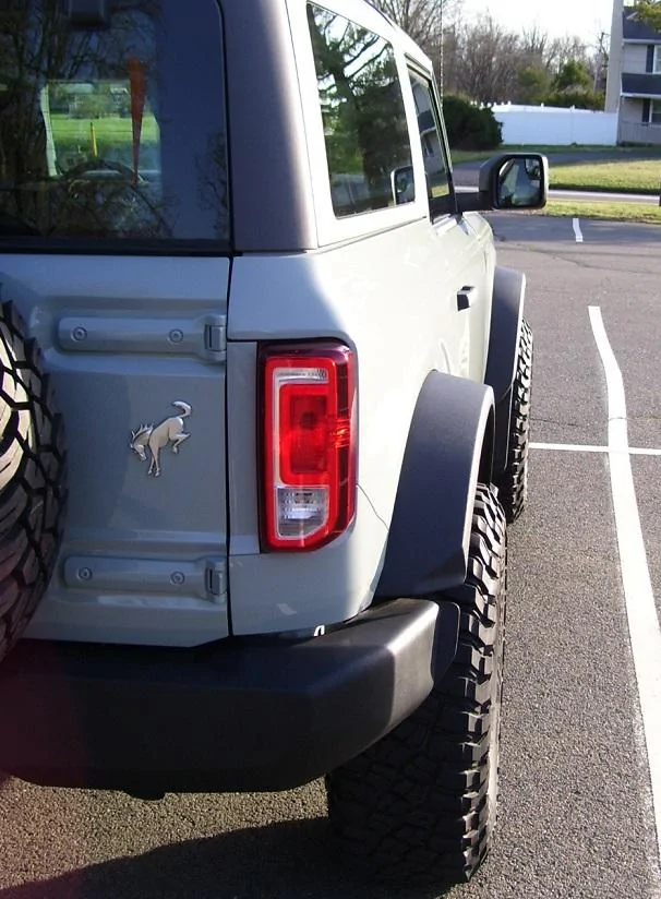

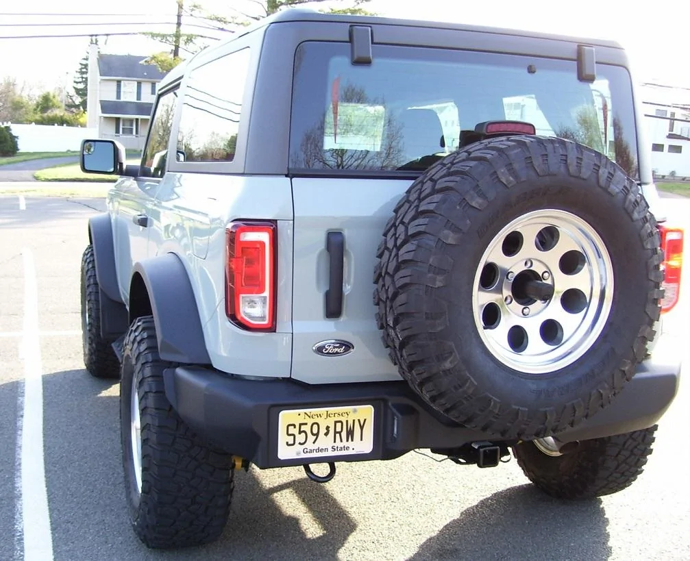

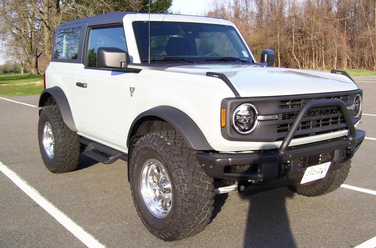

I have some 17x9 wheels with -6 offset and 35x12.5 tires. My truck is a SAS so the crash bars are not there. No rubbing on the normal parts, but the aftermarket mud flaps needed to be trimmed. You might want the SAS flares to help cover the tires since they will stick out around 1.5" more than stock.
