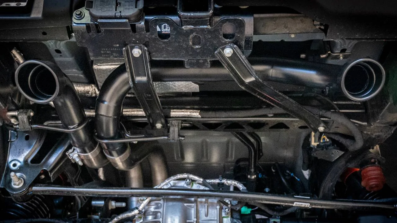

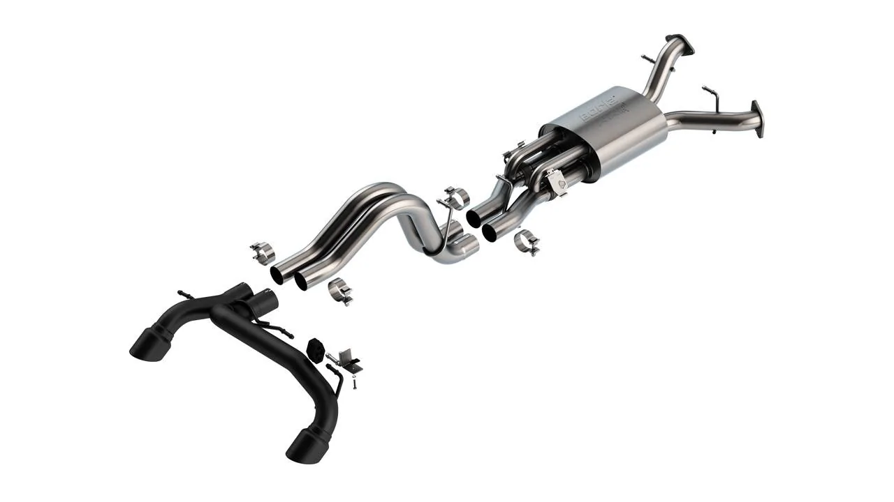

You still retain the Raptor active exhaust modes with the Borla system. It's mild in 'quiet' mode provided you keep your foot out of it.. It's Very high quality and a lifetime guarantee.
There's also a Borla dual same-side-exit tip set that is tucked up very, very high on the driver's side.
A few of us here have Borla systems and like them.. Mine is the dual, split black tip version.

And a good exhaust shop can fab just the right-side crossover pipe to attach to the stock system and dump it high on that side to mirror the left side if you don't want a full aftermarket system, there's plenty of room.

I have a Borla twin tip system on mine, the tips are tucked up pretty high, actually a little higher than is shown at the beginning of that video with the Bronco on the lift. Sometimes those vids are of pre-production items..

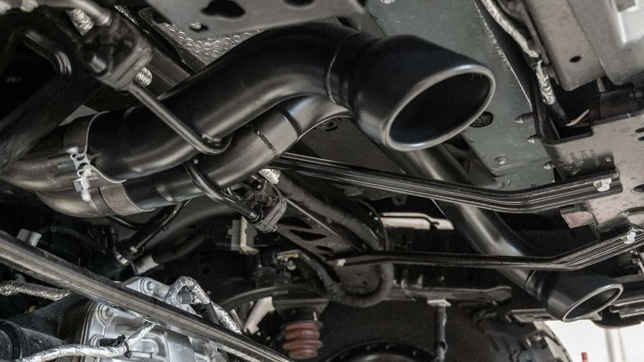

I also have the MBRP full CAT back with dual outlets. You can configure the exit pipes to your liking- I have mine stick out a bit with the 4" tips. But you can forgo the tips and have it further back- your choice. I like the full CAT back as it is 3" all the way until you get to the split 2.5" rear section. And it eliminates the huge canister stock exhaust in the back. It sounds real good to me without drone but sound is subjective. Install was super easy and no removal of the back bumper. I was hoping for better MPG- I got a .1 improvement so basically no improvement. So an exhaust system on the Bronco is more for sound than anything else
