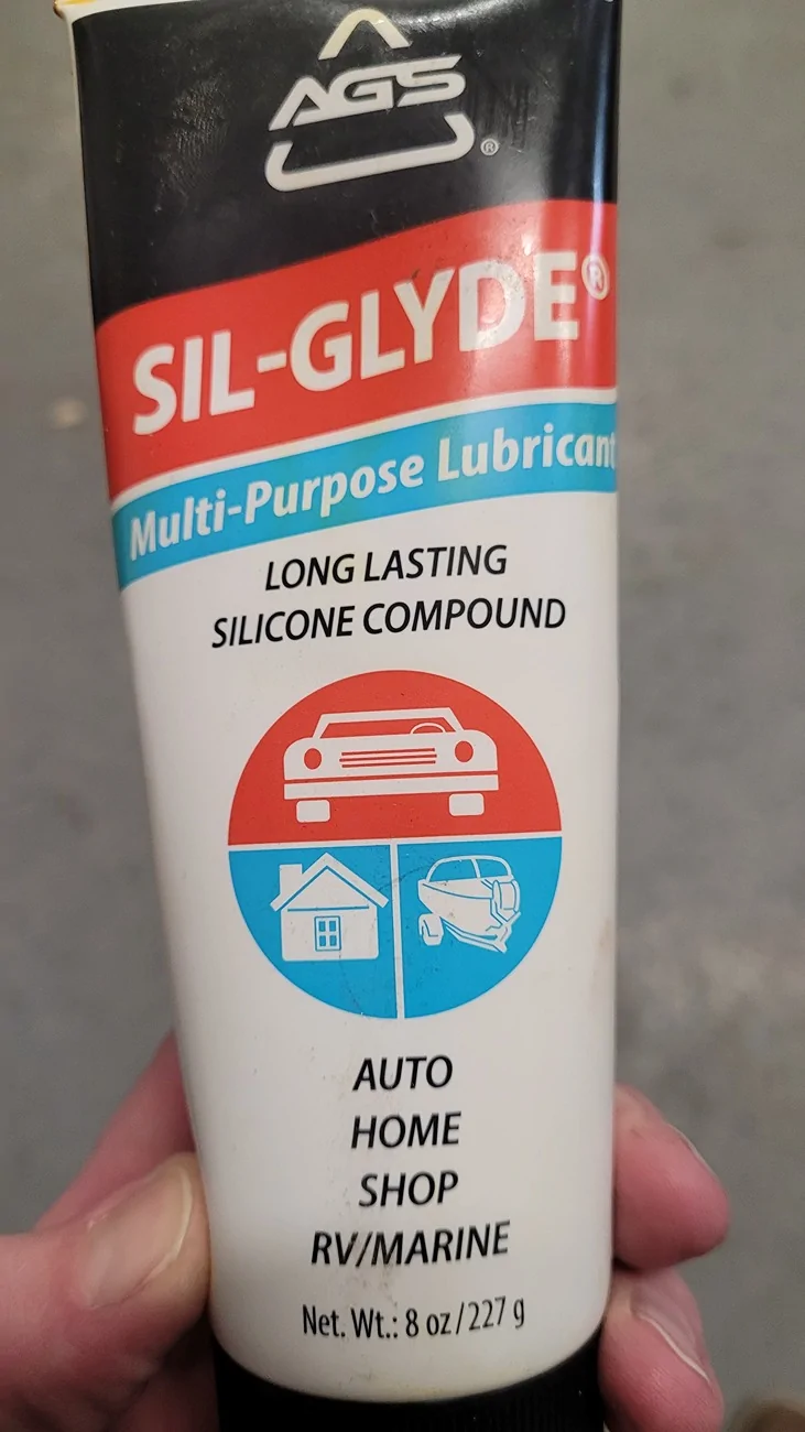

So i have a first edition without the nut serts are the c brace serts the only ones need to be installed for this to kit to work? From what i have read the b brace should fit all 2021 correct? Also i was going to use up what pass points i have so no out of pocket cost other than putting in the serts. My bronco makes all kinds of noise when it is super cold wondering if this helps with this.Thanks again

This is what i put on the seals but i mainly am asking how many nut serts i will need to put in only for the C- Brace or both braces
