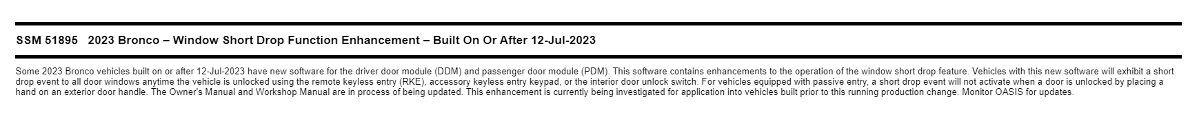

I got my 2022 BD four-door updated with this feature back in November. It was a DDM and PDM update and took just a few minutes at the dealership while I waited. It works great. DDM is drivers door module. PDM is passenger door module.

They don’t. I have a Feb 2023 car and it doesn’t have this. But to the point, it’s just an update to the DDM and PDM modules.
I visited my dealer yesterday to inquire. And while the SA didn’t really have any specific info, they suggested I make an appointment and state my windows are not working properly and a tech will look into it and likely update the modules. So that’s going to be my approach here.

Had success today at the dealer. You do have to carefully explain that this will be in their OASIS system as an update to the DDM (Driver Door Module) and PDM (Passenger Door Module) and that it is something you want, not something that will just pop up for them as a required update. To Blairwarlocks point, once the tech understood what I was looking for, he wrote it up as if I came in stating their was an issue with the windows so that he could have reason to reprogram the PDM and DDM.

The DDM and PDM module updates can only be done by Ford via OASIS; Forscan is not involved at all.
