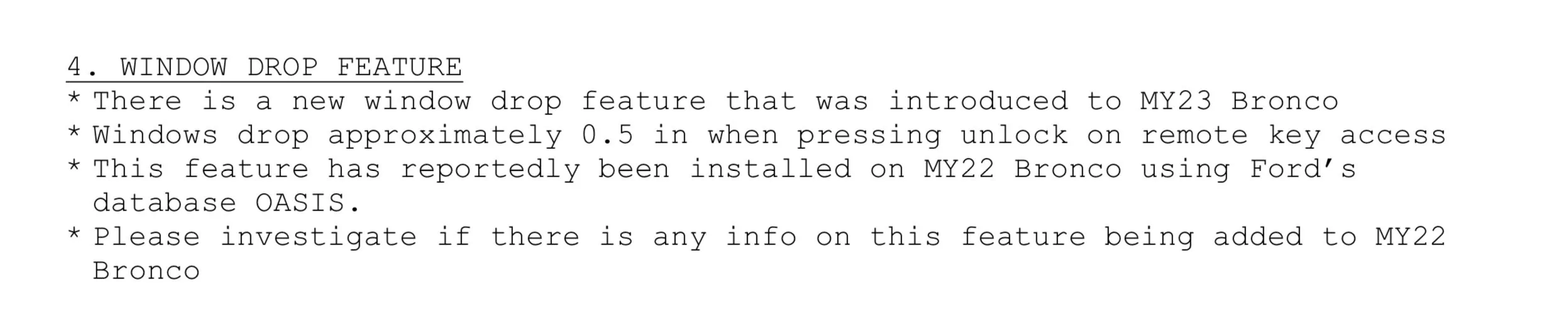

Here is what I told them:
Ford Bronco New 2023 window down feature? IMG_2237
So what do I ask the technician to do? Somehow I still think I’m going to get blank stares from the ford dealer.
