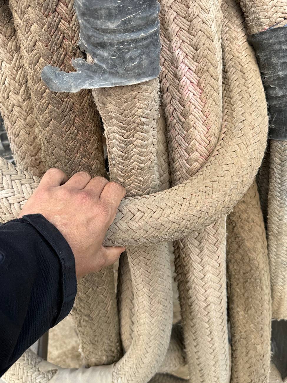

This might have been covered already, but make certain if going the kinetic route to size appropriately for your vehicle. If you use the one pictured here - someone is going to have a bad time. We use it for 80k-113k pound semis. Also you’ll need to resist the urge to keep making attempts and going harder each time. After the third attempt you need to let the rope rest for ~15 minutes to maintain the necessary stretch that pulls out vehicles and doesn’t rip bumpers off. If you keep going you turn it into a normal rope and…someone is going to have a bad time. Perhaps use that time to start shoveling.
Excellent advice. Every time you make a pull you heat the rope, friction. It needs time to cool off.
