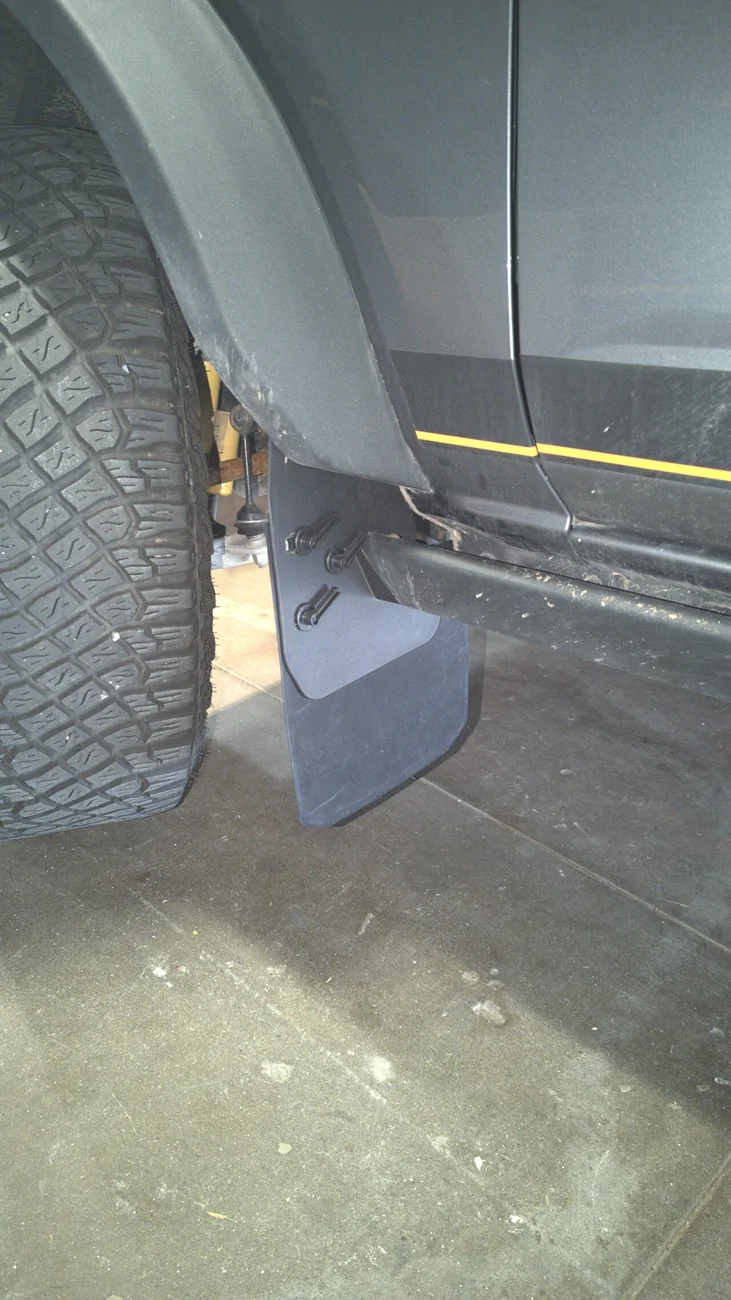

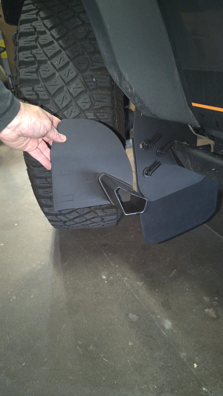

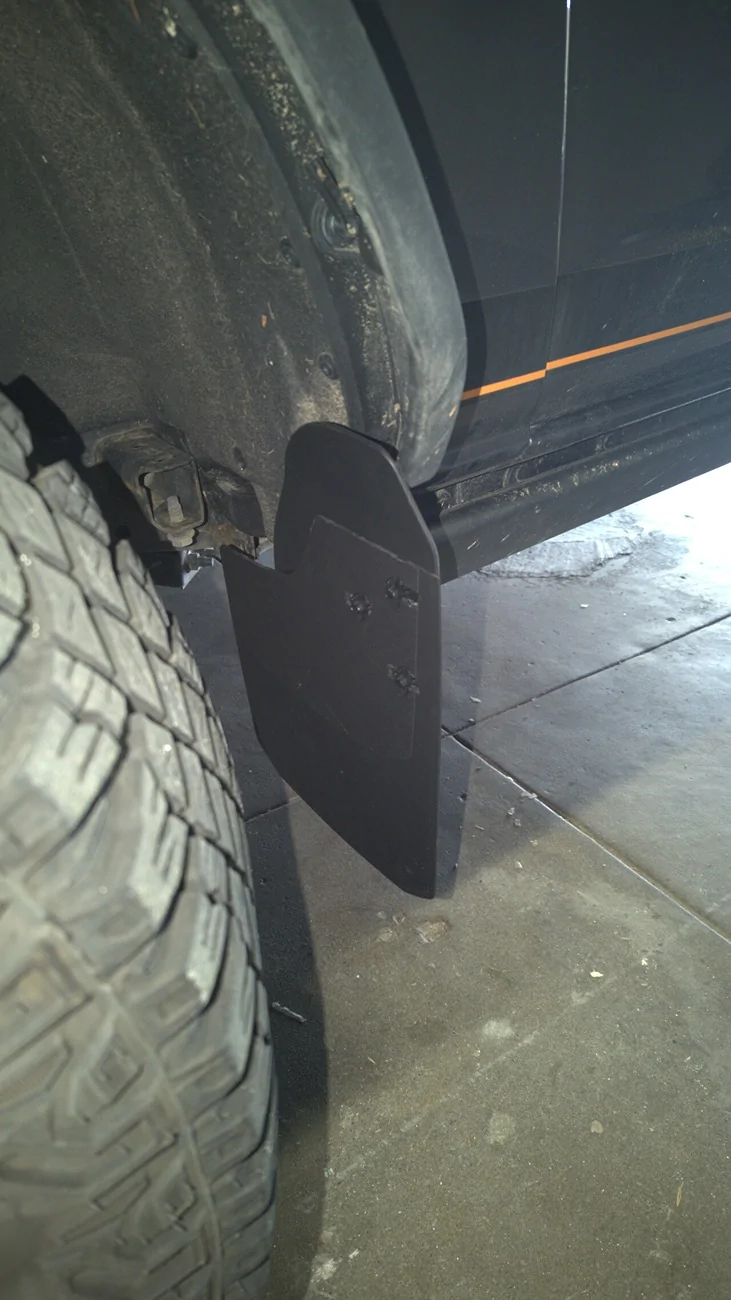

I wanted something low profile, no drill and removable, so my recipe is:
A set of the IAG I-Line 2pc Rock Rail Side Mini Mud Flaps
Six of the HM1 fender flare clips
A pair of Powerflow Splash Guard 4322, or any flat, non-molded generic mud flap
A bit of dremel work to cut the slots for the clips in both sets of flaps
A quick slice to trim the bottom of the IAG flap flush to the rock slider
A quick slice to trim the top of the powerflow flap to fit onto the IAG flap.
Install the IAG flap to the slider, attach the generic flap to the IAG with the flare clips....
Enjoy not having mud, crud and rocks flung all over the side of your rig, and easily pull them off when necessary.
The only thing I'd really like is to have something to cover the front side of the clips to keep them from retaining too much gunk, but going on nine months that hasn't been a huge issue. This winter will be the real test.....
