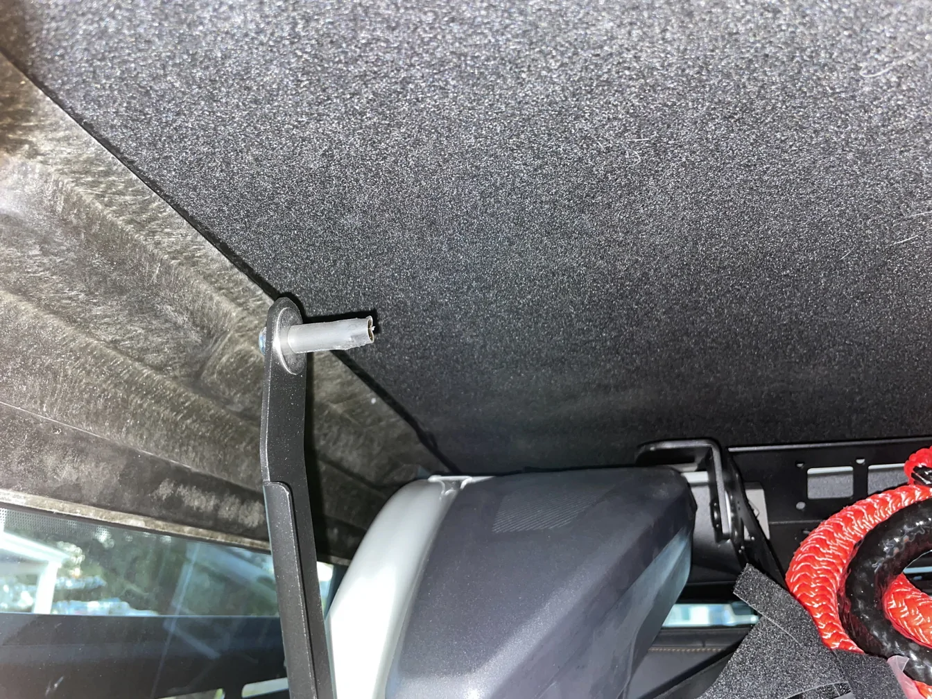

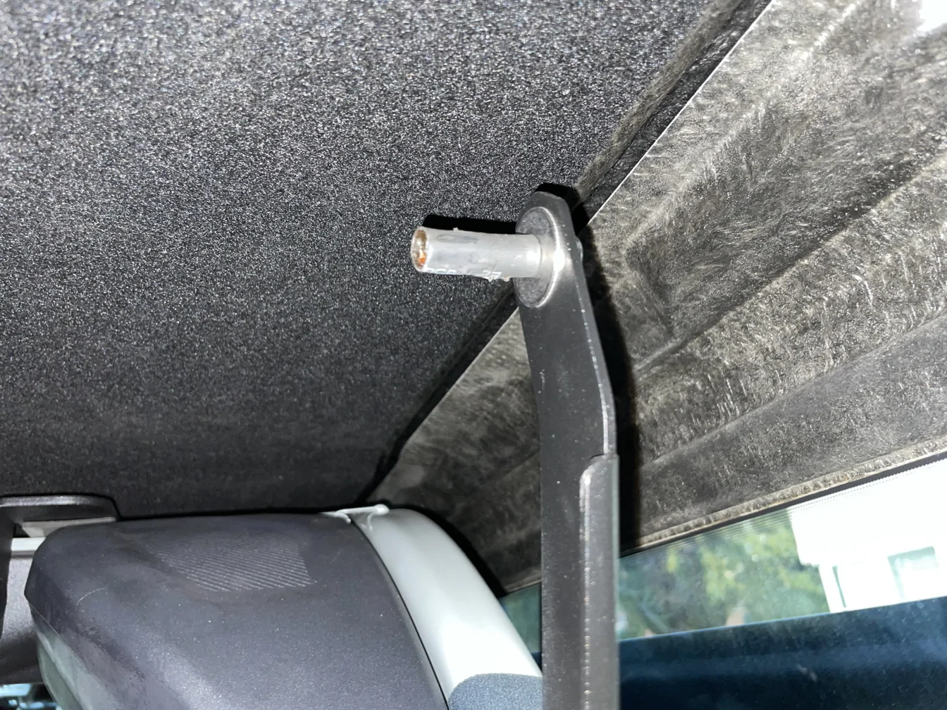

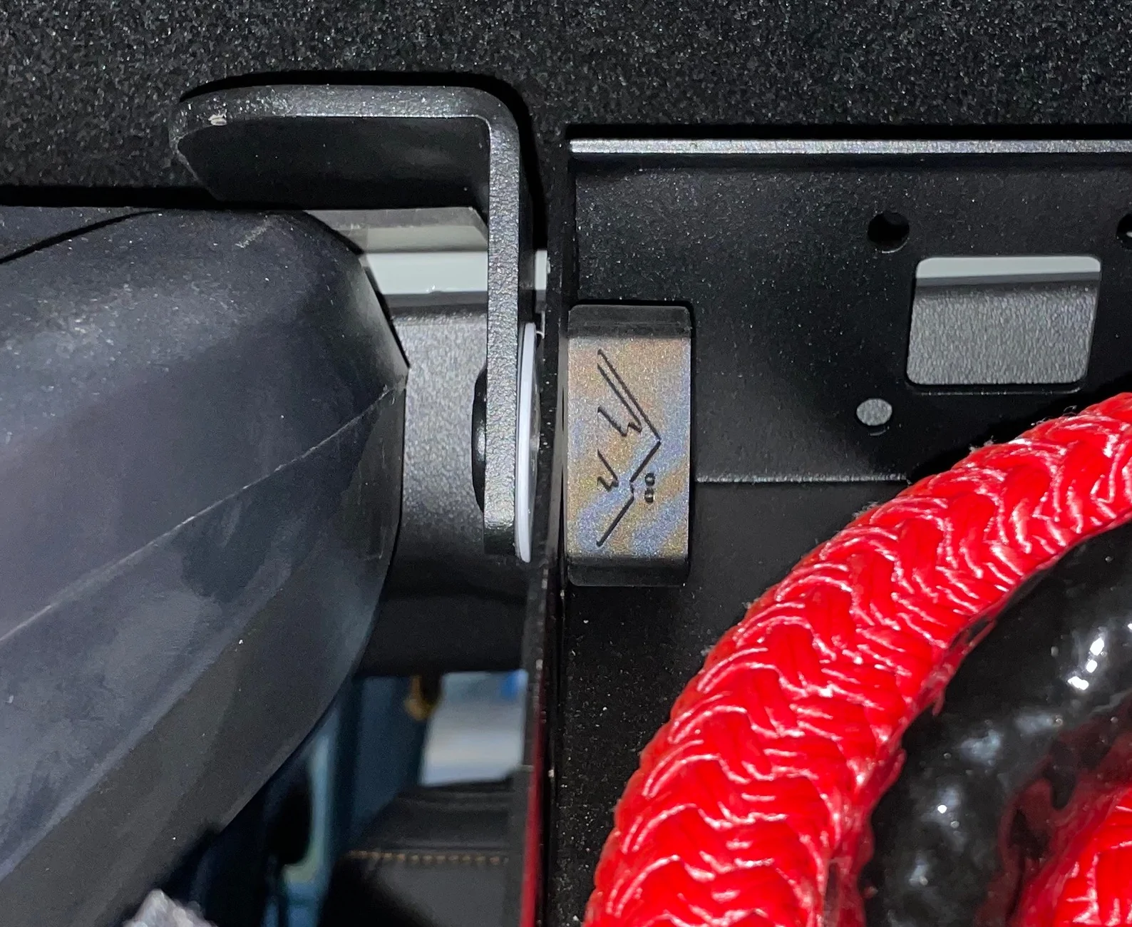

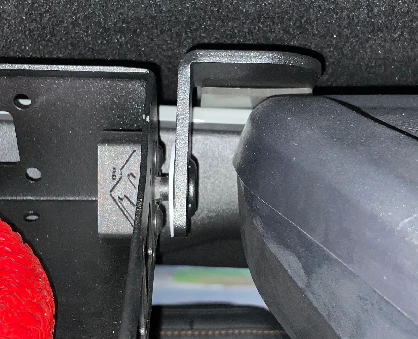

I have the drop down attic shelf, it doesn't rattle. Here's what I did.
I slipped Harbor Freight Marine Grade shrink tubing over the latch pins. There's no need to shrink it.
The Mounts2Metal instructions tell you how to get rid of slack at the hinge pins. I did a little extra. I bought teflon washers from McMaster-Car to eliminate all slack at the hinge pins.
https://www.mcmaster.com/95630A487/

My old M2M cargo shelf rattled as well. I found it all came from the latch point as calvin pointed out. An alternative is to add weight to the shelf by having gear on it.

Mine rattles here and then so i wrapped the pins with electrical tape. It seems to have helped. I may have try what Calvin did next.

I wrapped the pins in cloth electrical tape

The heat shrink on the latch pins works great. 👍
But there must be a variance between the 2-dr and 4-dr versions. Your washer recommendation on the pivot pin doesn't fit for the 2-dr version - like not even close. While I had it apart, I had to improvise with what I had on hand. Ended up using some spare garden hose washers. Loose, but the purpose is to take up some of the lateral slack so that when the inevitable shift happens that the tray doesn't rub on the bracket.

I believe I have figured things out. Time will tell... The rattle was solved with nylon washers at the pivot and a combination of heat shrink and slightly thicker nylon washers at the release. I had a squeak that was driving me nuts that turned out to be at the release. I solved that by retightening the mechanism bolts and lightening the load in the shelf. I used to keep my recovery strap and shackles up there (40 lbs?) and now have only lighter things (extra clothing, ground cloths, etc) there.

Thanks for the suggestion CT.
How many washers, one for each side ?
TIA

One for each side, then get rid of slack by adjusting the hinge brackets.
