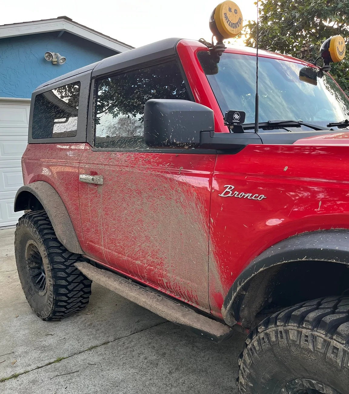

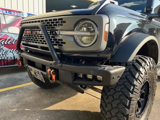

Thanks, but aren't those the factory rock rails with an aftermarket step added to them? If so, I think they would have moved up with the body. I was hoping for a picture with actual frame mounted steps.

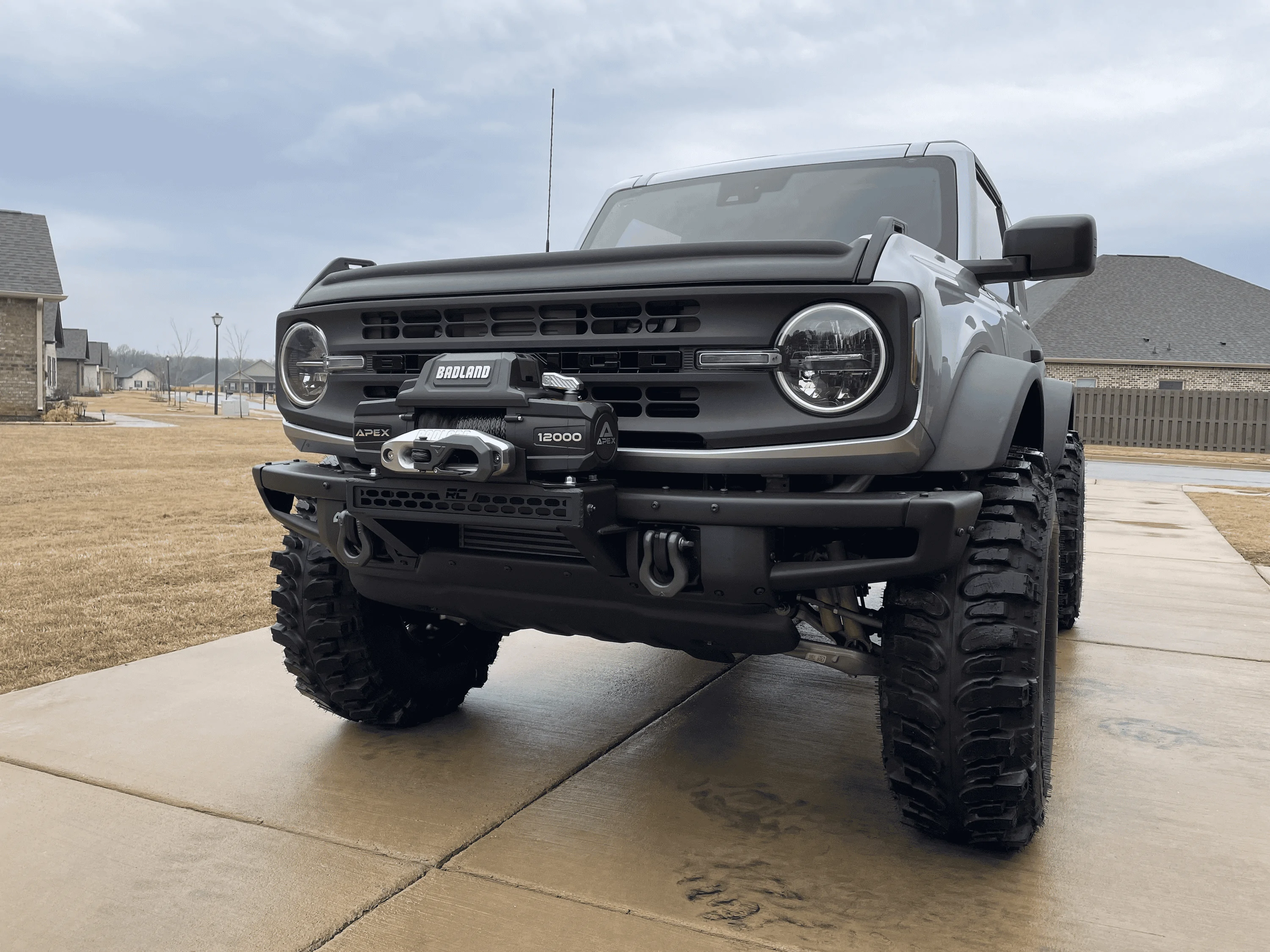

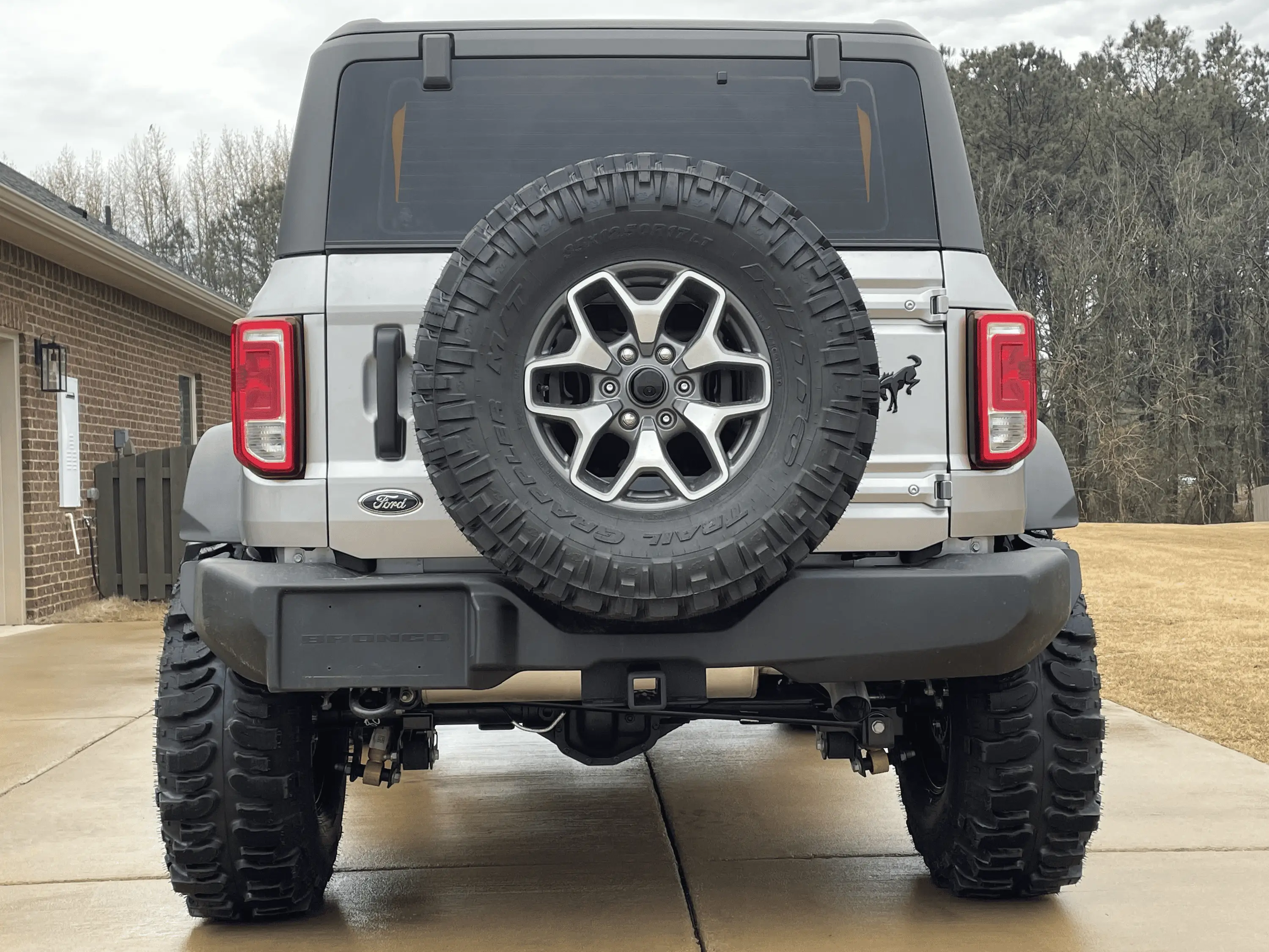

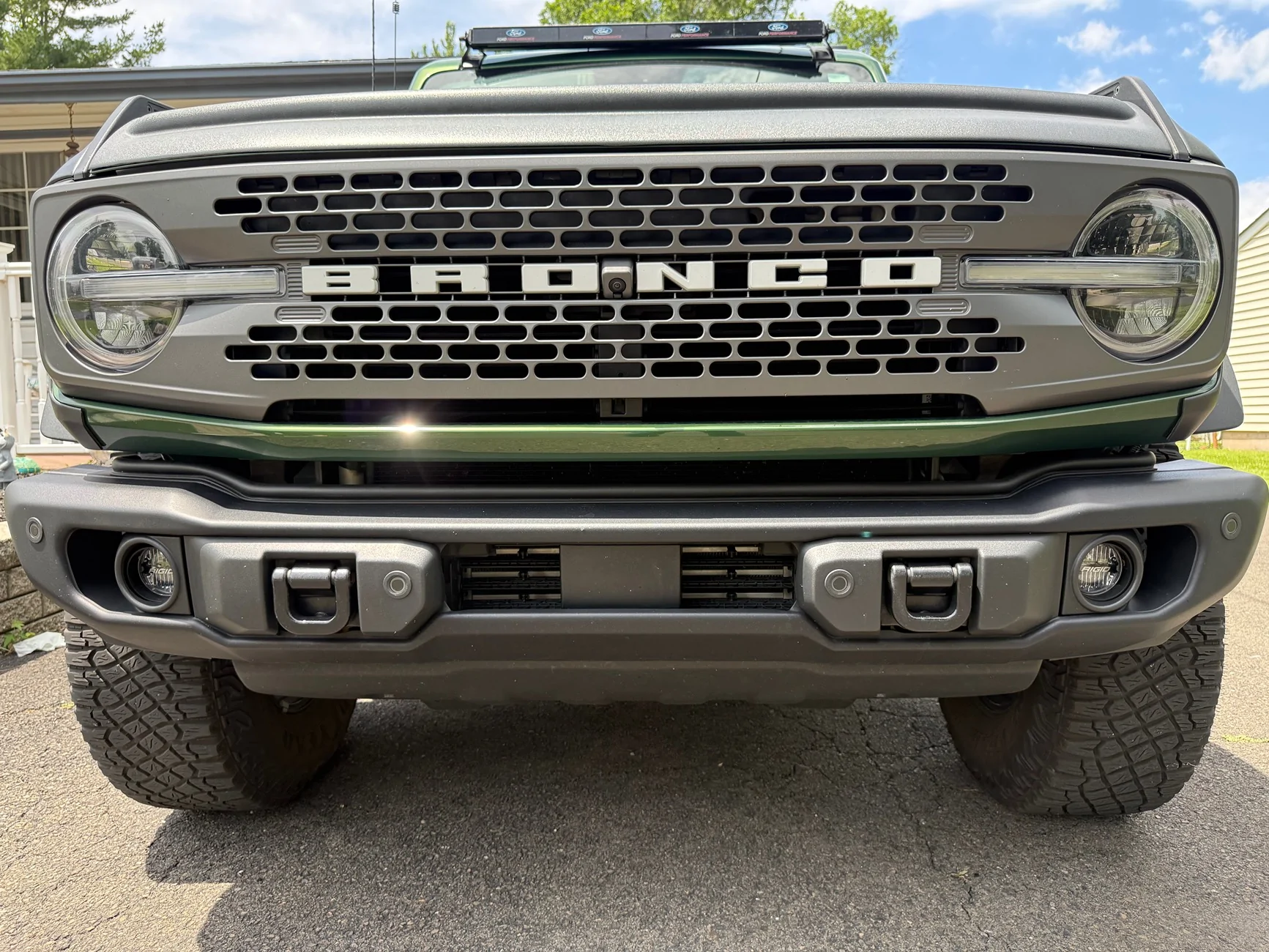

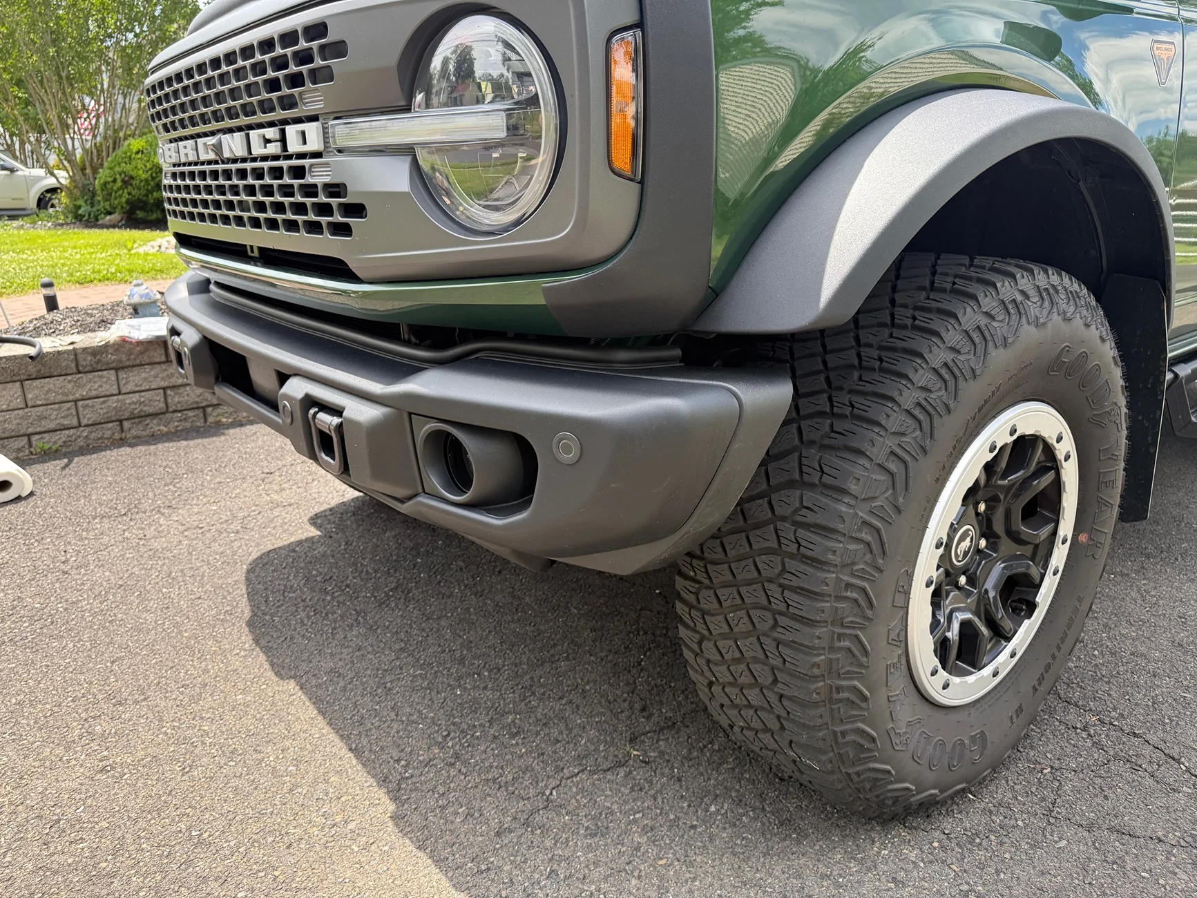

*Update* Body lift came in, great quality and quick shipping. My fear was the gap which is why I only went with a 1/2" lift. I am not thrilled with the gap, I really didn't think it would be that noticible but to me it is. Since it is on I won't take it off but need to figure out something that can be installed behind it to cover up the gap/wiring that is showing for my LED's and other things. Back is "ok" but the front to me is too big of a gap.
Just a few up close pix if anyone is on the fence like I was. I wouldn't do it again but that's just my opinion, lesson learned.

Old school fix is to run black weather stripping from the body in the gap. You set it back as far as you can. I have not done it to a Bronco yet, but have a 3/4 kit I am scheduled to install. I’ll have a better feel to placement after that.

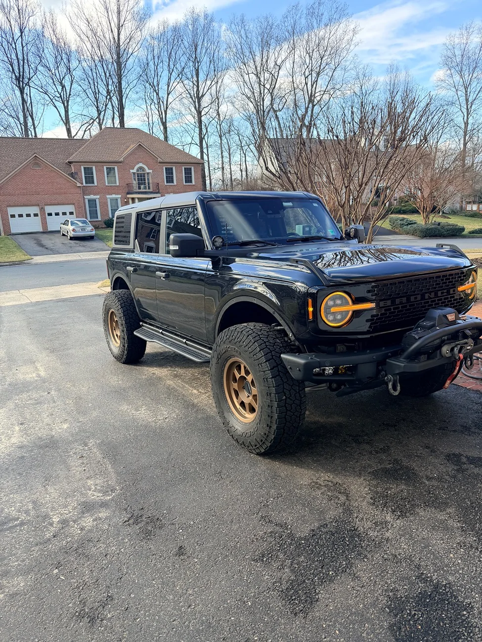

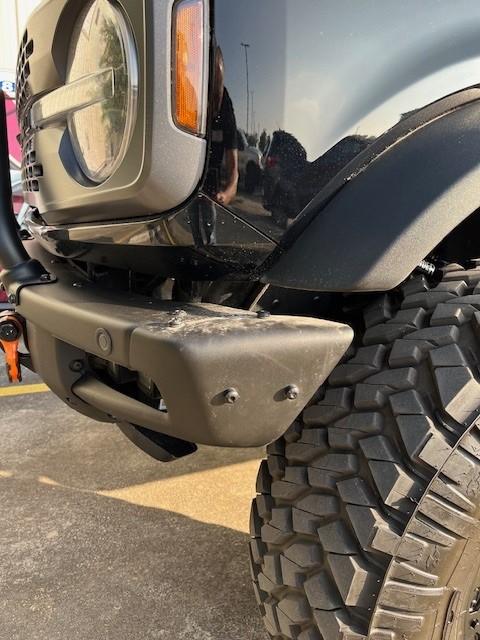

I would love to seem some photos of Broncos with frame mounted rock sliders and the body lifts 1/2 to 3/4" please.
my JCR frame mounted slider/steps with 3/4” body lift
Ford Bronco Mikellis Body Lifts IMG_1332
sorry no good photos…

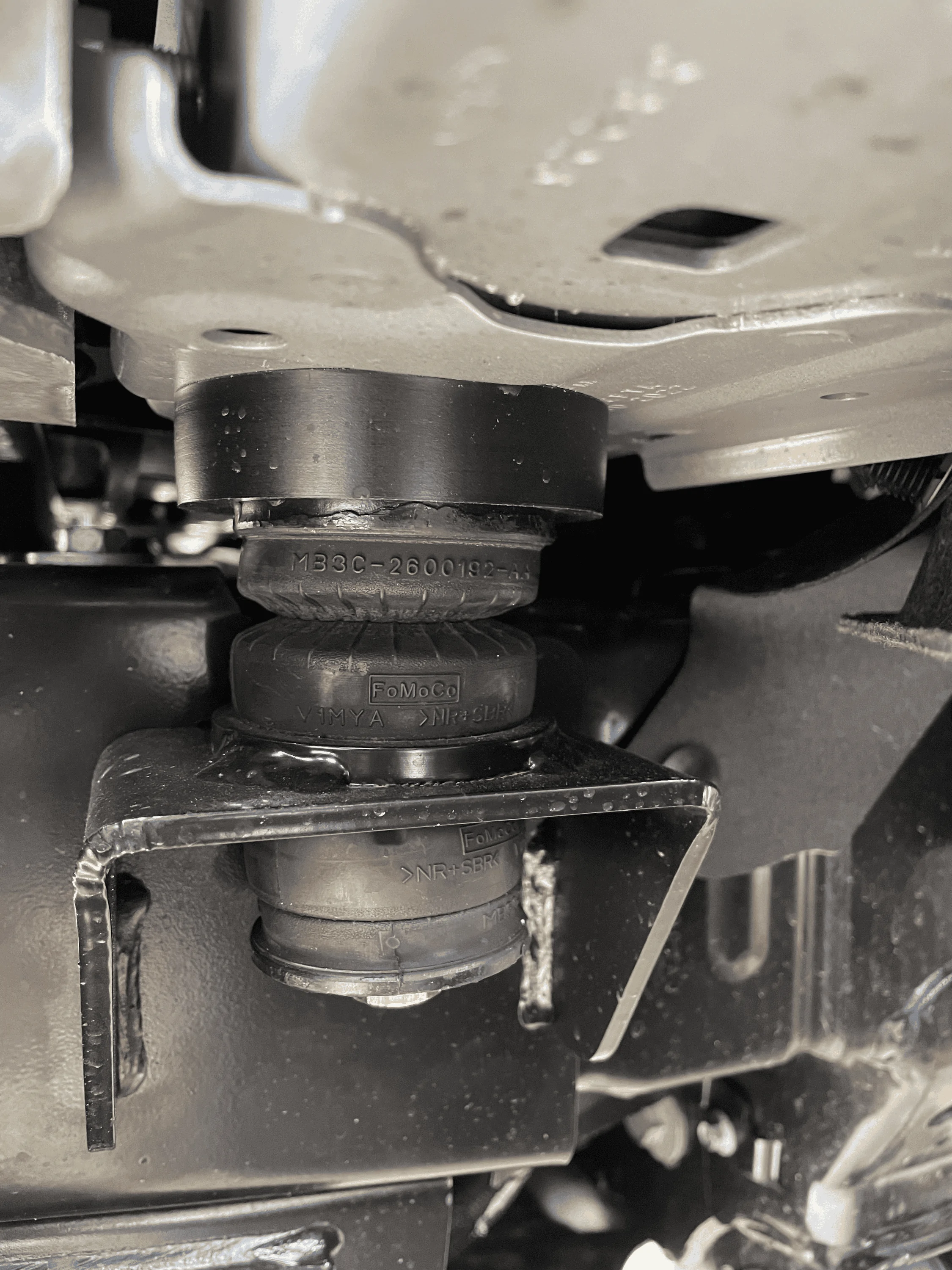

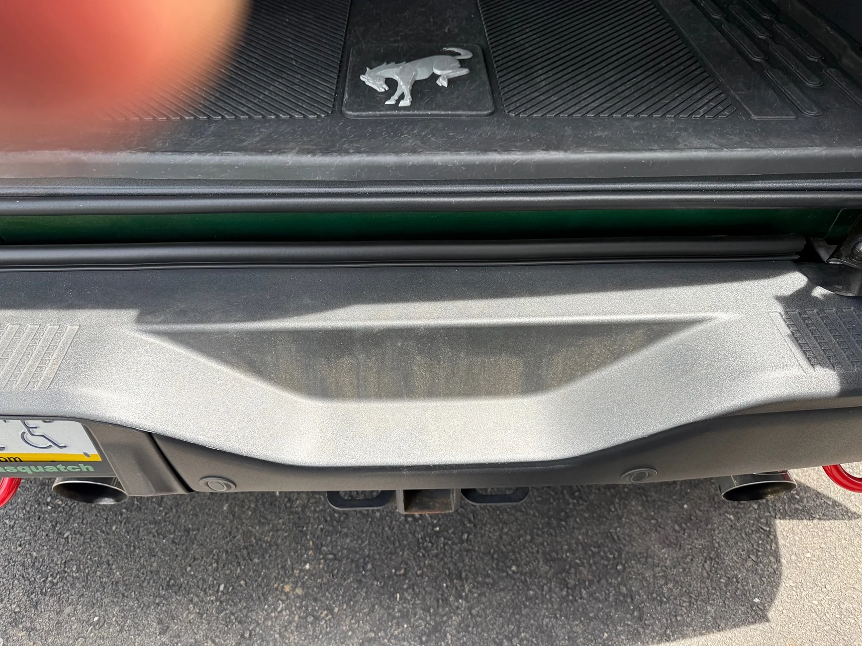

I ran the 3/4 with the two new front bolts and reused the rest of the stock bolts with blue loctite. Both body bolts behind the doors on my 23 two door had rust on the threads that made it tough to get out. Wire wheeled them before reinstalling. I added 3/4 inch weather stripping to the top of the bumpers to fill the gap.

When I replaced the front mid bolts (under the footwells, not the front 2 by the intercooler) for my 3/4" lift - I used m12x1.75 150mm.
That length worked for the lift puck and a frame mount for my RSEs, but the stock bolt was just a hair too short.
