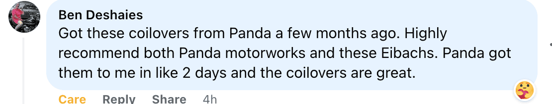

I would recommend Eibachs. In my opinion the best bang-for-buck coilovers out there. We have a bunch of these in stock and trying to clear out some inventory, so i'm doing an awesome deal on these, lowest price you'll find. Id be happy to hook you up!
Eibach 2021+ Ford Bronco Pro-Truck Coilover 2.0 Front & Rear
Ford Bronco Recommendations for lifts Screen Shot 2023-03-09 at 12.19.01 PM
