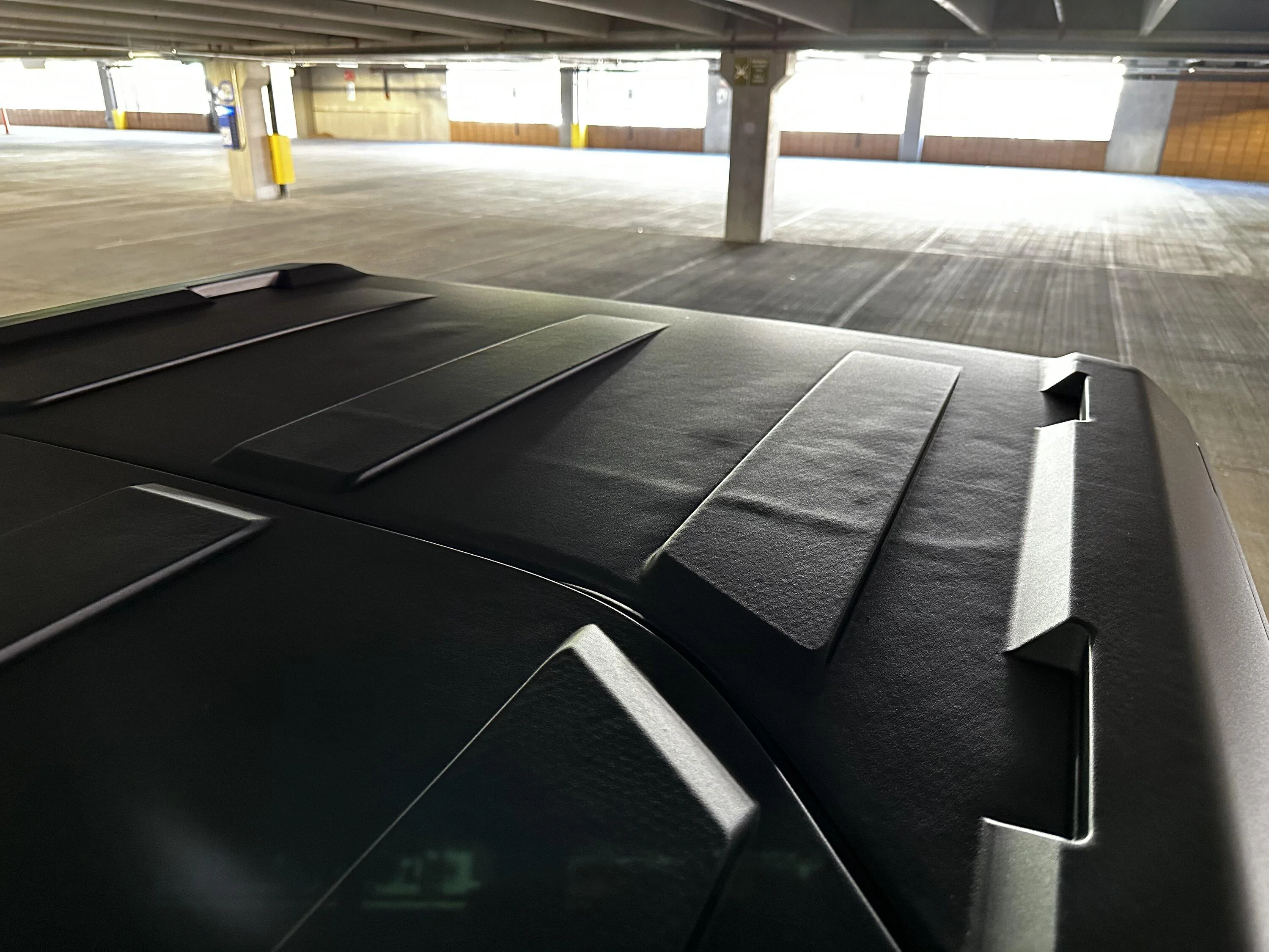

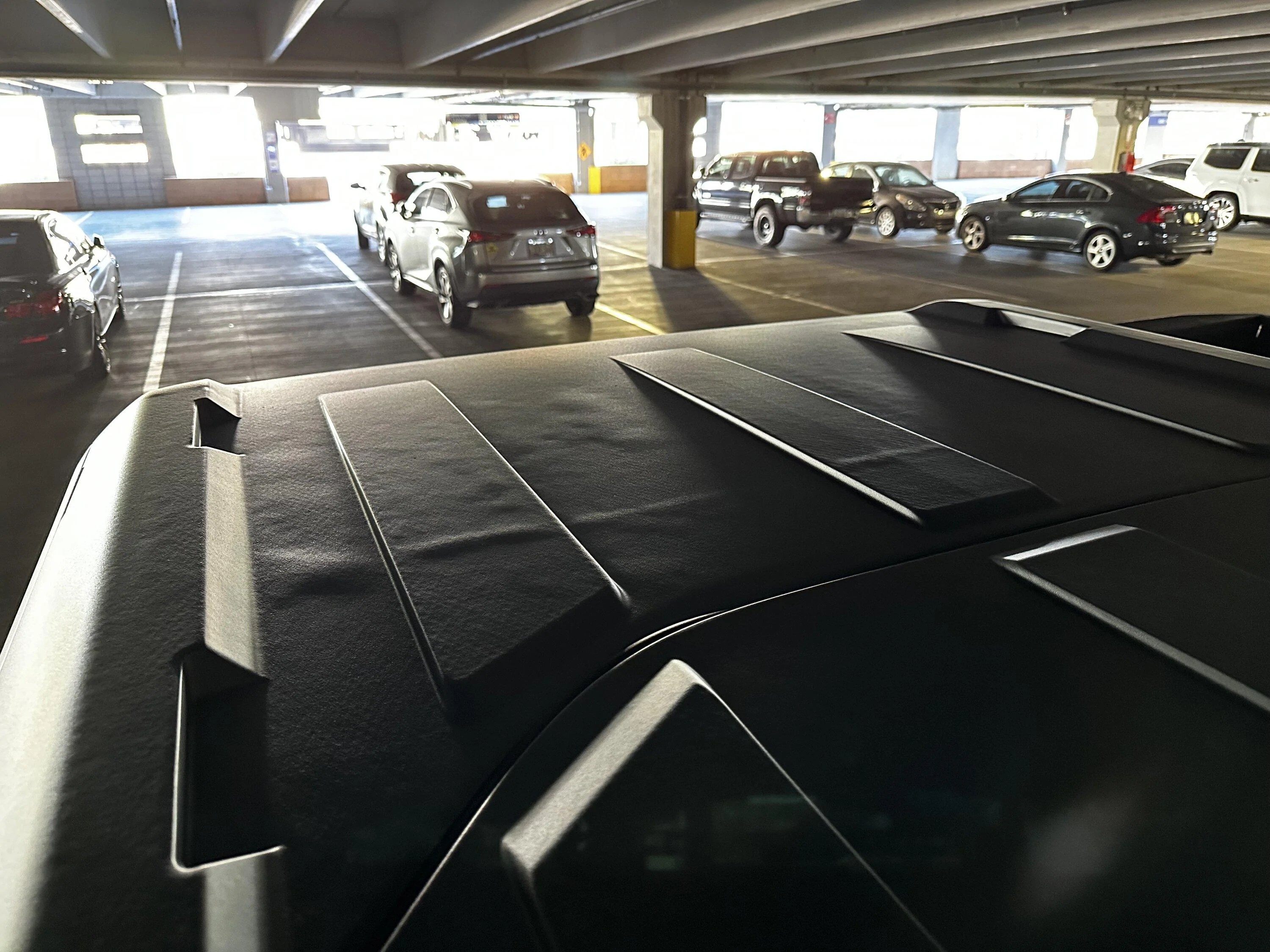

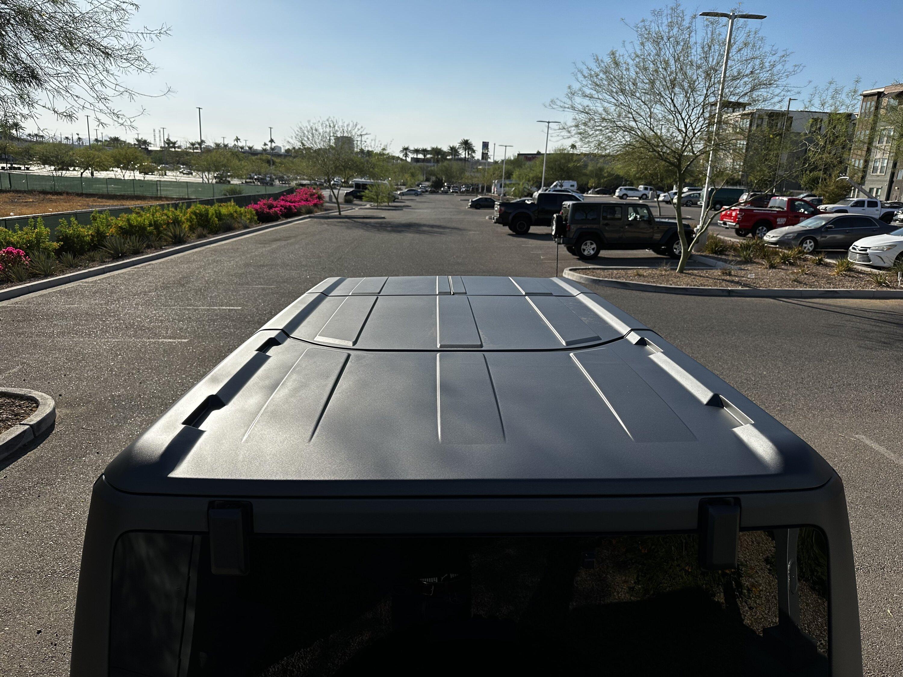

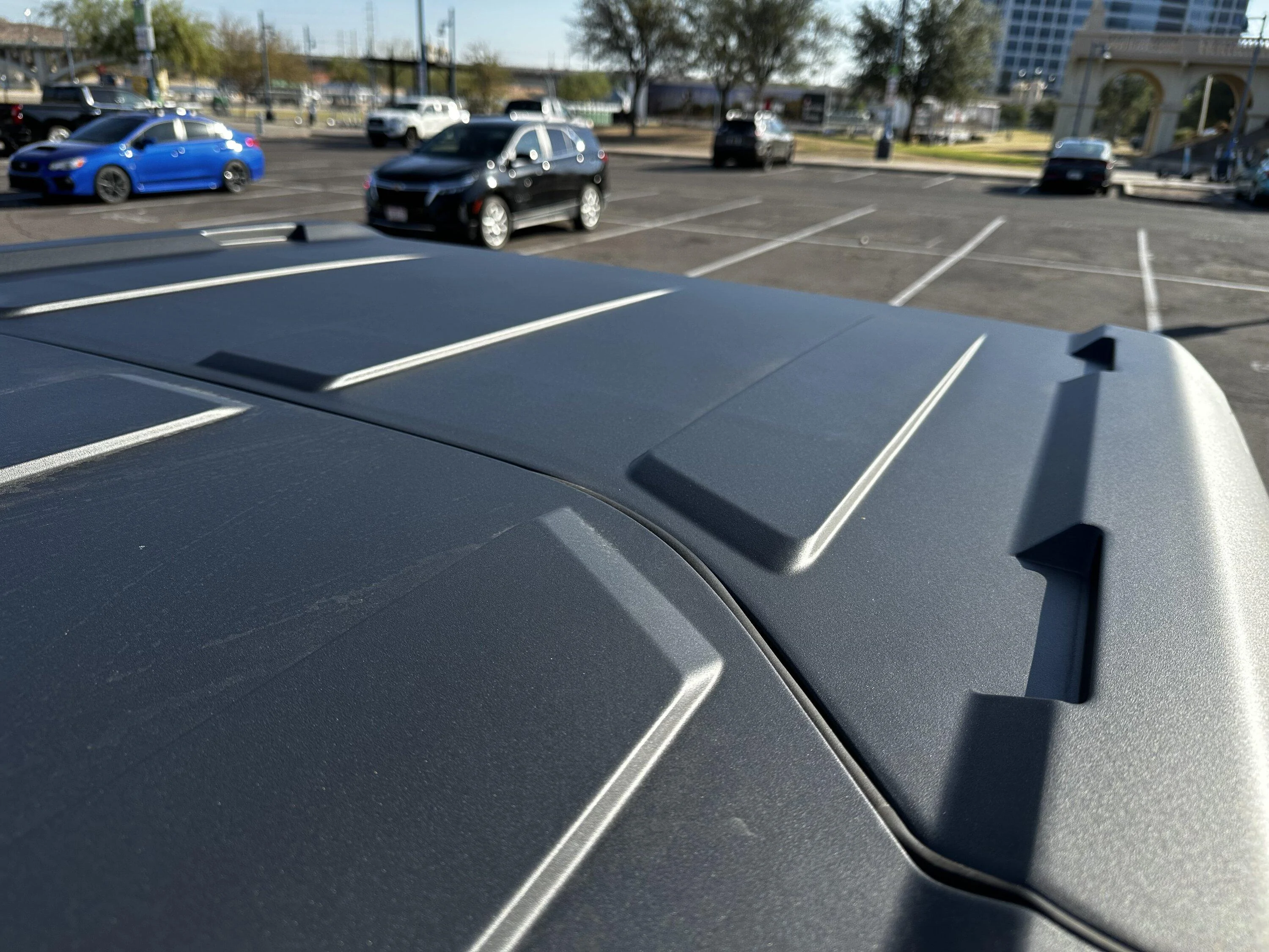

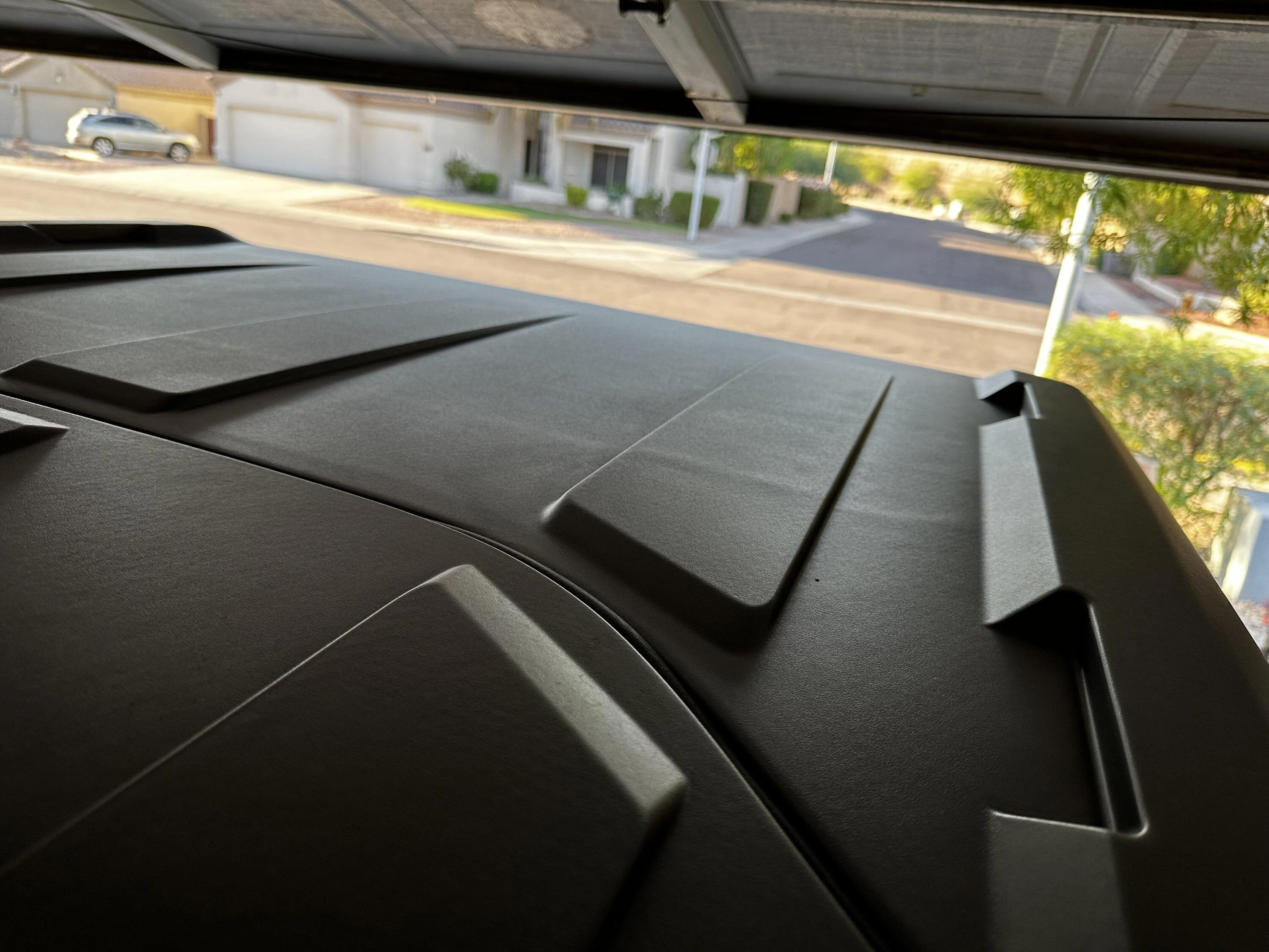

I’m on my 4th top now (3rd replacement). Been taking it back in for cracks and finally got a crack free one. Now my 4th top seems to be delaminating. See photos. If you don’t inspect these tops in different lighting conditions they appear just fine. In the dark with a flashlight you can see the cracks. In a perfect mix of shade/dark with some natural light coming in (like your home garage or a parking garage) you see all the delaminating. In direct sunlight all defects are masked and the top appears fine.
I’m going to bet there are a lot of bad tops out there that haven’t been identified yet because they haven’t been seen in the right lighting. For delam, the best lighting is in a parking garage with some natural light coming in like in my photos. All other lighting conditions and my top seems just fine / damn perfect. This is a mind fuck game and I just want to stop losing sleep over these damn tops being bad.

That is interesting. I am wondering what is causing the wave condition. It seems as if the outer material is coming loose.

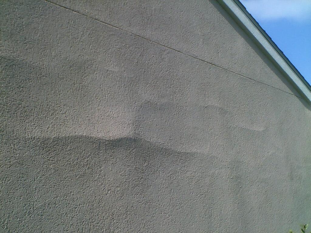

Kinda like this. Like on a home, water will win!

Exactly my concern with these cracks, etc....it's honeycomb cardboard underneath. We all should know what happens to cardboard when it gets wet.
