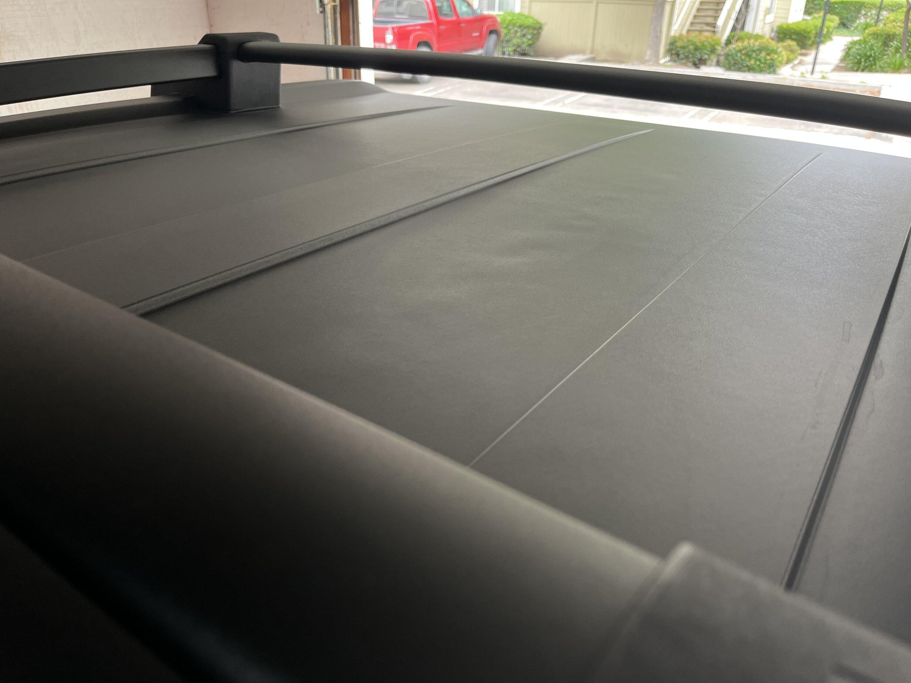

I’m going to take mine in and see what they say/do.
I wouldn't.... At least not right now. That is barely noticeable and itnis a flip of a coin as to if the replacement is better or worse.
If you mic doesn't leak and is all the same color... Keep it as long as you can :)
I agree with this, if that is all you have and there are no cracks, I wouldn’t change it.
Im in the same boat, some waves but I’m crack free and I’m hoping it stays that way.

Thanks OP for posting this. I have the exact same issue with my top on the clamshell. Only in a couple of small areas so far, but noticed it first day I brought it home. Firm believer in many times the cure is worse than the cause, (otherwise the top fits fine and is reasonably quiet), so going to live with it as long as it doesn’t get worse.
Ford Bronco MIC Hardtop Delamination Issue now covered in General Service Bulletin -- Bronco Roof Concern Analysis  -- 9/27/23 Update IMG_7112
I have seen this same delamination pattern on multiple tops. I’m on my 3rd replacement top for cracking. Now I need to keep an eye out for delamination. There is a high risk that your new top will be worse than your current top, so keep that in mind. At the end of the day, I think we will all lose out with these tops.

Just an FYI, Ford has updated the GSB about Bronco roof concerns to include delamination issues.
General Service Bulletin Download[PDF]:
https://www.bronco6g.com/forum/attachments/bronco-roof-concern-analysis-pdf.569300/
Delamination of hard top outer layer (Warrantable)
• Raised patches on the hard top with no distorted grain pattern or discoloration (Figures 16-17)
Figure 16
Ford Bronco {thread} {filename}
Figure 17
Edit: I've also attached the whole GSB just incase anyone wants to see what is and is not warrantable according to Ford.
