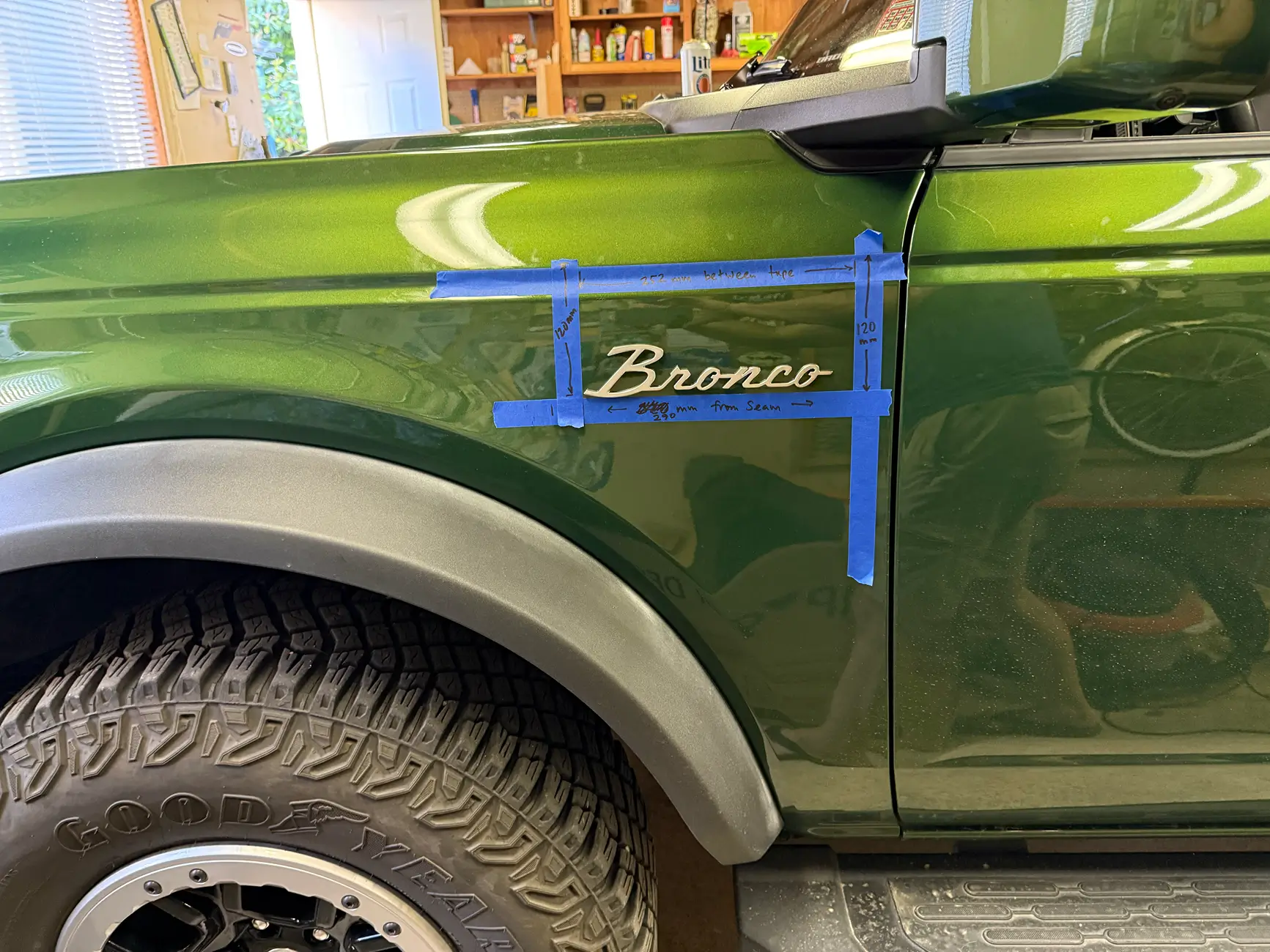

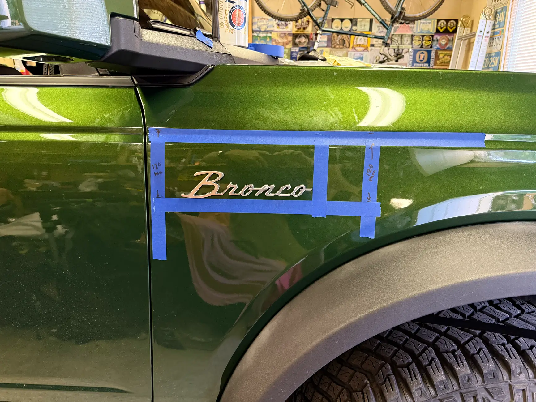

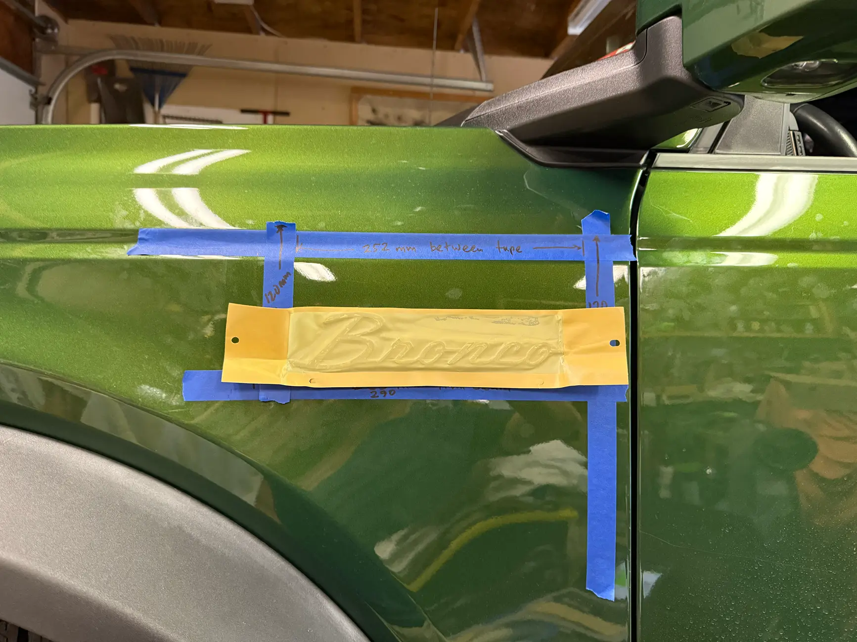

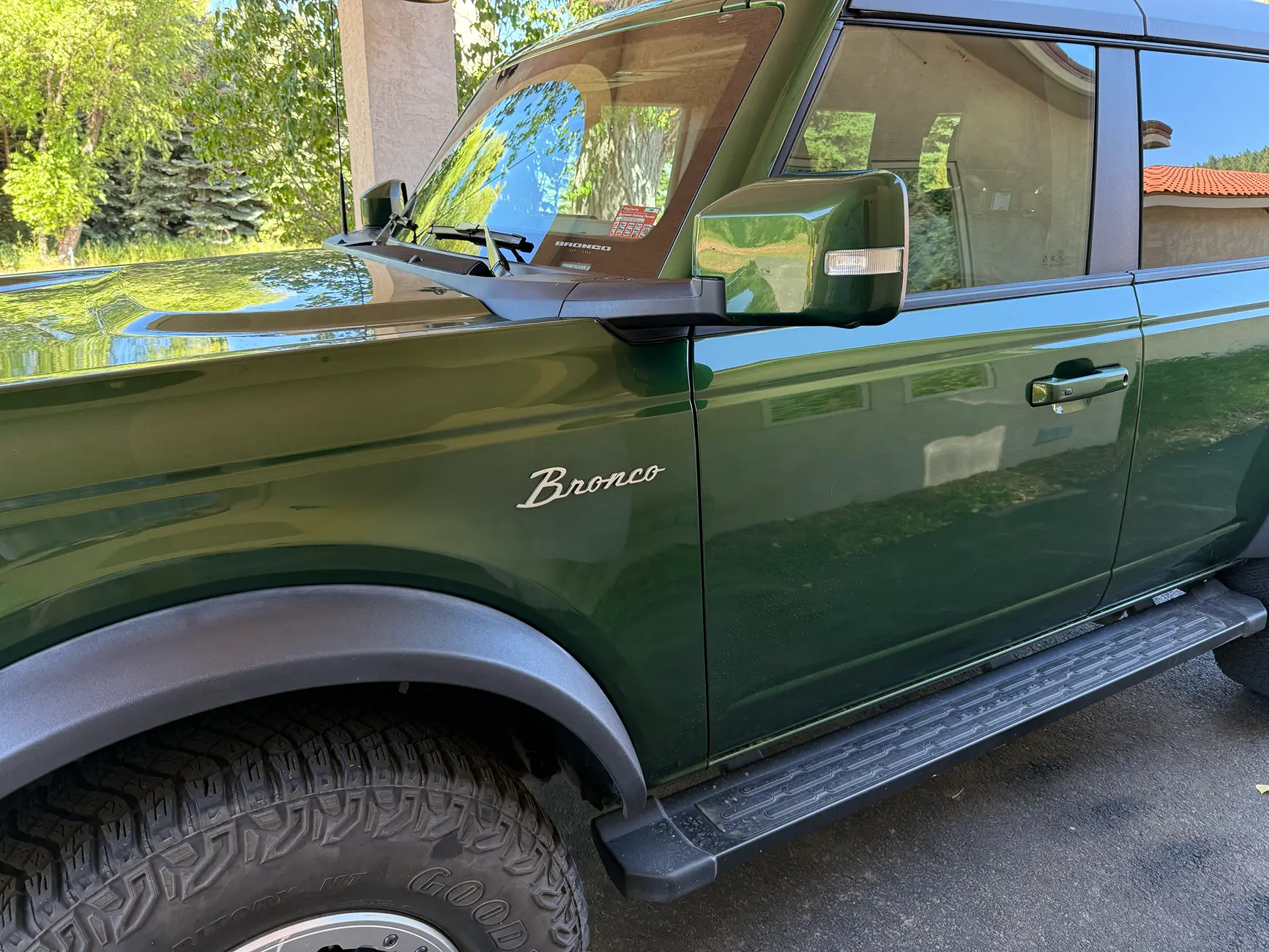

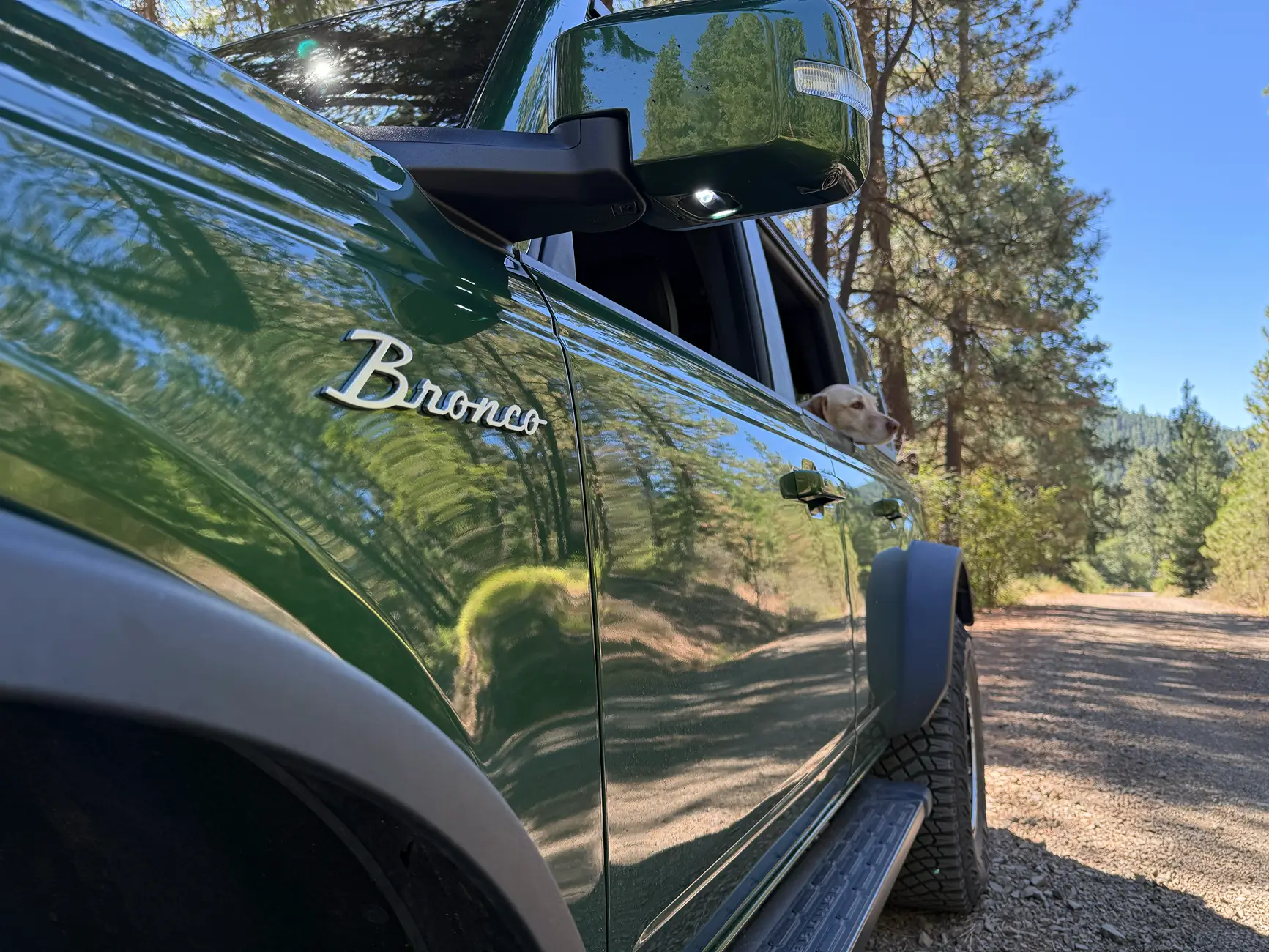

Update!
I went so far as to make the LH printable template, exactly to specs that I reverse engineered from the digital photo mockups I'd made. Printed it out, did the cutout, taped it up, and was sitting there looking at that precise little hole in the paper when I wondered to myself...
How the hell am I going to avoid accidentally catching the edge of the paper on the backing glue of the emblem??
I thought it through for a few minutes, then switched to a new plan B:
Create reference lines with painter's tape, using body features and offset measurements, triple check the measurements with a ruler, then use eyeballs and slow, steady hands to seat the emblem on the paint.
... which is pretty much what @MD24Bronco2.3 and @crenca said they did. I reached the same answer eventually, I just had to go the long way to get there. :LOL:
Here are a few pics. Thanks for the feedback as I worked through it.
NB: The template says 2.50" forward of the door seam, but I ended up shortening that a bit after I dry fit it. I thought it looked too far forward. So I used the eyeball test and settled on a location I thought looked right, then replicated that on the other side.

Looks like it should have come like that! The various OEM stickers just don't do it for me.
