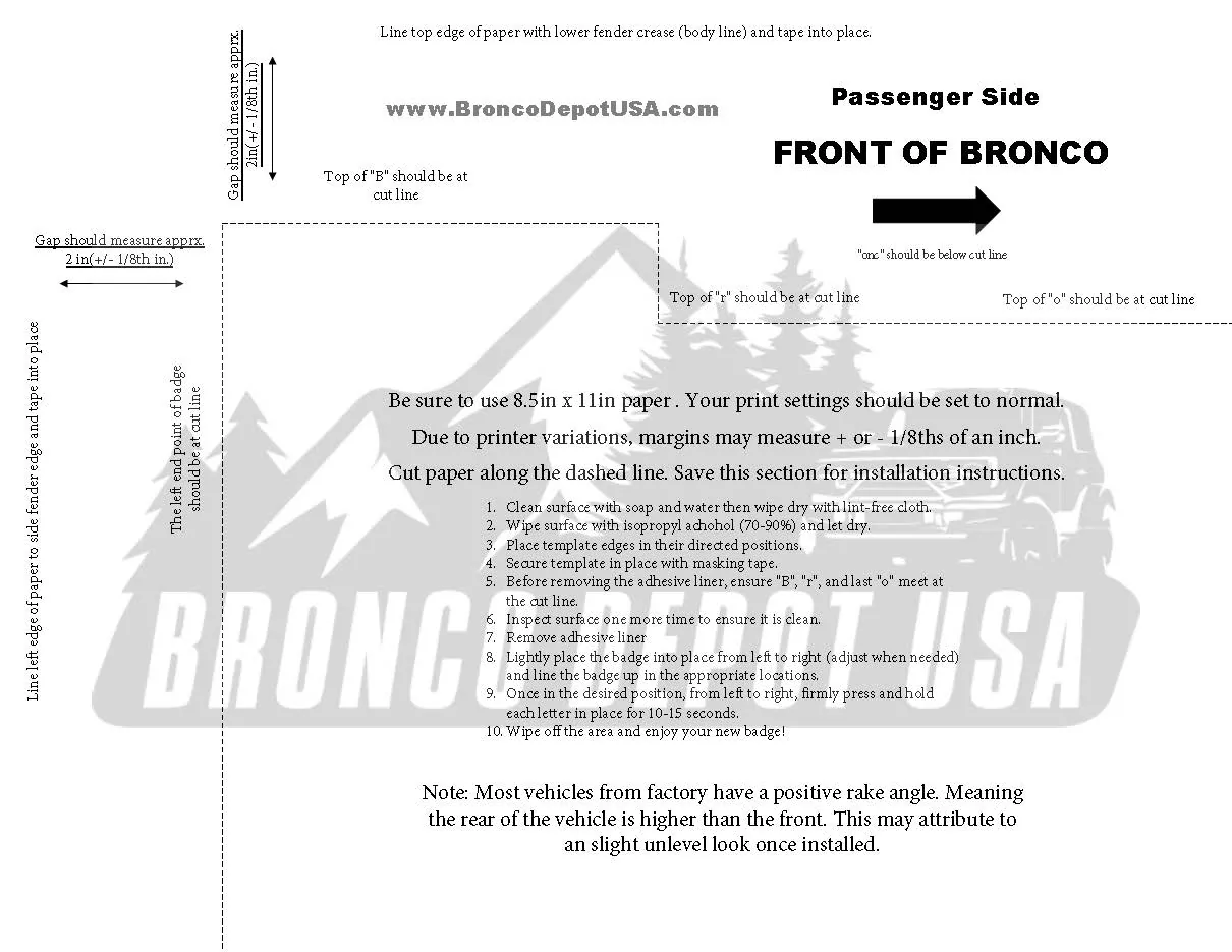

Ford Bronco Template for Ford Accessories Bronco Script Emblem - M1447BSGS Bronco Badge Installation Template(1)_Page_1
Ford Bronco Template for Ford Accessories Bronco Script Emblem - M1447BSGS Bronco Badge Installation Template(1)_Page_2

Thanks. I thought I saw in a separate thread that this template didn’t work with the emblems purchased directly from Ford, but they worked for you?

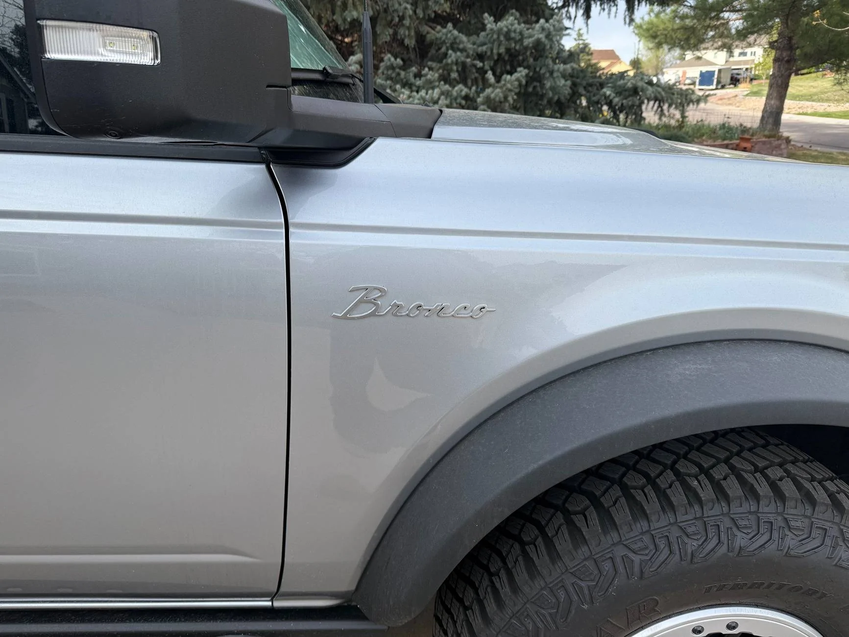

Here's how the placement looks using the Bronco Depot template above with the emblems direct from Ford...
