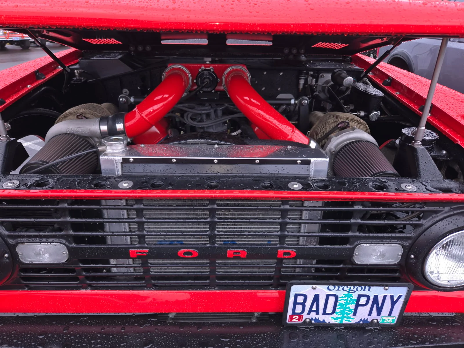

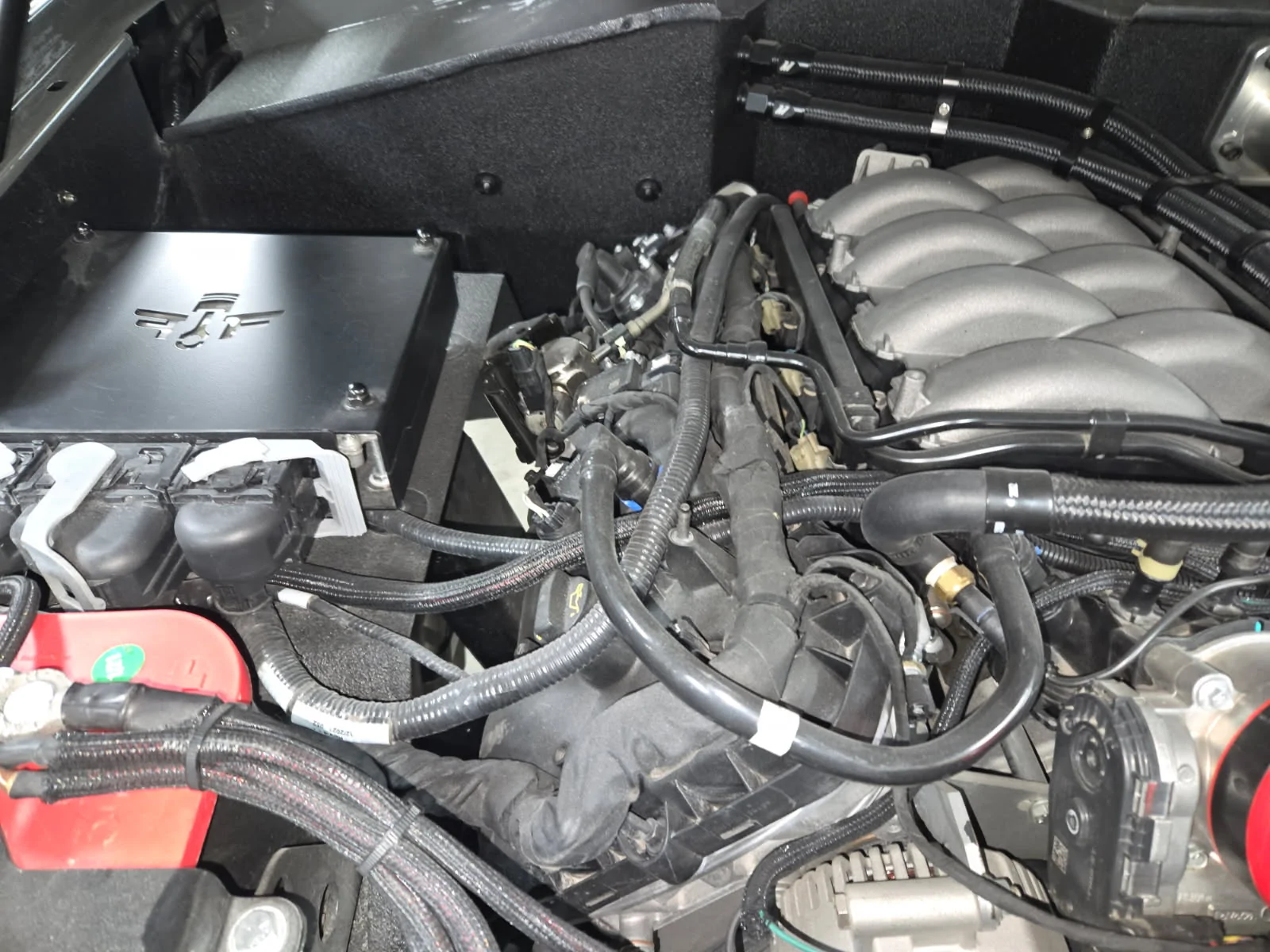

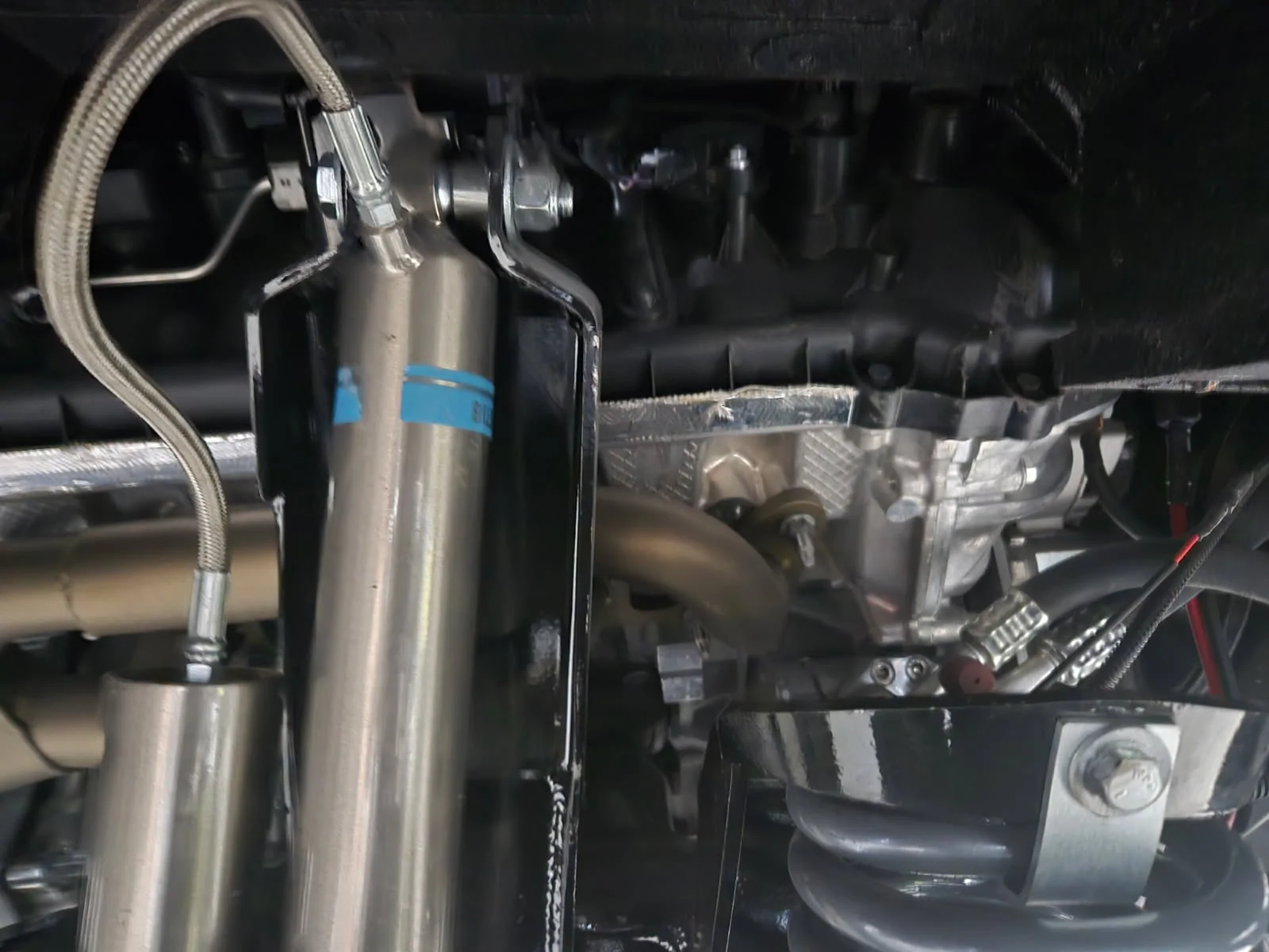

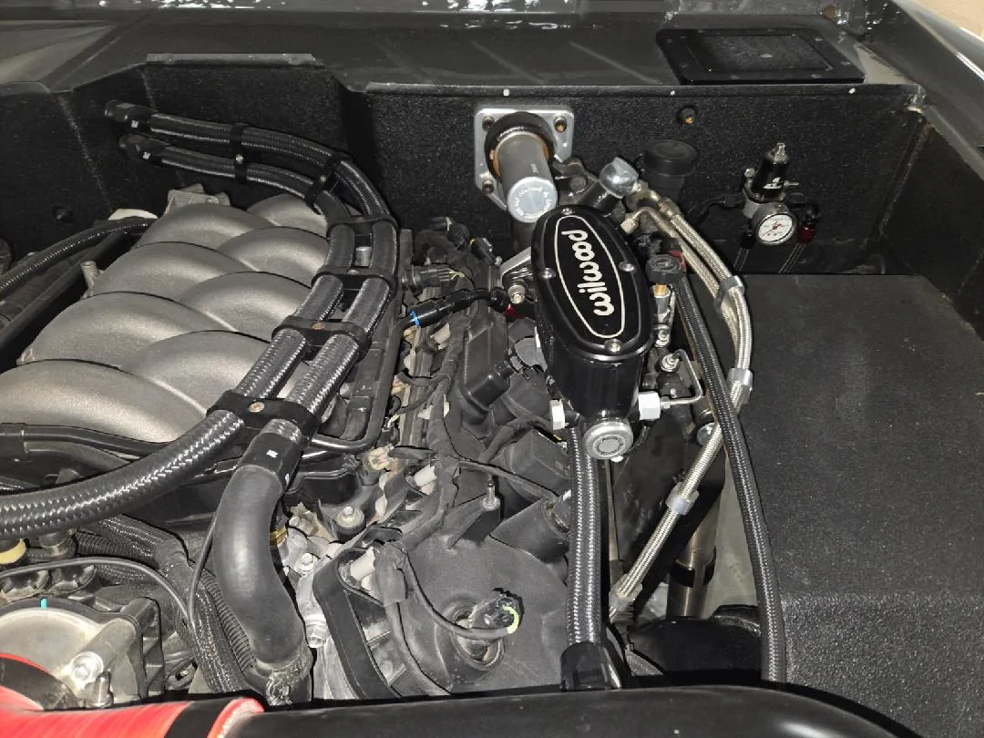

This is just NOT true . Plenty of coyote swaps in Gen1 1s...

None of those are frame modified? I understood that it had to be modified height wise for it to fit.

I looked both of these Rigs Over pretty carefully and crawled underneath and I didn't see any frame chopping that had to do with engine clearance issues I did see a custom oil pan for where the front axle would articulate and I suppose they're at rear crossmember probably was changed for the transmission that had been changed as well to newer version....But these newer 5.0 engines DO fit in both gen 1 and gen3 without frame mods.
