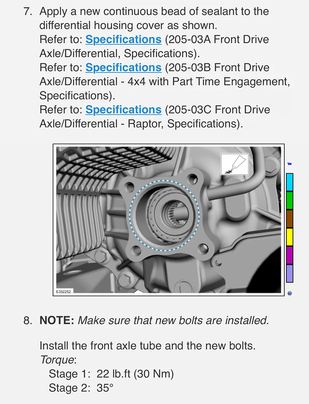

I'm getting ready to put my front diff back together and am looking for the torque specs on the case bolts and the 4 bolts for the intermediate shaft tube to diff. I've searched hi and low and have not found this information as of yet.

I just torqued them to 60 foot pounds. It's not leaking yet, 😆, we shall see if it does or not...
That’s basically what I did as well. Used an entire tube of RTV, at that point the bolts are more or less optional

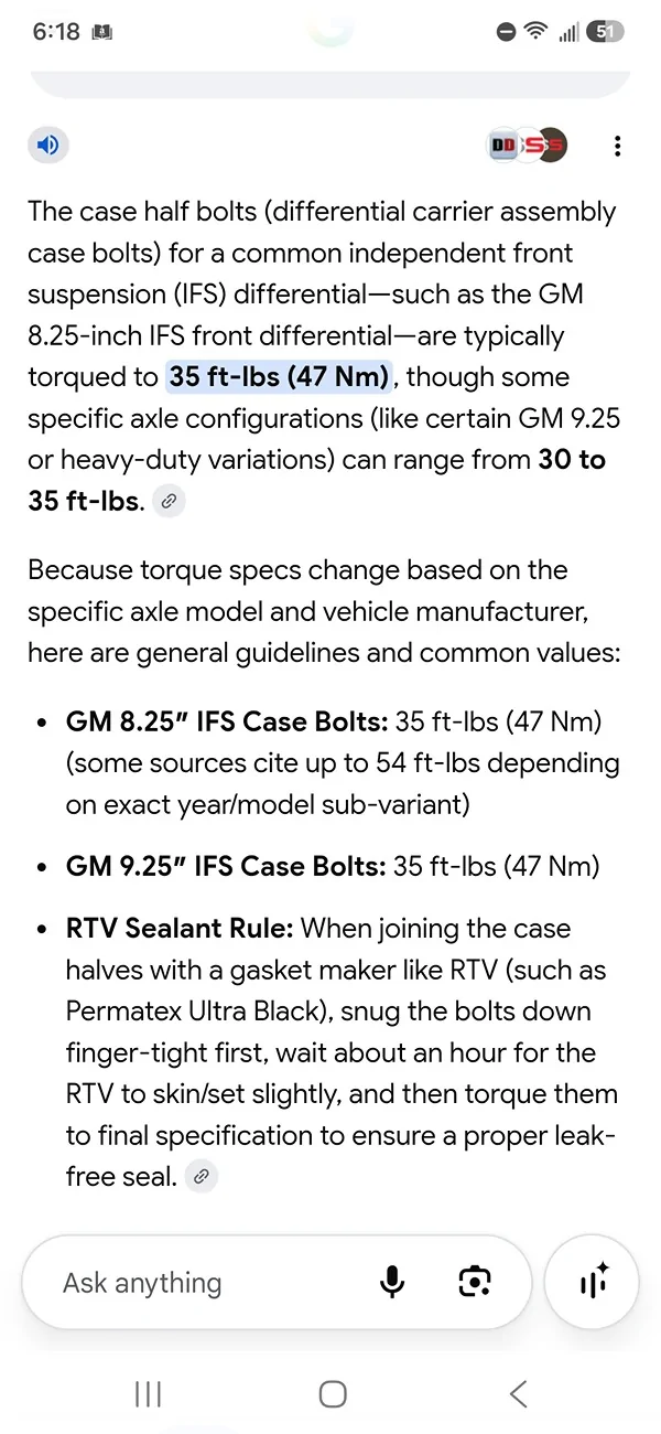

I may have over torqued my bolts...
Ford Bronco M210 Case Bolt Torque Specs Screenshot_20260823_061825_Googl
I have my front end torn apart again so I will use these numbers and see what happens.
