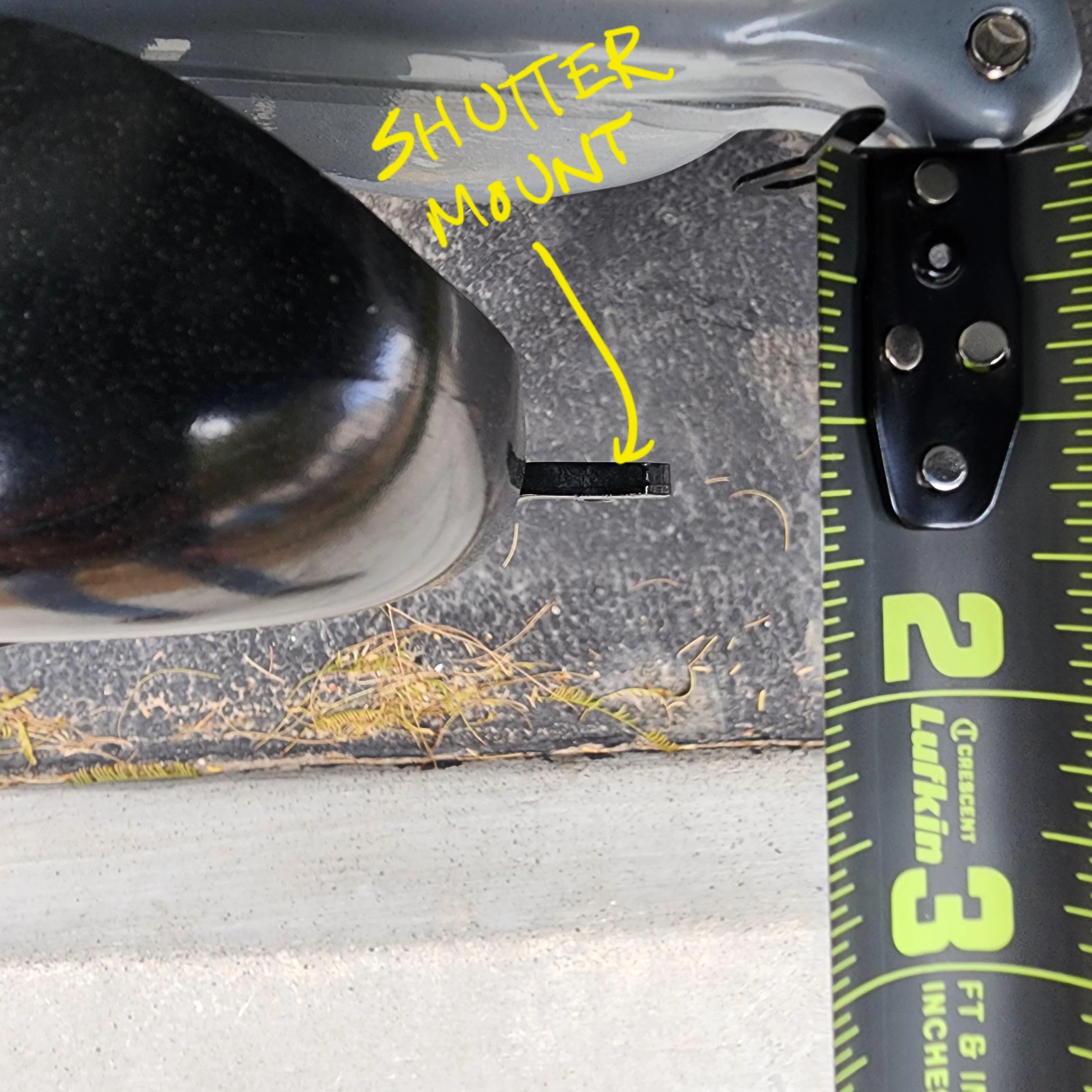

Evo 10s (standard drum) fits with room to spare if you take the decorative motor casing off and trim the shutter tabs.

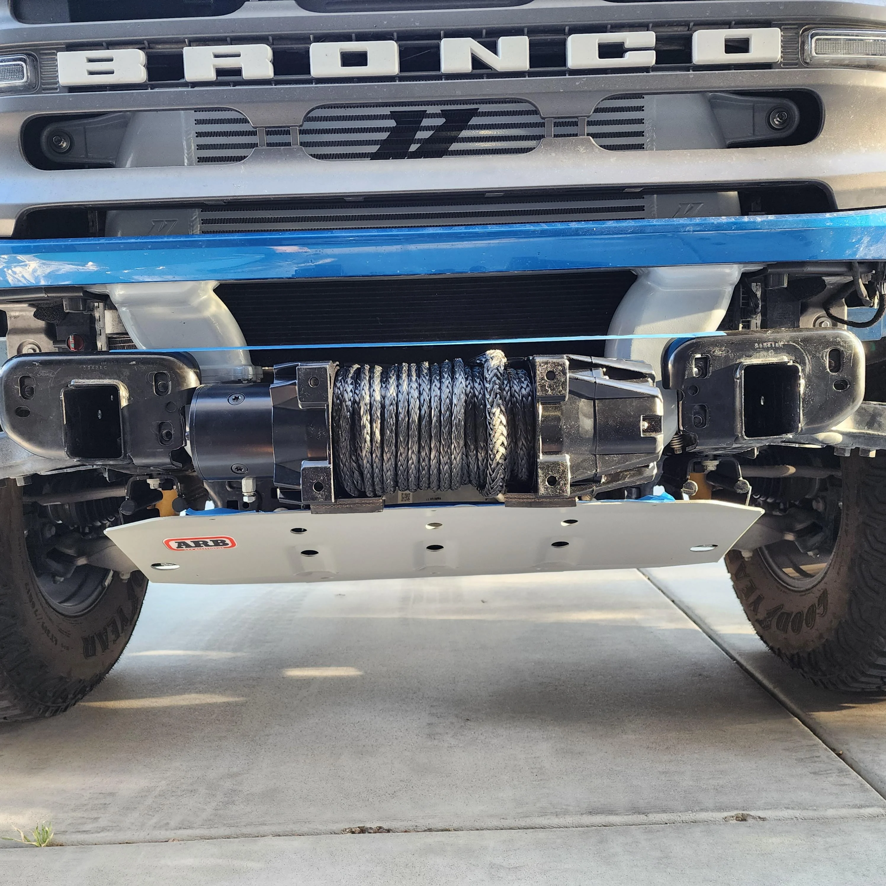

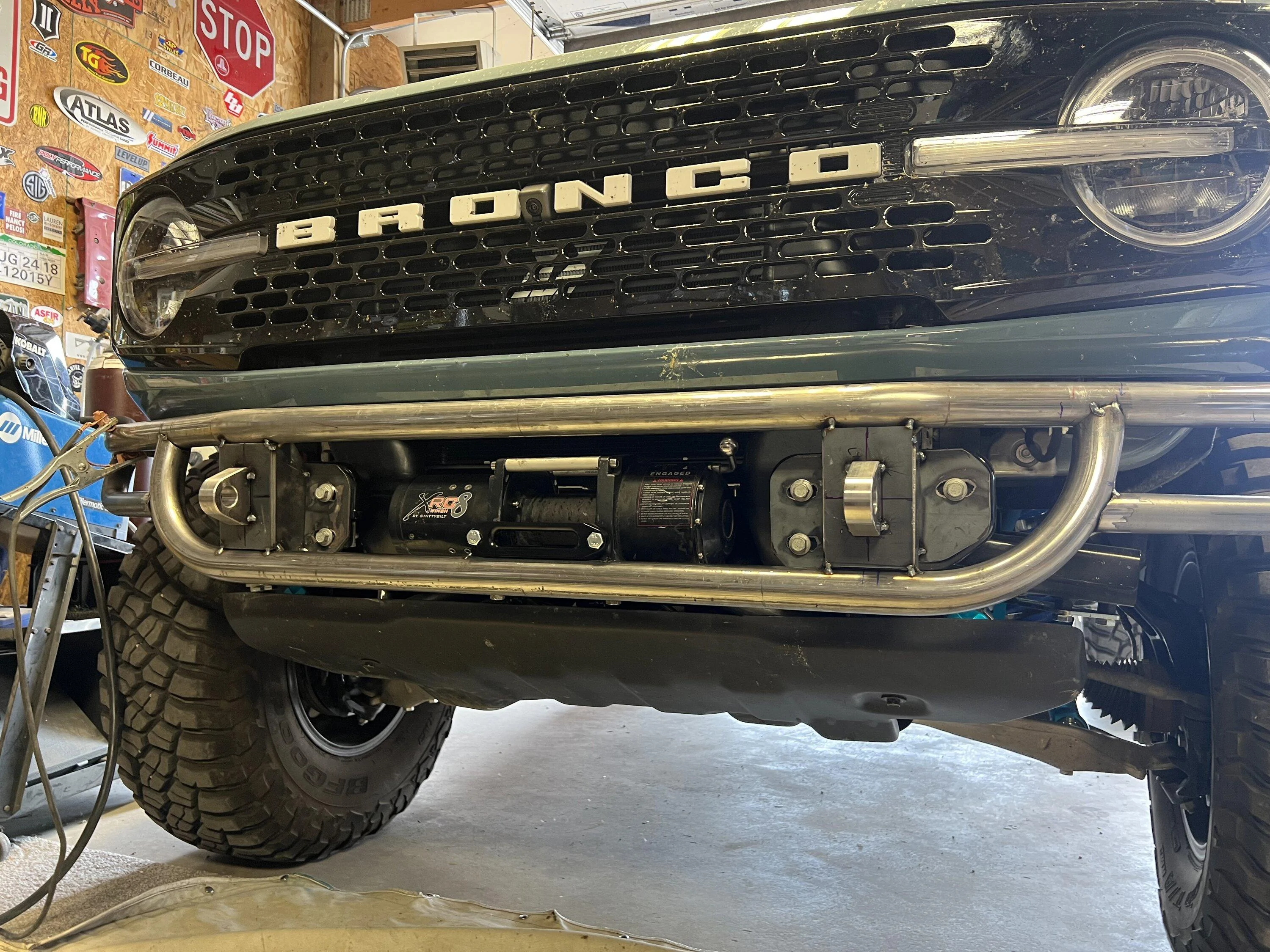

(Mine still in development)
Ford Bronco Lowest Profile 2.7L Winch Bumper/Mount? 20230403_125324
Ford Bronco Lowest Profile 2.7L Winch Bumper/Mount? 20230416_180843

I wasn’t happy with mine sitting out that far. I actually pushed it back between the intercooler downpipes….even the short drum is tight back that far…

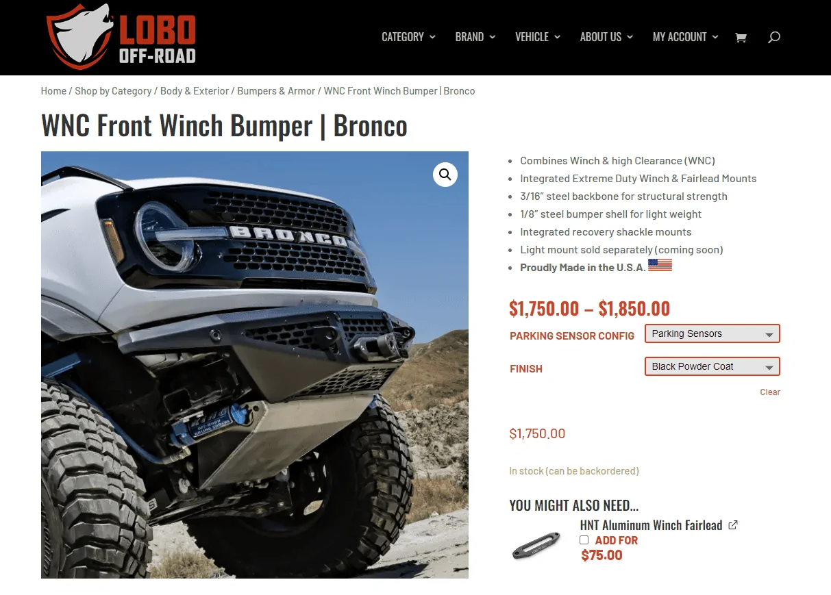

Hello, Attached is the forum for our WNC bumper, Within the post you are able to see in depth the structure that is designed to adequately support the winch and D rings. Also attached is a link to the website, where you may see a handful of other pictures, including the camera view and side view. The two pictures most manufactures try to avoid. From the center of the valance under the grill to the center front face of the bumper it is UNDER 4.00". ONLY 1" forward compared to the factory modular bumper.
https://www.bronco6g.com/forum/threads/lobo-off-road-wnc-front-winch-bumper.55472/
https://lobooffroad.com/product/wnc-front-winch-bumper-bronco/

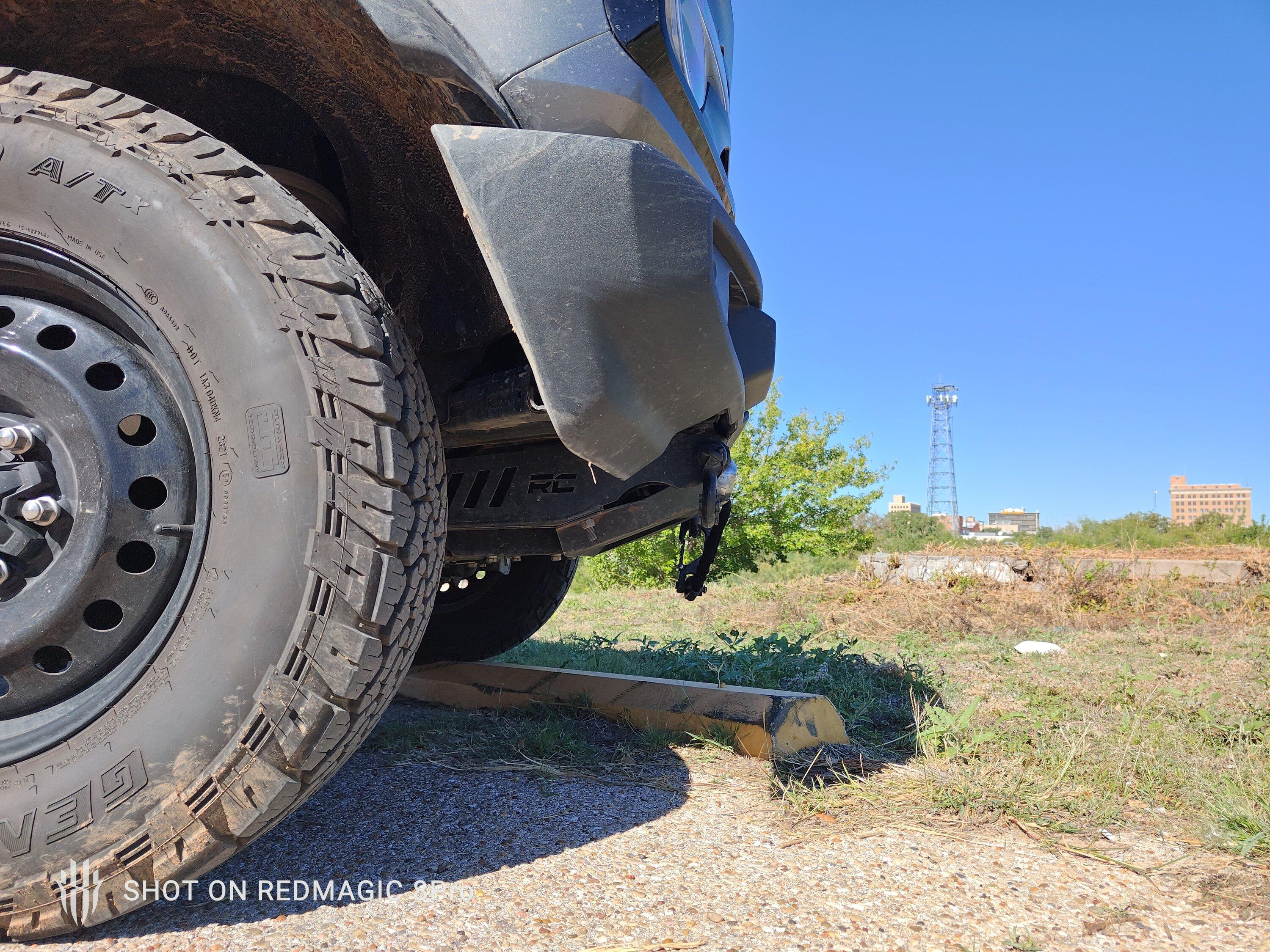

I am kinda partial to my RC hidden winch mount. It's fully approved by my local mall.
As you can see, plenty of approach angle for the most serious mall situations.

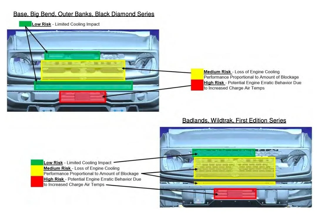

Shouldn't I be worried about blocking the cooler? I have ACC, can that be disabled and removed?
Ford Bronco Lowest Profile 2.7L Winch Bumper/Mount? 16989459742968216196617409466017

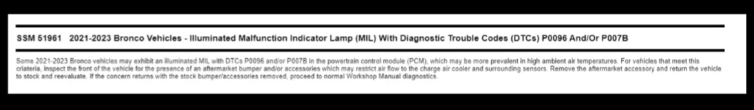

Blocking the cooler is a real thing:
Ford Bronco Lowest Profile 2.7L Winch Bumper/Mount? Screenshot_20231026_100113_Chrome
Ford Bronco Lowest Profile 2.7L Winch Bumper/Mount? Screenshot_20230305_184118_Chrome

Thanks @broncorik ! I have the Ford tune and actually wheel my Bronco, this is a concern of mine.
