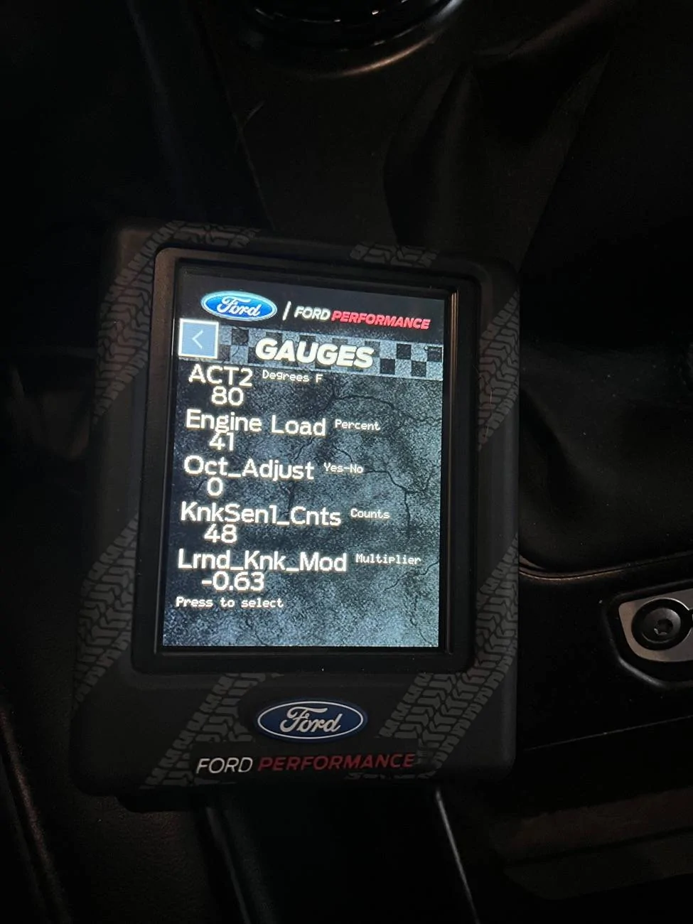

Thanks for posting this. I assume the Ford performance gauge "octane adjust" on the ProCal is the OAR reading discussed (can anyone confirm or deny?). He describes a driving procedure to try to get it to activate and adjust to your good fuel:
I just checked mine - it’s called Lrnd_Knk_Mod
Ford Bronco Looking for 2.3 owners input IMG_2336
The note for OCt adjust says it’s either off (0) or on (1) - so not sure what that is
I’ll say since I’m showing what mine is - I get 91 octane every time, mostly from one of 3 Top Tier stations near where I live. I do a lot of hilly driving and have a lot of extended pulls on grade at boost

From the article linked by @burgerking
If the engine knocks badly at any time, it will move the other way, towards its low octane tables, thus lowering load and ignition advance allowance. It’s position between these blending tables is indicated by the OAR Figure which will be somewhere between a best of -1.00 (High-97) and a worst of +1.00 (Low-93) A middle position is an OAR of 0.00 (95)
So I’m sitting at -0.63 — probably makes sense for 91 octane on ProCal. It as adjusted upwards some but didn’t hit the limit of max performance. I’d expect that number to slide closer to -1 if I ran 93, and slide positive if I ran non-premium fuel.
Thanks for posting this info - I just added Lrnd_Knk_Mod and mine is reading -1.0. My E85 mixing strategy must be enough. I make conservative assumptions, for example that the E85 I'm using is 99 octane (possible, particularly in winter, though it is probably higher). Perhaps my average tanks are closer to 93.5 or 94 thus I'm maxed at -1.0
I wasn't able to find the same screen (at least it didn't match yours), but here's my readings:
ACT2
122
KnkAdder
0.0
KnkSen1_Cnts
999
Lrnd_Knk_Mod
-0.95
Oct_Adjust
I use 93 exclusively since probably 3k miles, and get Buc-ee's primarily, but Exxon/Shell/Chevon/Mobile/Phillips 66 if I have to. I have a fillup right now of Buc-ee's but over the weekend had two straight fill ups elsewhere (Mobile and Phillips 66).
It seems like the Lrnd_Knk_Mod is good? Why would KnkSen1_Cnts be 999?
Oh I was just using the data logging screen - you can set whatever parameters you want there. You found the setting, I believe it’s in Spark or Ignition - can’t remember the exact name.
I dunno what the Counts fields are - some of it may be extraneous junk meant for use with other engines.
Ok. I hope that doesn't mean it's counted upwards of a thousand knocks. I do notice some days it does feel like the engine is sucking wind.
I found the data under a couple menus, one was Datalogging > Gauges > Spark > Lrnd_Knk_Mod (which is what I thought you were talking about), and another one, I think ACT2? Not a very graceful device to work with.
