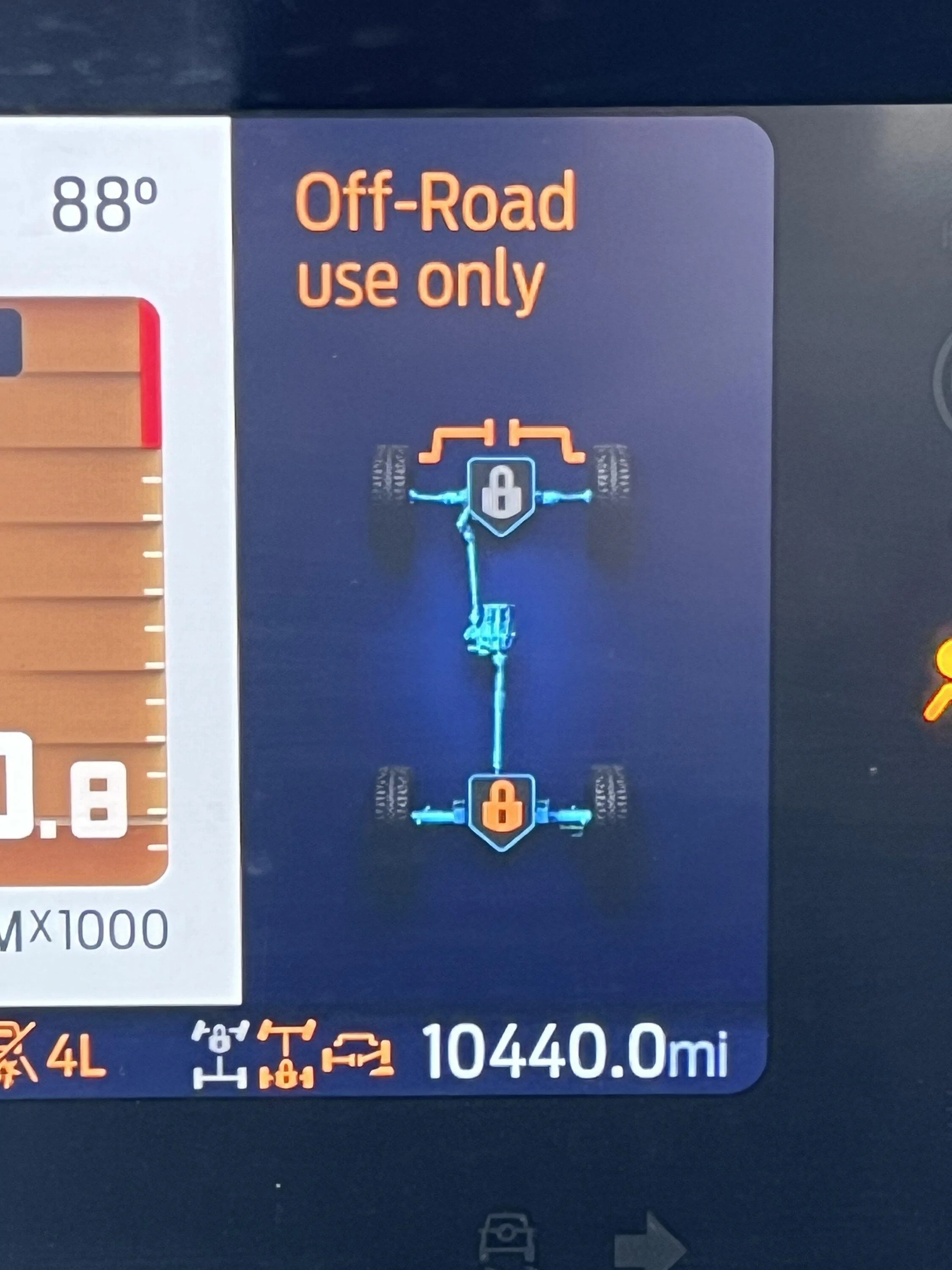

This is what the dash looks like when you have the front locker button pushed, but it will not physically engage. If you don't have the gray icon I think it means your locker is just in a bind and will release after you drive around a bit. Good luck getting it to re-engage later.....
Ford Bronco Lockers vs hero indicator lights cpwg2DJ
