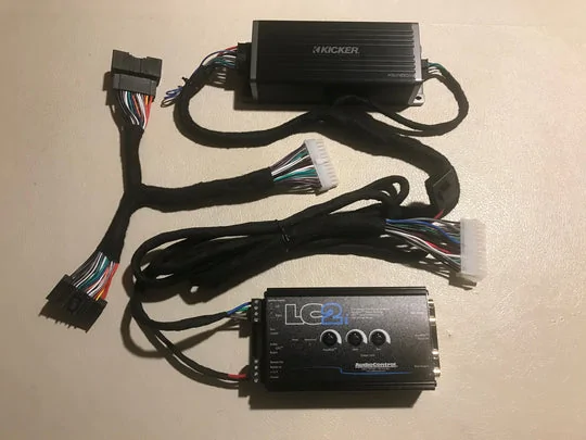

so basically the way its laid out is that he has a harness and then pairs it with what you want
maybe you want a sub or a line out converter or a whatever
auto sound electronics are too complicated thats why its seems all over the place but if you know what you're looking for its actually really cool.
the best deal to me is the kit 26 because you get the kicker key 200.4 and the 500 .1 which will you give power for the main speakers and a power for a sub and the sub all prewired so you basically plug it in and your golden! i mean that's a 3000$ system at a shop and hes got it all buttoned up !~ for only $900

This is interesting... I'm going to have to see if they offer a version with the Key and a line out processor to add a sub. Seems like it should be very doable. I want to throw some better speakers in the dash and rear to bring some quality to the highs, but I suspect the kick panels would handle the better am and be just fine.
you want kit 15 i think
