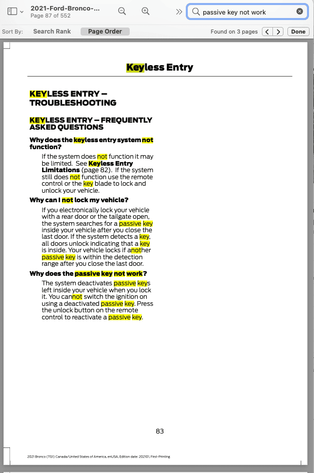

I have the Base Sasquatch and specifically ordered the keypad bc I love my F-150 keypad.
BUT when I try to lock and close the door in my Bronco, the horn double honks and the car unlocks itself. Is this bc I locked the car using the lock/unlock button instead of the keypad?? (I actually wondered if my keypad was working incorrectly bc my F150 I lock using the lock/unlock.)
@ZackDanger - which page of the owner's manual did you quote from in your post? I promise you that I reviewed the manual for the answer to my above question and (frustratingly) did not find the answer.
Thanks.
Hold down 7/8 and 9/0 simultaneously with the key fob inside, it will then lock doors.

You have to use the keypad to lock it with the fob inside. You can't do it with the door lock.
Thanks.
Like the other's have said: You purposely can not lock a key in the vehicle with the button on the inside of the door... as a means to prevent you from locking your keys in the vehicle.
You *can* however lock a key in the vehicle if you lock it with the number pad, since the vehicle knows that you know what your code is and could unlock the vehicle without the fob in hand.
The page of the owner's manual is 83... I just open the PDF and Ctrl-F for the term's I want:
