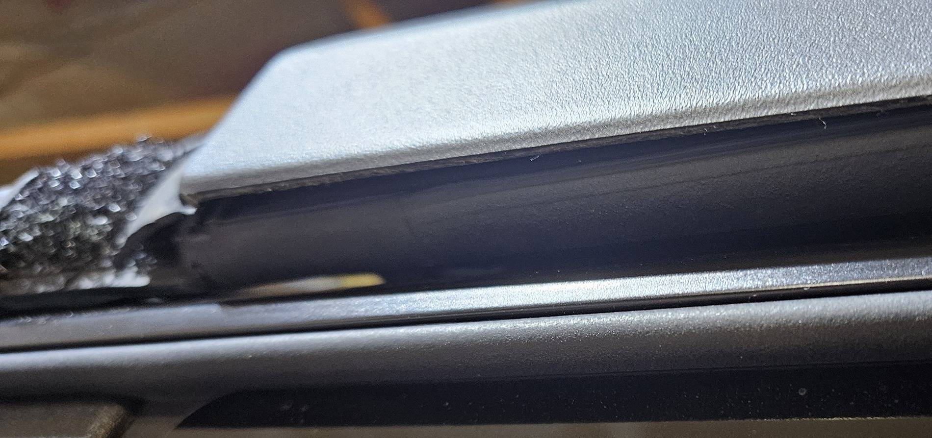

I did this today, and wasn't terribly excited about the results. The thickness of the plastic they put in where the hard top bracket attaches, makes the hard top sit up enough that the seal doesn't make contact anymore on the end where the bracket is. This leaves a gap, that while I haven't driven it yet, but seems like it might make a fair amount of noise and possibly collect rain/spray going down the road.
I've reached out to them to see if they have a fix or solution for this, but I'm curious if you see the same gap, and have any extra road noise or leaking.
This is Mike with JTops. Can you give me a call?
I can try and help you with this alignment issue.
We have seen this before but only on a handful of installations.
I can be reached directly at 469-532-0808

@Rhyas , I just looked at mine at this point (drivers side just above the B pillar) and the hard top is pressed against the seals normally (which themselves are pressed against the vehical)- no gap/separation as in your pick. Walking around looking at everything it all is mated up well. FYI

Thanks for chatting today Mike. I did the re-alignment process you suggested, and even found the ford process and took a stab with that. In the end, with those methods, I couldn't get the middle section of the top to seal.
I dont know why, but with the bimini top under the bracket, it caused the inside of the bracket to be elevated ever so slightly. It wasnt sitting flat.
I ended up bending the bracket down on the back latch ever so slightly, and that let the clip pull far enough down to seat the seal. Alternatively I could have shimmed the outside of the bracket with something, and probably gotten the same result.
