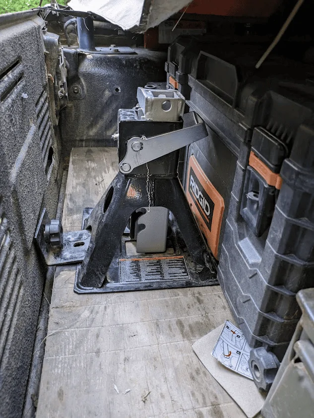

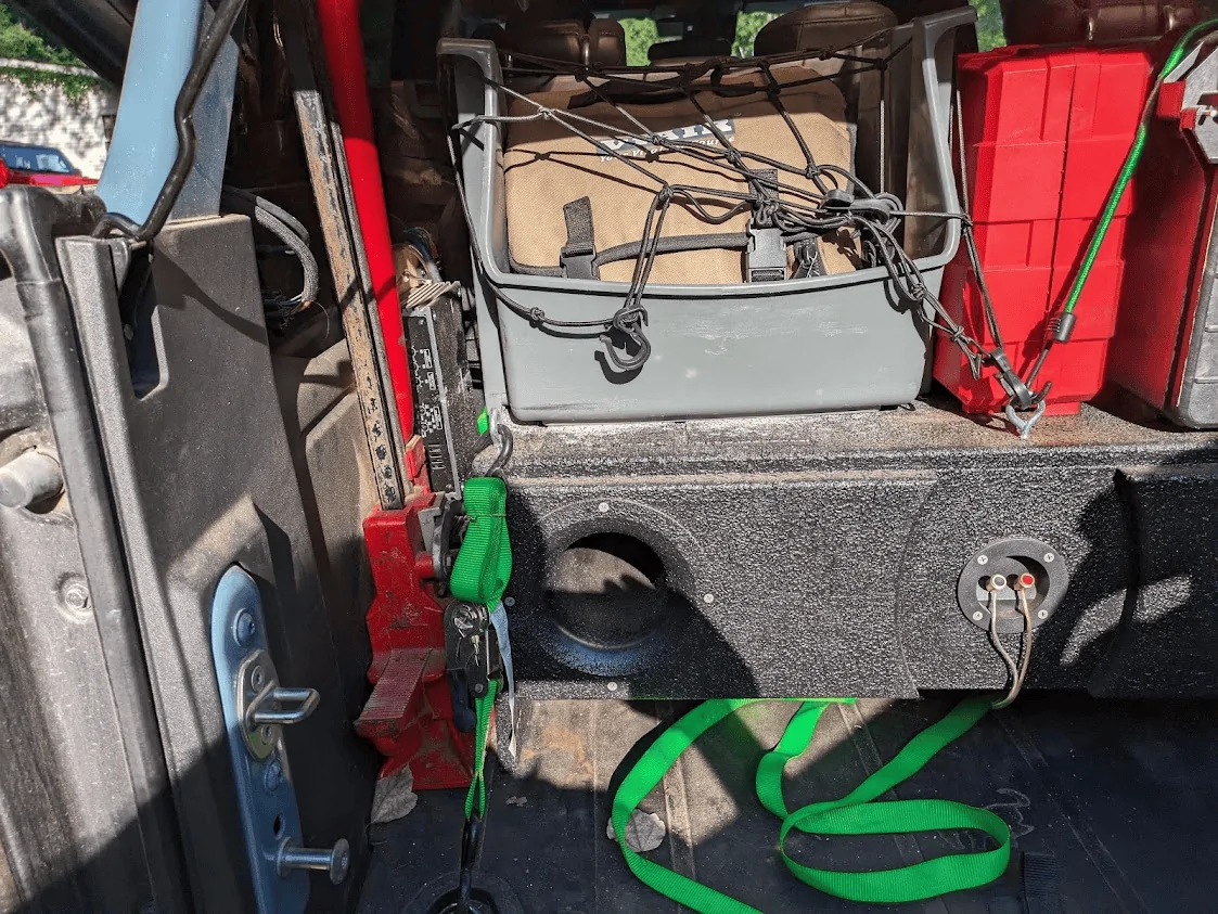

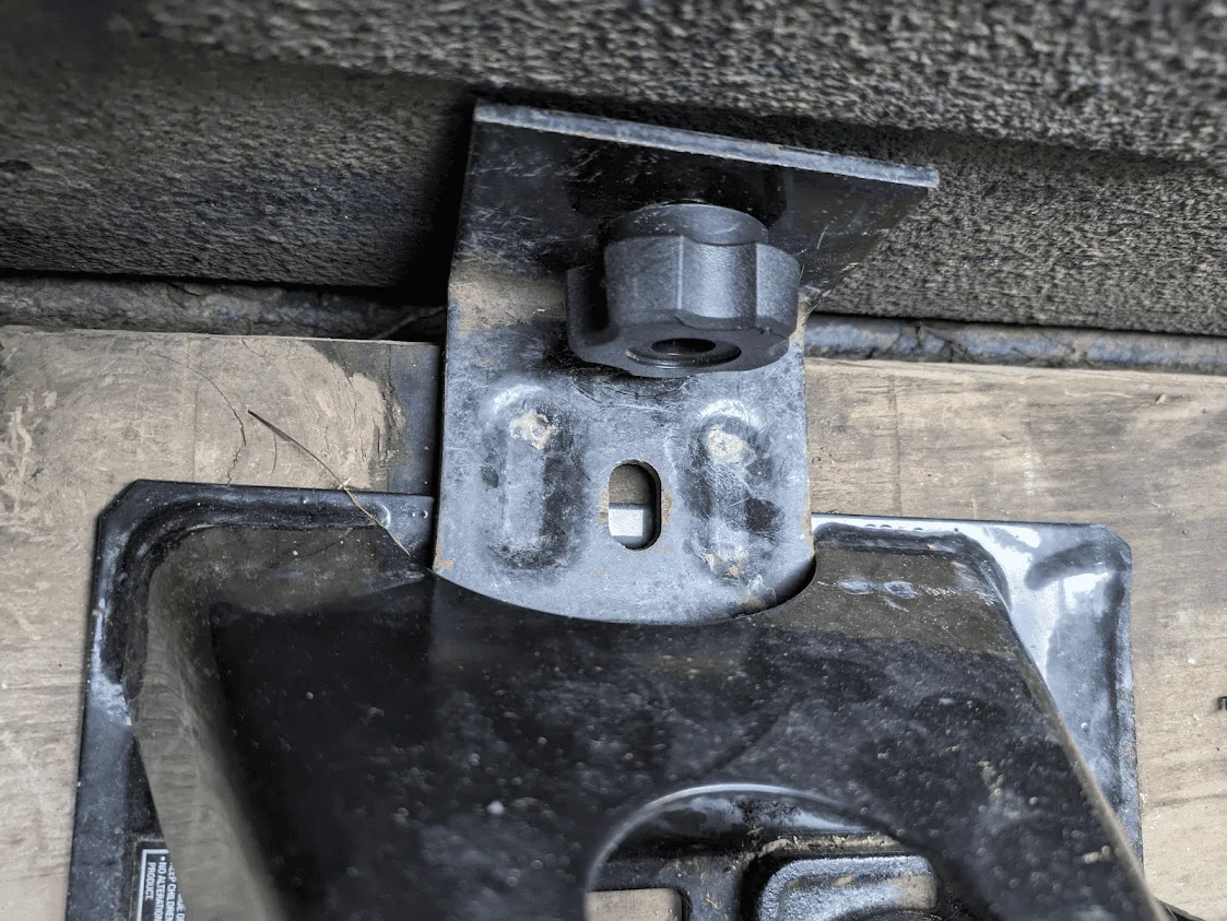

As promised it isn't anything Pretty;
Ford Bronco Jacking Off Road - Best Practices 1715909200224-k8
Ford Bronco Jacking Off Road - Best Practices 1715909513072-q4
Whenever I'm mounting a power built jack, I just find an edge to tuck it under on one side, and then put a rivnut or stud somewhere on the other side so I can use a threaded knob to lock it down with either an L-bracket, or a straight bracket if I have to go to the floor. This particular Pic is in the back of my TJ Rubi, I have a similar setup for it in my Wife's JKU, But that's up on the lift as I'm doing major axle renovations (She managed to actually rip her Front D44 in half at the last Big Dogs event!)

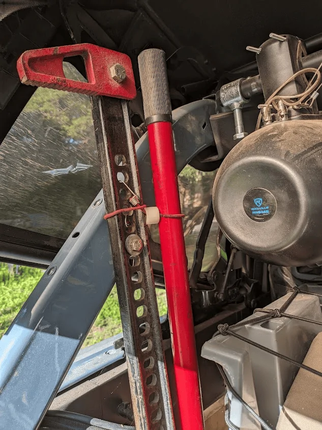

I have a Farm Jack in the Bronco, I believe that they should be kept in the vehicle when ever possible, as weathering is really hard on them, and I don't want it to fail when I want it...
Ford Bronco Jacking Off Road - Best Practices 1715909742810-ja
Ford Bronco Jacking Off Road - Best Practices 1715909798693-ph
They are easily cut to any length that is practical, and by cutting a 48" down, I was able to fit it upright in the back, and run a bolt into one of the existing threaded holes in the roll bar, Doing that really minimizes the amount of space you lose in storing one, and an ARB or a Tauler would actually consume more space than this does..
