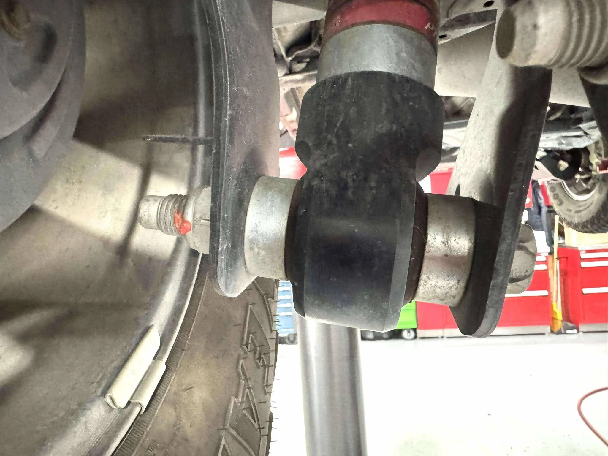

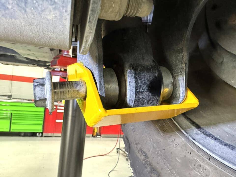

Got the BroncBuster rear shock skids and tried to install them - but they don't like the Eibachs.
The bottom of the shock mount for the Eibachs sticks out a bit on the bottom and prevents the shock bolt from lining up..
So a solution sounds like either a) a little deeper "well" to fit under the shock or b) larger mounting holes... or both.
Ahh well - reached out to BroncBuster for advice. I'll update if I hear anything.

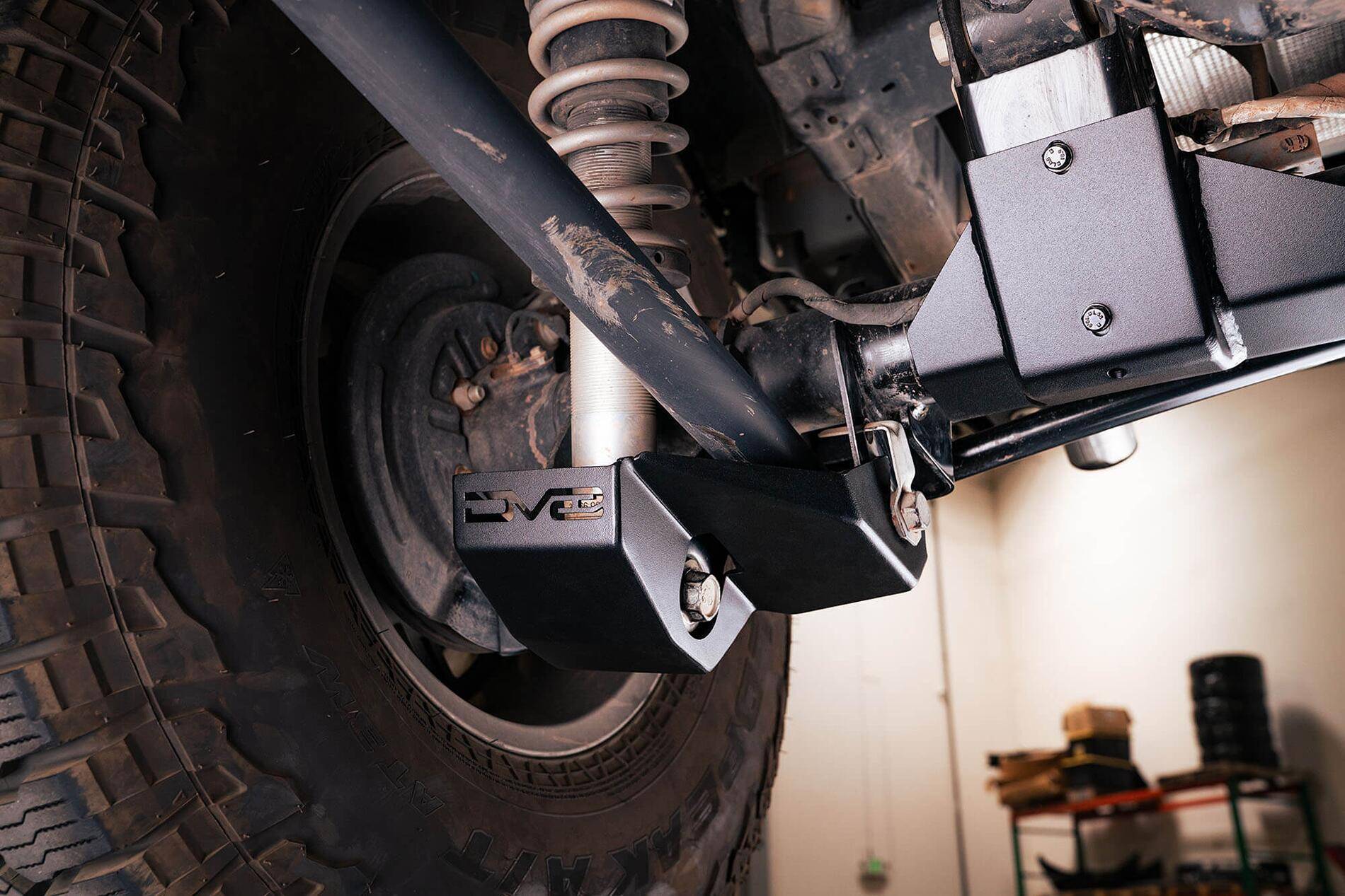

Yeah for this version. Might go with DV8...
I have the DV8 version. Works well, however has no drain holes. Highly recommend drilling a hole in the bottom of the tubs if you live/drive in a wet region. Mine were full of water/mud and rusting the bolt.
