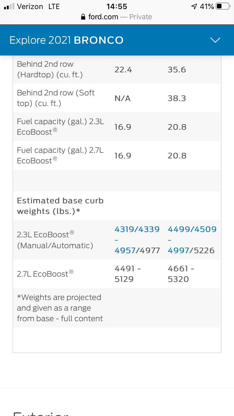

Max payload is GVWR-Curb weight. If Ford wants the Bronco to compete with Wrangler they have to stay under 6,000 GVWR otherwise its in a completely different category. It doesnt mean the vehicle cant technically carry more. That would be the official safe rating from Ford. The payload on the Bronco is listed as 1350 max because a GVWR of 6000-the base model curb weight of 4660 = 1340. As you add features and accesories this payload rating goes down. The highest listed curb weight by Ford is 5320. This leaves only 700lbs of payload.
Um.. those are max available. I don’t think you get what I’m saying. Payload= GVWR- curb. So if you put a engine that weighs 200lbs more and nothing else changes like wheel base or suspension you just lost 200lbs of payload. If ford is capping the Bronco at a 6k to stay in class with the wrangler and projects the curb weight in the pic that’s a pretty big difference in payload based off of configuration and options. So the way I see it curb weight effects payload and towing not so much gvcwr as the amount of tongue weight you can put on the bumper as that is part of payload.
I know how gvwr and payload works, I guess I’m just used to looking at trucks in the past when thinking anything of payload, and the gvwr can easily change between trims or engines, so finding only one payload cap anywhere I’ve seen for the bronco I assumed that was payload regardless and the gvwr would be different with engines/options or that if the payload was diff it would say “max available” or something not just a single rating. I mean tow cap doesn’t change, even the base that you can’t actually add the hitch to on build and price still lists as having the 3500lbs tow cap, hard to tow 3500lbs without a hitch. Haven’t seen an actual gvwr for the bronco either, just curb weight from ford. But even if as you both seem to be saying the gvwr won’t be any different across the board that still doesn’t add up. The lowest curb weight for the 4dr is with the 2.3(4500lbs), if ya assume max payload there then that only gives a gvwr of 5870lbs, if that’s the same across the board then with the highest curb weight of the 4dr with the 2.7 would only have 550lbs payload. My 3 closest friends weigh more than that together, so you’re saying ford would make a vehicle that by the sticker couldn’t even carry 3 passengers while empty even though it’s a 5 seater with cargo space? Couldn’t even throw some luggage in the back and drop family off at the airport without going over the payload? The roof can hold 450lbs, but the bronco can’t drive with more than that inside it? Guess it could be, but just seems a bit off to me. Course, even if that is the case, still doesn’t change the fact that some configuration of the bronco has plenty of payload for a slightly increased tow cap. If ford limited the engine/options/packages that you could get a 5k tow cap on what would be the big deal? Most suvs that have a tow rating have multiple tow ratings for different specs, and having a max tow option that limits engine choice and package options isn’t a new idea.
