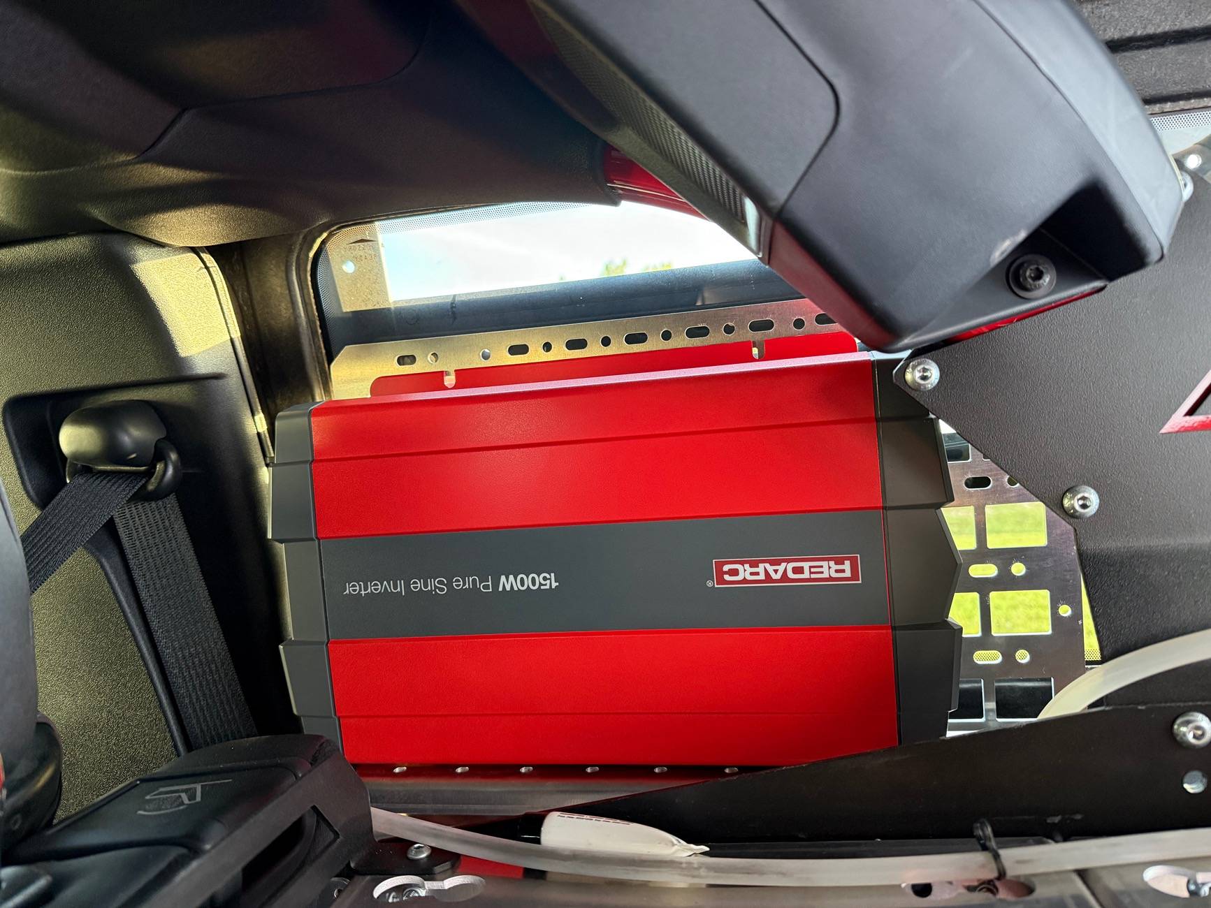

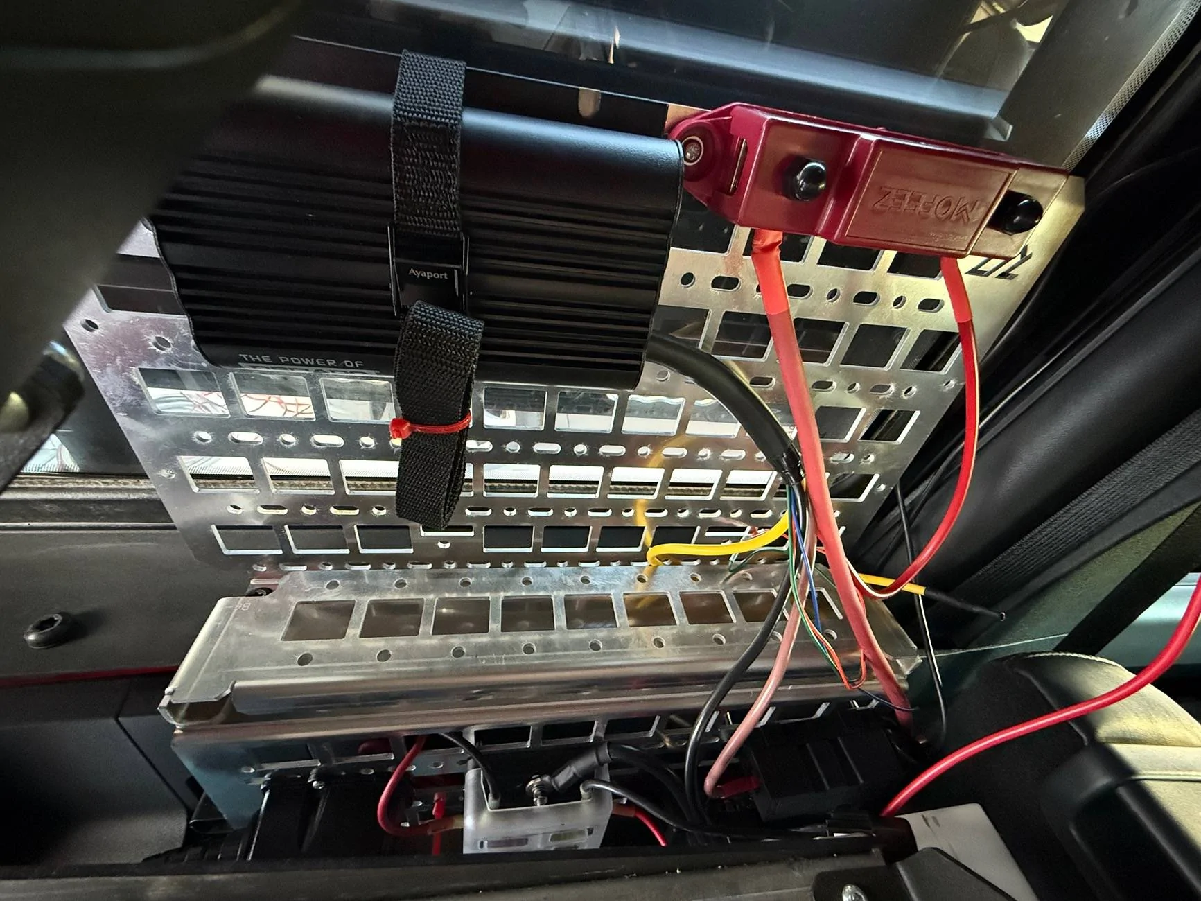

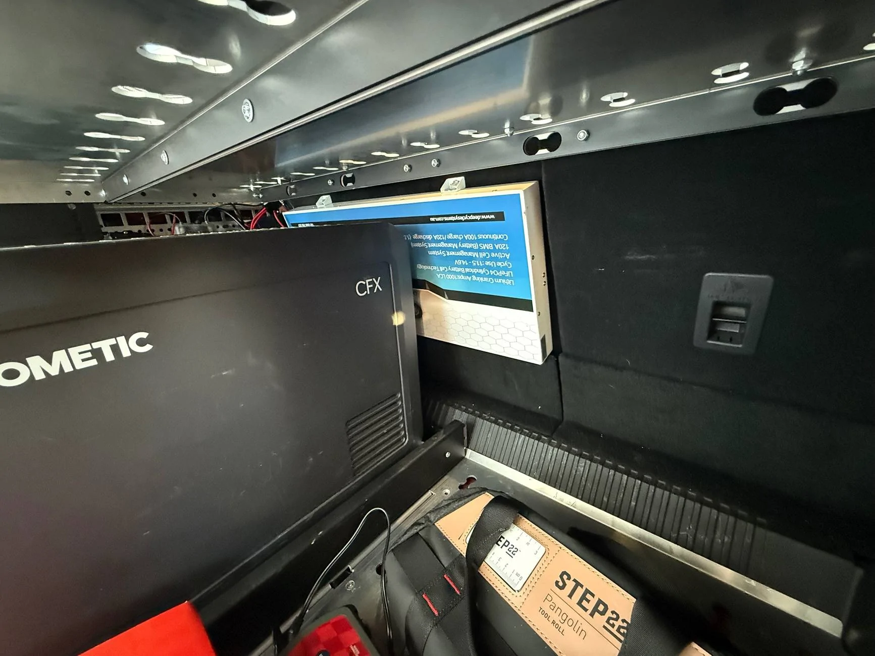

Thank you. Ended up buying the Redarc. Redarc specifies 3/0 wire for the roughly seven feet up from the bus bar over to the inverter on the other side of the cargo area. Putting a maxi fuse in line. Photos below of where it stands right now. Will need to finish running the wires to it and cleaning up the charger/distribution side. Wanting to replace my fuse block with a fused Anderson distribution block soon to help simplify and clean things up a bit. Inverter will remain tied to the bus bars.
Ford Bronco Inverter recommendations IMG_0191
Ford Bronco Inverter recommendations IMG_0192
Ford Bronco Inverter recommendations IMG_0194

akturbo
Oct 15, 2020
820
1,297
Seattle Eastside
'21 Bronco, '24 2D HLE (wife's), 3500HD Chevy, Rav4Prime, Turbo Skidoo
DCS Slimline. Rated for 120A continuous.
That DCS Slimline looks legit mounted on the back of the seat. Do you have any more pics of the battery install? I was planning to do the 4x20ah batteries in the storage tray for this summer, but this looks like a great option.
