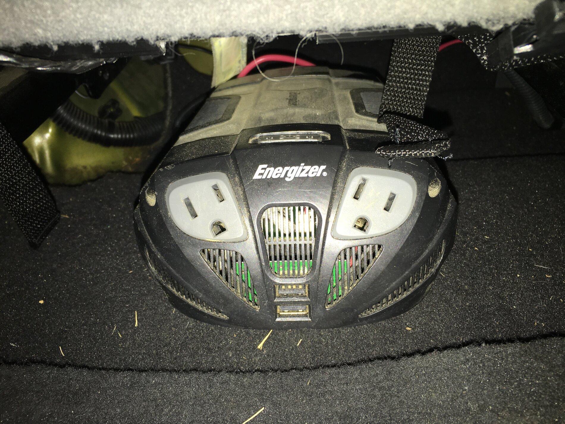

I put and energizer 500w inverter under the passenger seat in my Jeep. I run it through a relay so it is only on when the acc is on. I’ll try to get pics tomorrow.

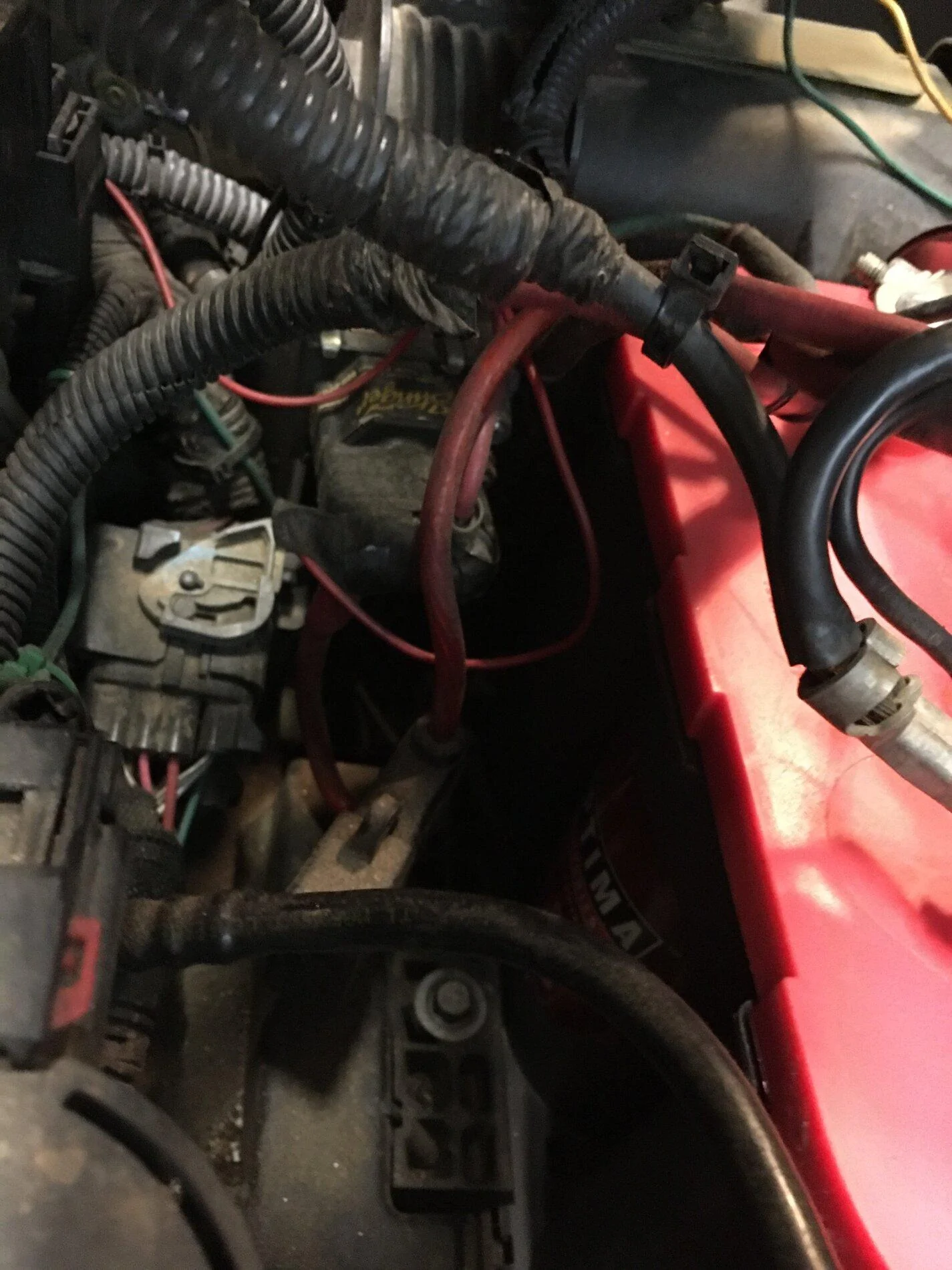

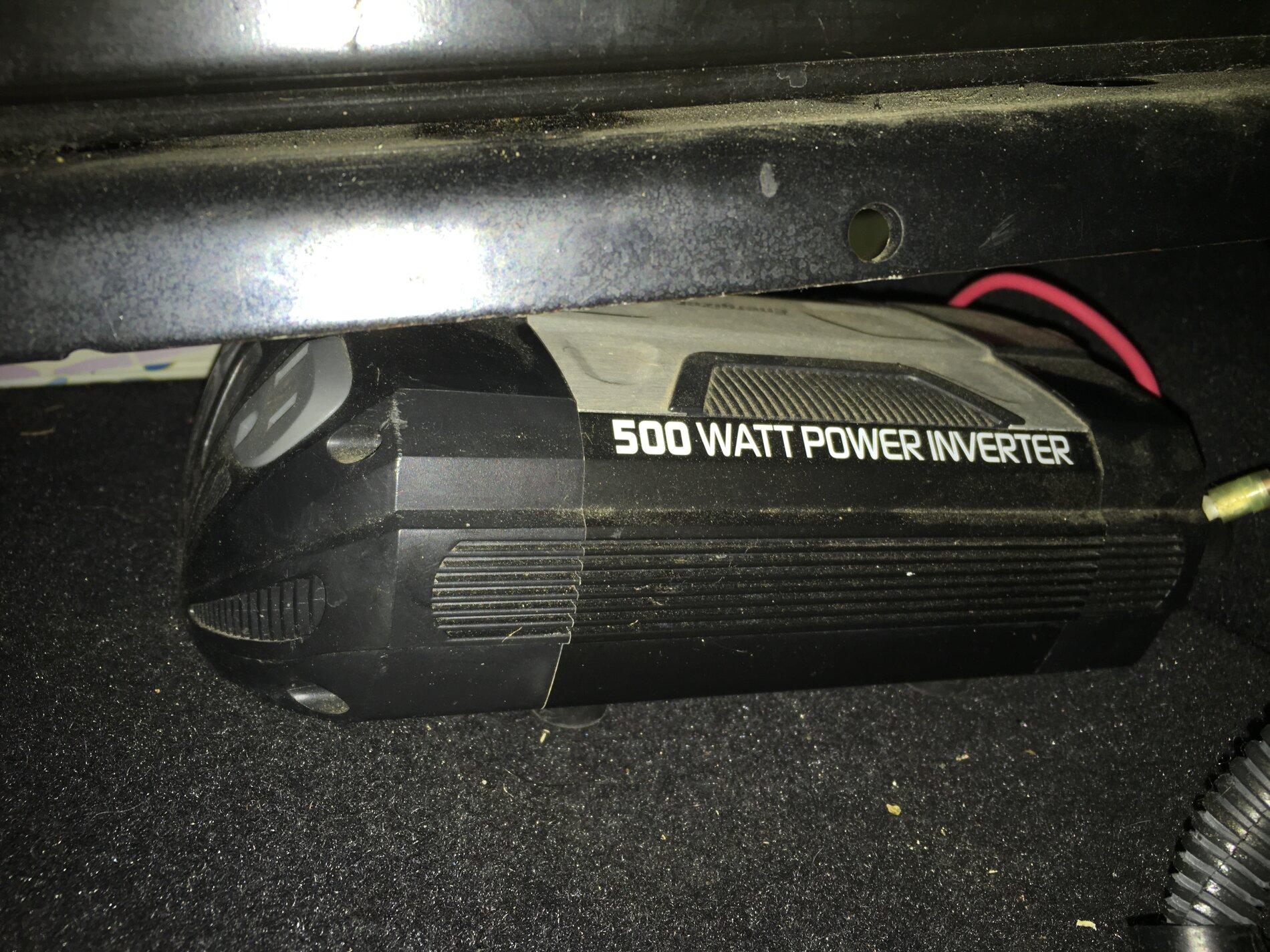

@NoDoorsNoProblem - here is my DIY Energizer 500 Watt Power Inverter setup:
Ford Bronco 110v A/C power inverter options? IMG_7544.JPG
Ford Bronco 110v A/C power inverter options? IMG_7545.JPG
The wiring is sized for the amps and the run length (google wire size based on amps and voltage) and runs up to a Stinger relay and blade fuse by the battery in the engine compartment:

The relay is connected to an ACC switched fuse in the fuse box so my kids would leave the thing charging their laptops without the engine running:

Yes - the trick was finding the way through the firewall from the battery, but a little googling and the answer was pictured. (This we will all have to discover and share when we get our Broncos. You won’t find DIY info on Bronco Nation, but Bronco6G here will be a fun place full of discovery ...)
Basically though, I took the current at 12v from the specs, and bought a fuse and relay to handle the current, and then looked up wire gauge for that current and approximate run length
From there, you’re just looking for a ground point and something switched to ACC for the relay.
Wire, connectors and some flex loom and you’re all set.
Also, the Energizer inverter comes with a light plug connection option, but you wouldn’t get to full wattage through 5amp lighter socket.
