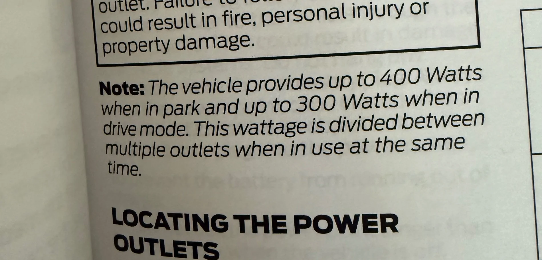

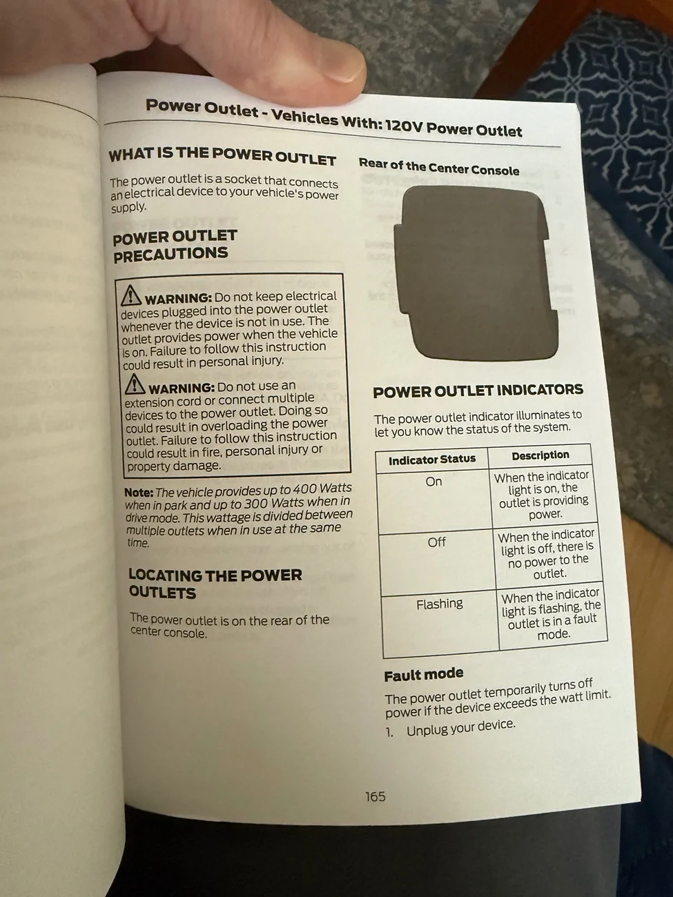

Anyone know the wattage of the built in power inverter? I have a Badlands Sasquatch with Lux package if that makes a difference.

The paper version of the owners manual that I purchased online shows that the power outlet has an anemic power of —400 W
Thank you!

I recall reading somewhere that it drops to 300w when the vehicle is in motion. EDIT: Ah it's right there in the manual screenshot.
Of importance, it doesn't work directly if you're planning to charge a power station such as an ecoflow.

Essentially - a 30A 12V (360W, ok, 33.3A) circuit that drops 5 amps (25A*12V=300W) when other vehicle circuits divert power.

I think on the Badlands with the Lux package it’s rated for 400W max. Mine is a Black Diamond and that’s what the manual says for the 110V outlet in the back. Not sure if Sasquatch changes the electrics though.
