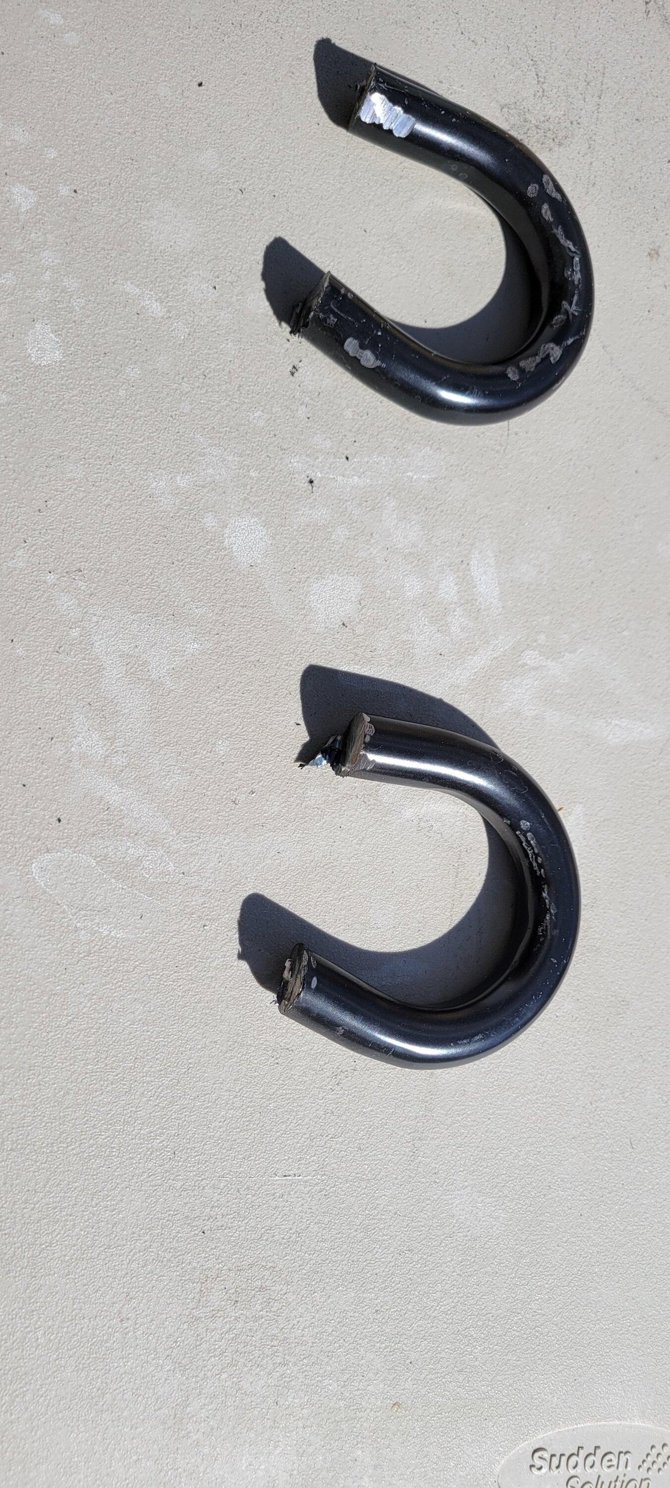

Fyi, if upgrading from a base plastic bumper to a modular and you don't have the steel skid plate to go along with it you'll have to cut up your plastic a good amount to get it to fit with the modular. All the cutting is at the top side where it really can't be seen behind the bottom of the modular bumper.
I cut off the tow rings on my brackets and it was a direct swap otherwise. I also did not have sensors to swap, but the modular bumper had holes for parking sensors so I filled them with rubber grommets.
Here's a Pic of the horseshoes I made.
So you’re saying if you have the capable bumper with the steel skid plate and move to the modular bumper the same steel skid plate works for both with no modification needed? Just checking as the plastic needs modified. Appreciate you taking the time to share!
