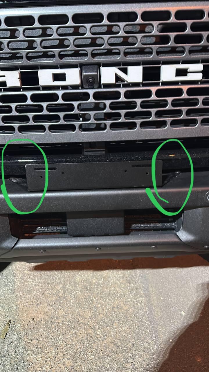

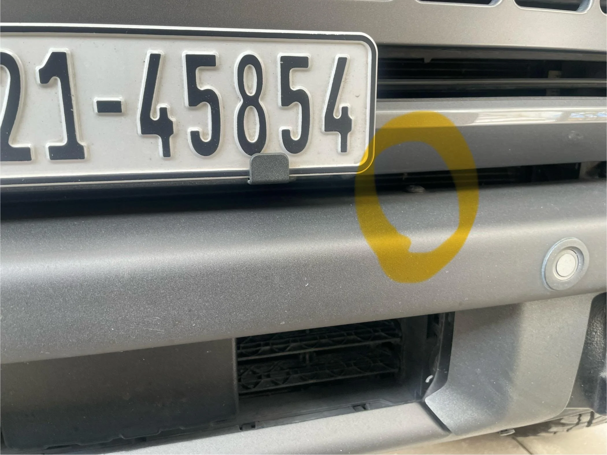

Hello, does anyone have an idea on how to get to this bolt without having to remove the grille? I am gonna be installing a bracket for my license plate (similar to the 2nd photo) so I just need to unscrew the bolt a bit to slide the bracket below the screw.

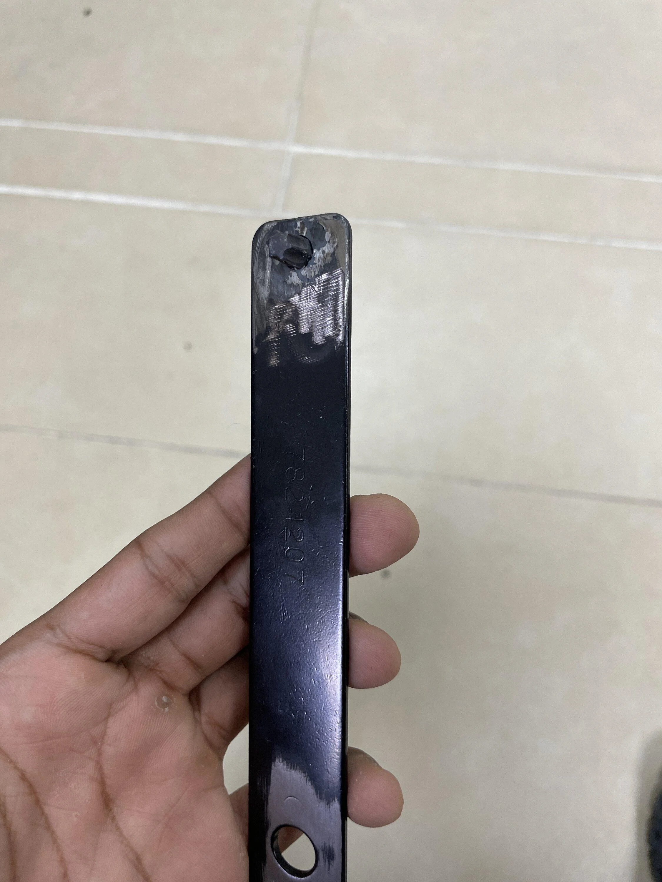

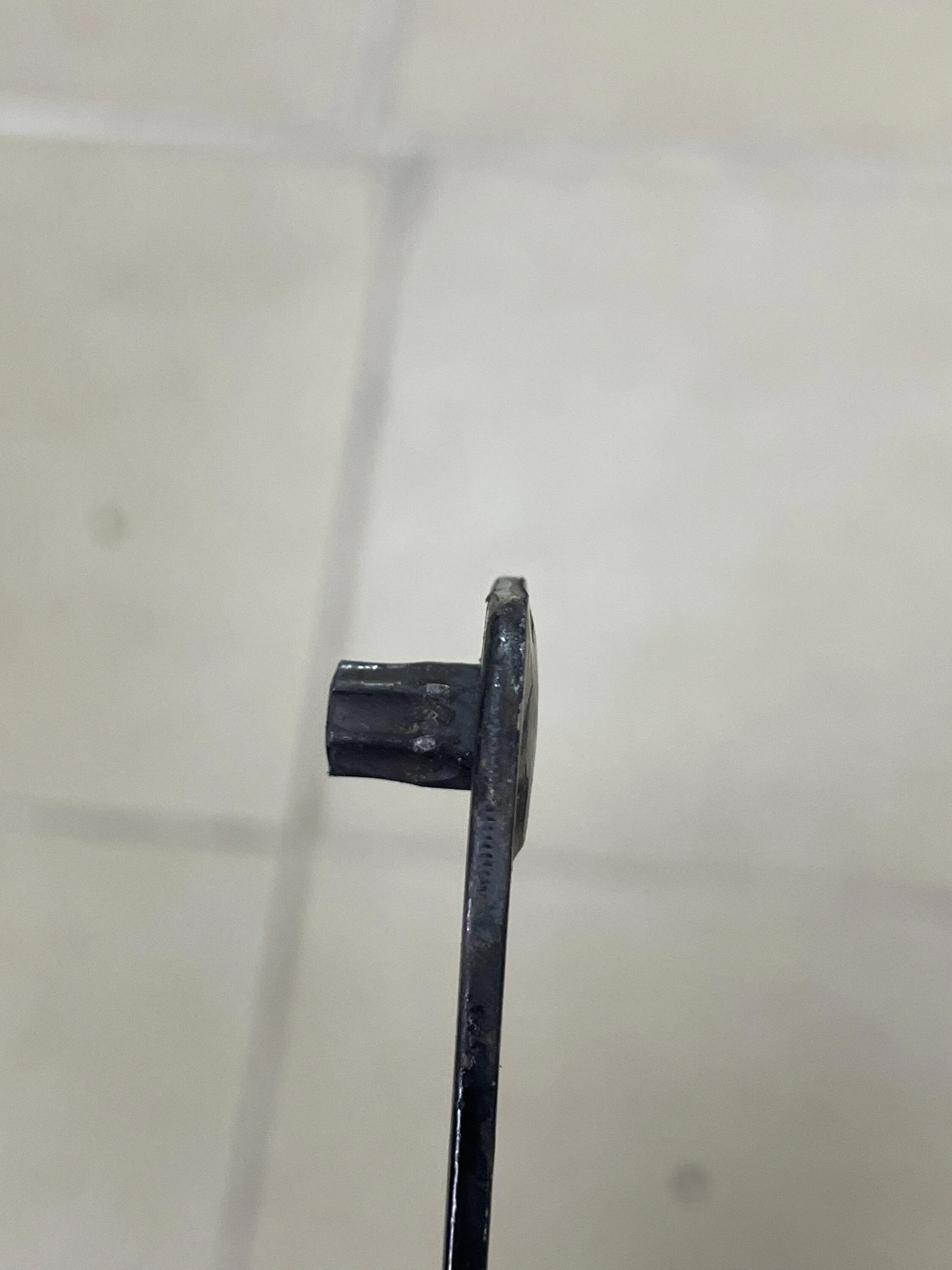

Update: In case anyone having the same issue, I made myself a low profile screw driver to remove the bolts. I cut 10 mm of a T40 bit and welded it to a thin handle.

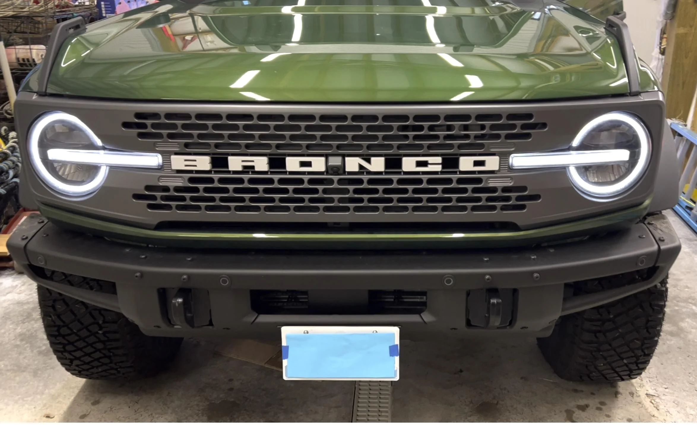

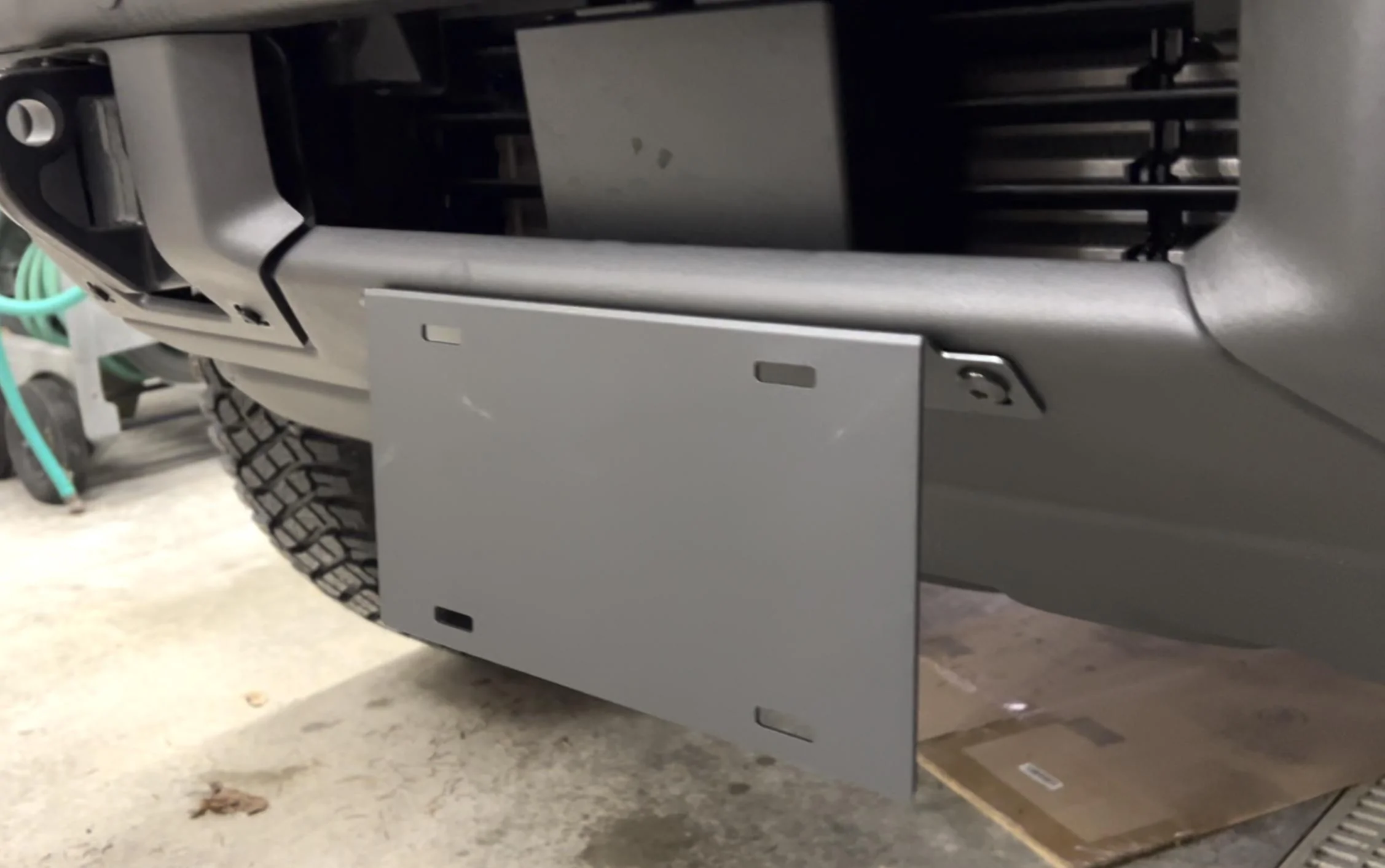

I found a different plate bracket that mounts lower on the modular bumper on bolts that are much easier to access, and it's inexpensive.
