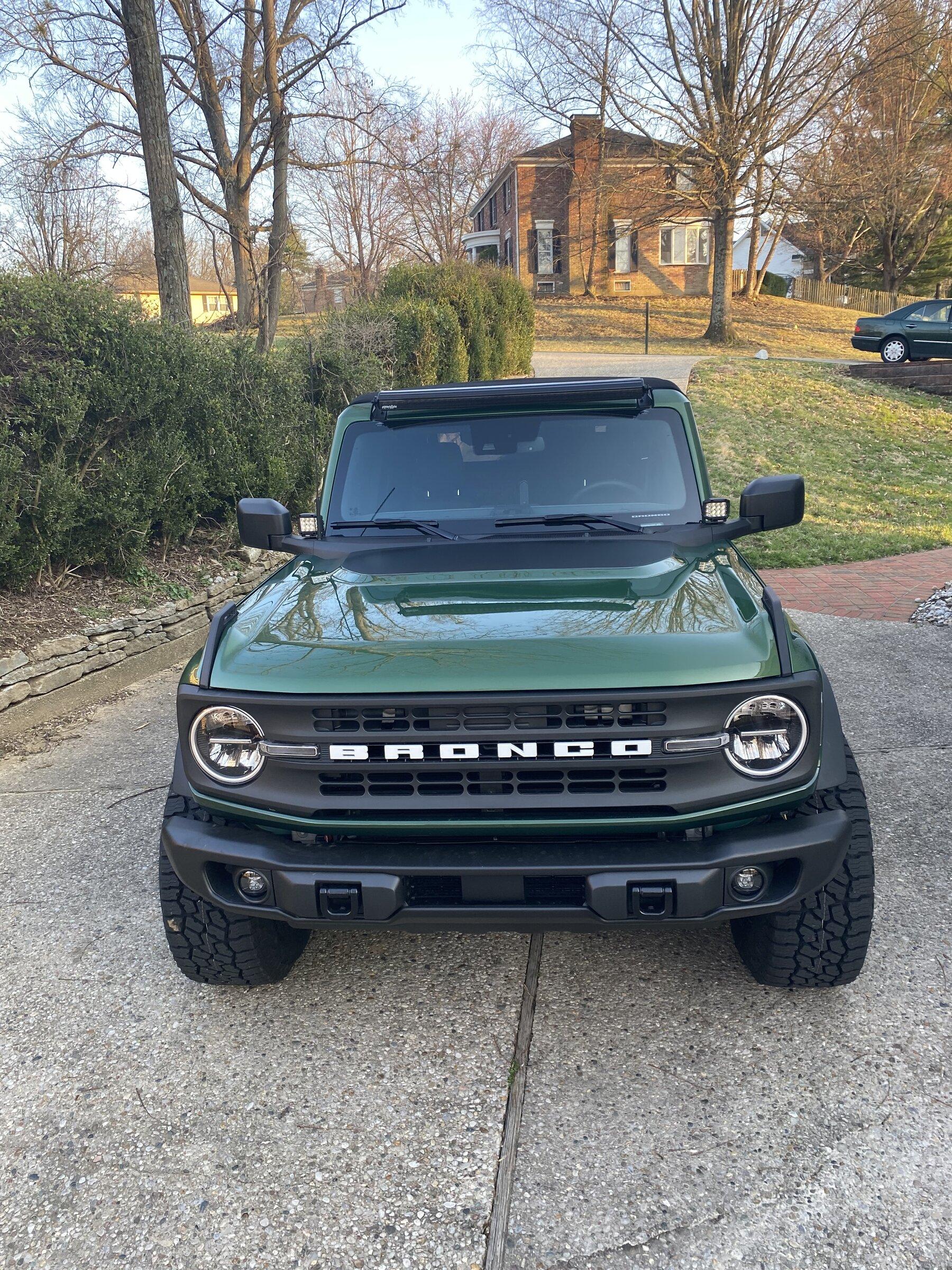

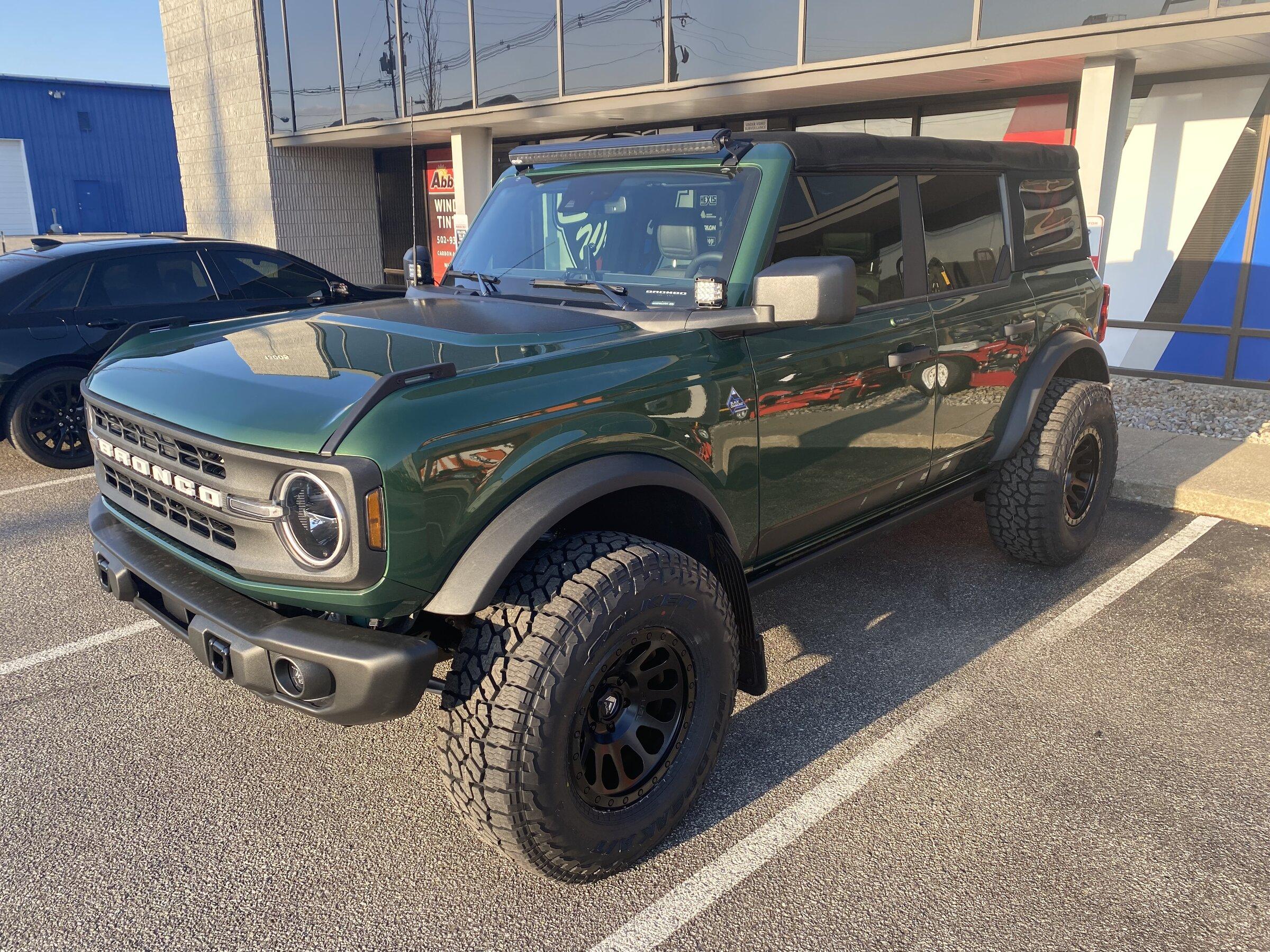

It’s possible, follow the instructions on this video. It was incredibly easy. Use a flathead screwdriver to pop open the plastic trim around the D-rings, remove two of the bolts and loosen the other bolt per side, and scoot the bumper out just enough to clear the front crash bar (should be about 2 inches). I have a lift now but prior to, I ran 35’s on Sasquatch wheels on the stock non Sasquatch suspension.

The bumper bolts are behind the plastic covers (around the shackle), they pop right off, then there are 6 bolts to loosen.
