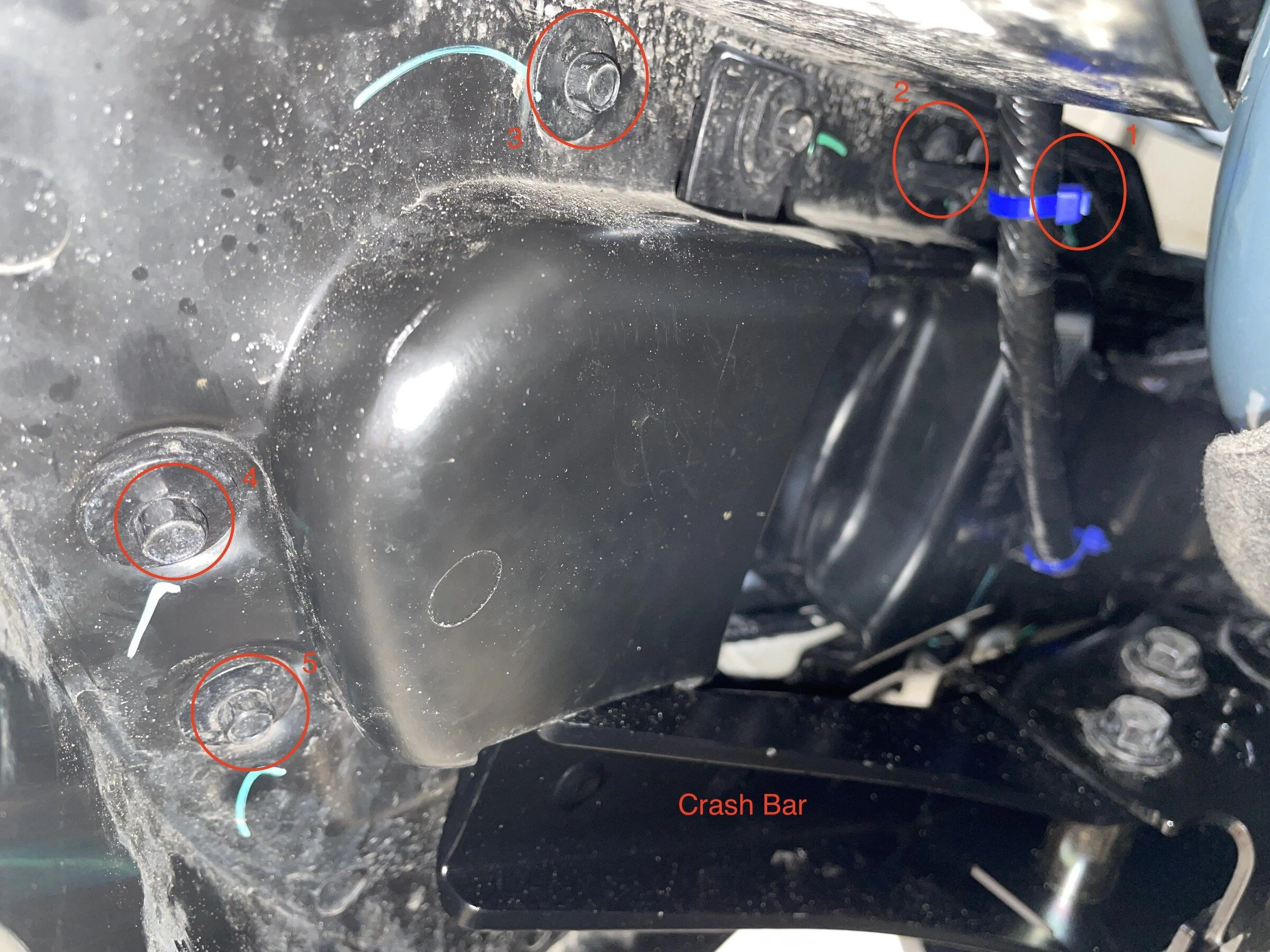

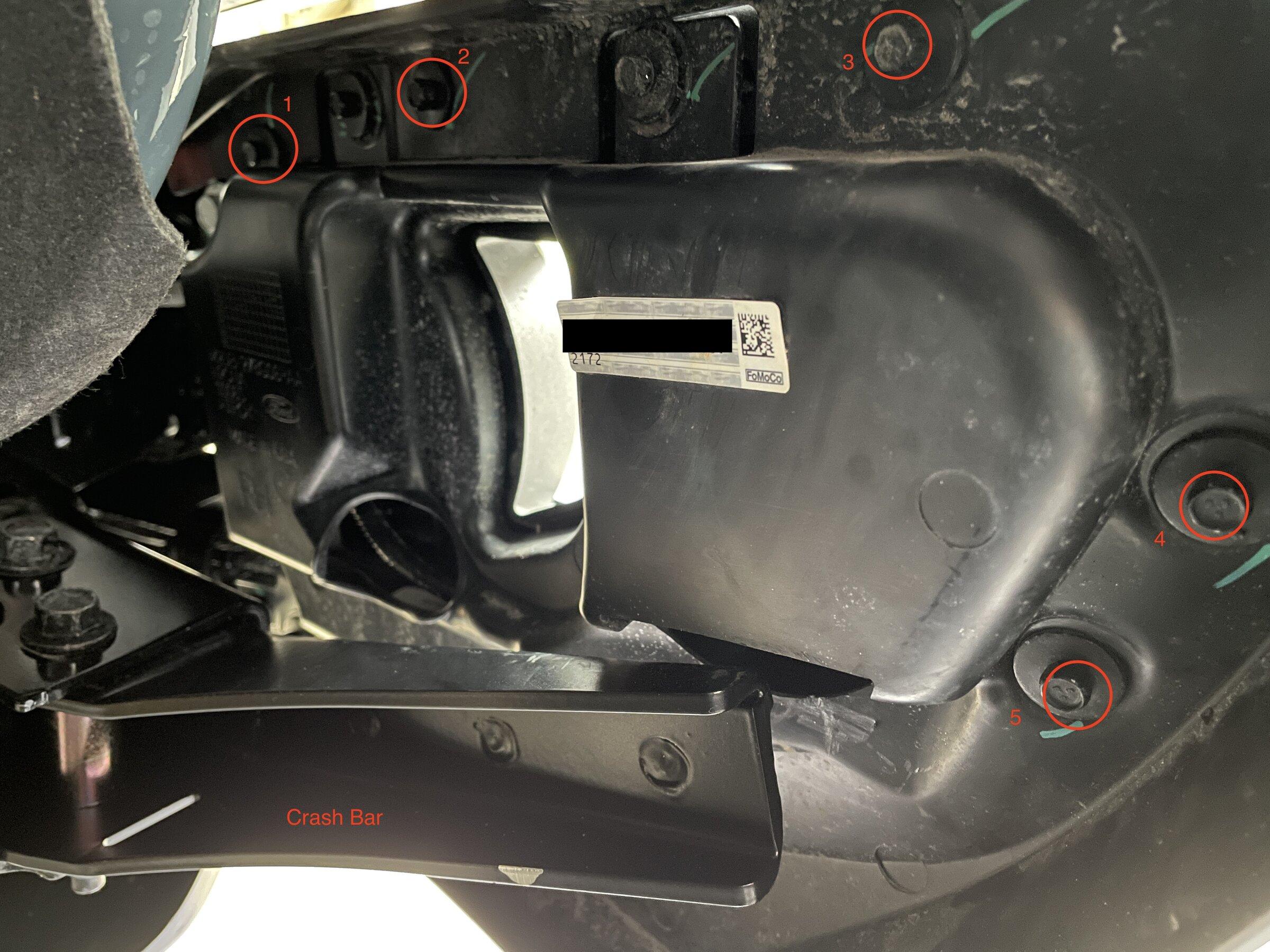

Here is more detail on how to remove, or in my case replace (https://www.4wheelparts.com//p/4-wheel-parts-big-tire-kit-62213/_/R-4WPBR-62213), the front crash bars with a 2022 Badlands with CAPABLE bumper. This was done with the tires in place and on the ground. Here are the general steps with details.
1. Remove the 7 bolts from the plastic end caps on each side of the bumper.
2. On the drivers side you will need to either disconnect the headlamp or clip the cable ties (I clipped the ties)
3. Remove the 2 top bolts from each of the front crash bars
4. Slide the plastic end cap and crash bar out at the same time
5. Place the nut clips back into position
6. Simultaneously slide the new crash bars and end caps back into position
7. Insert and tighten all bolts.
Here is the location of the top passenger 5 bolts that need to be removed. The back ones are somewhat tough to get.

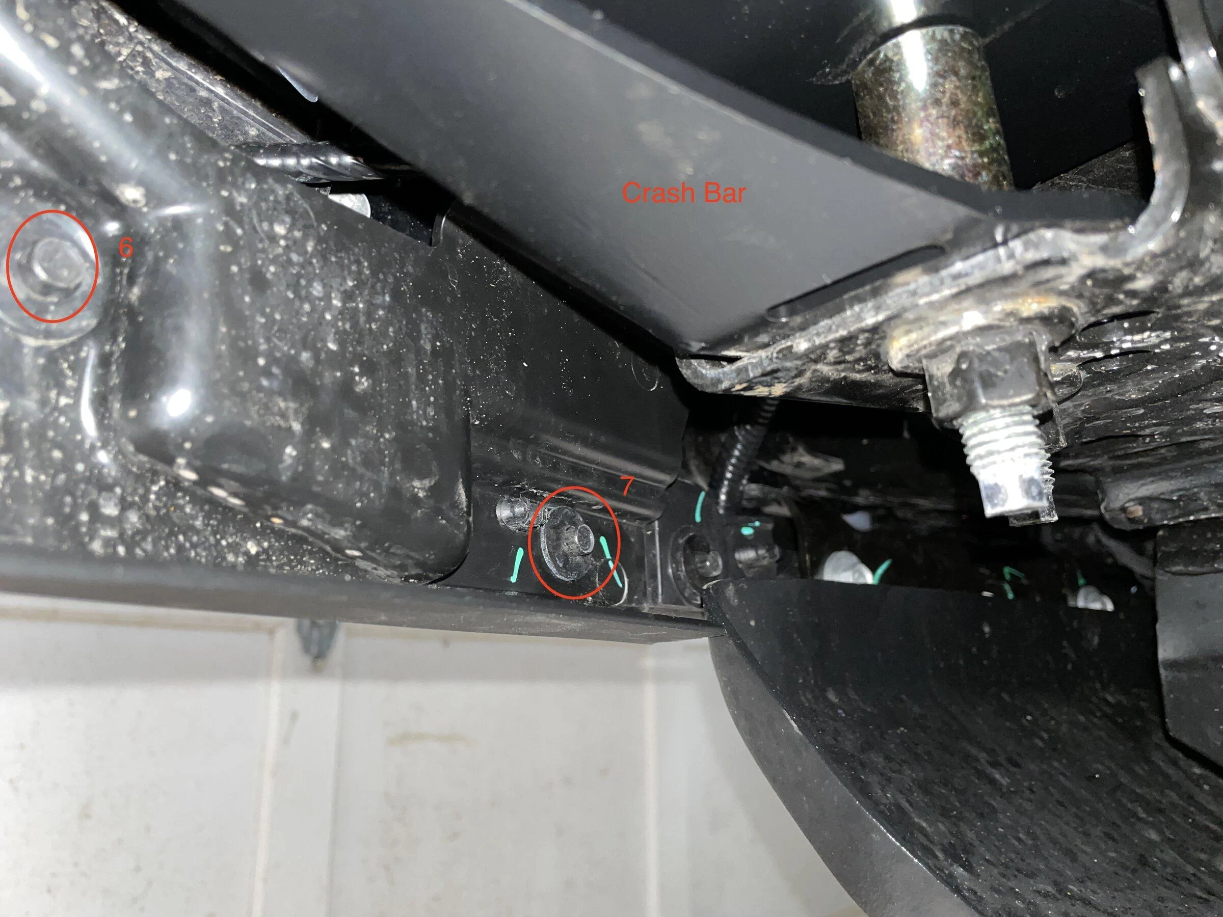

The bottom 2 bolts on the passenger side. You will also need to pry the clip next to bolt 7.
The drivers side bolts 1 and 2 are obstructed by the headlight wiring. I clipped the zip tie to loosen the cable. It's still a tight spot tough.

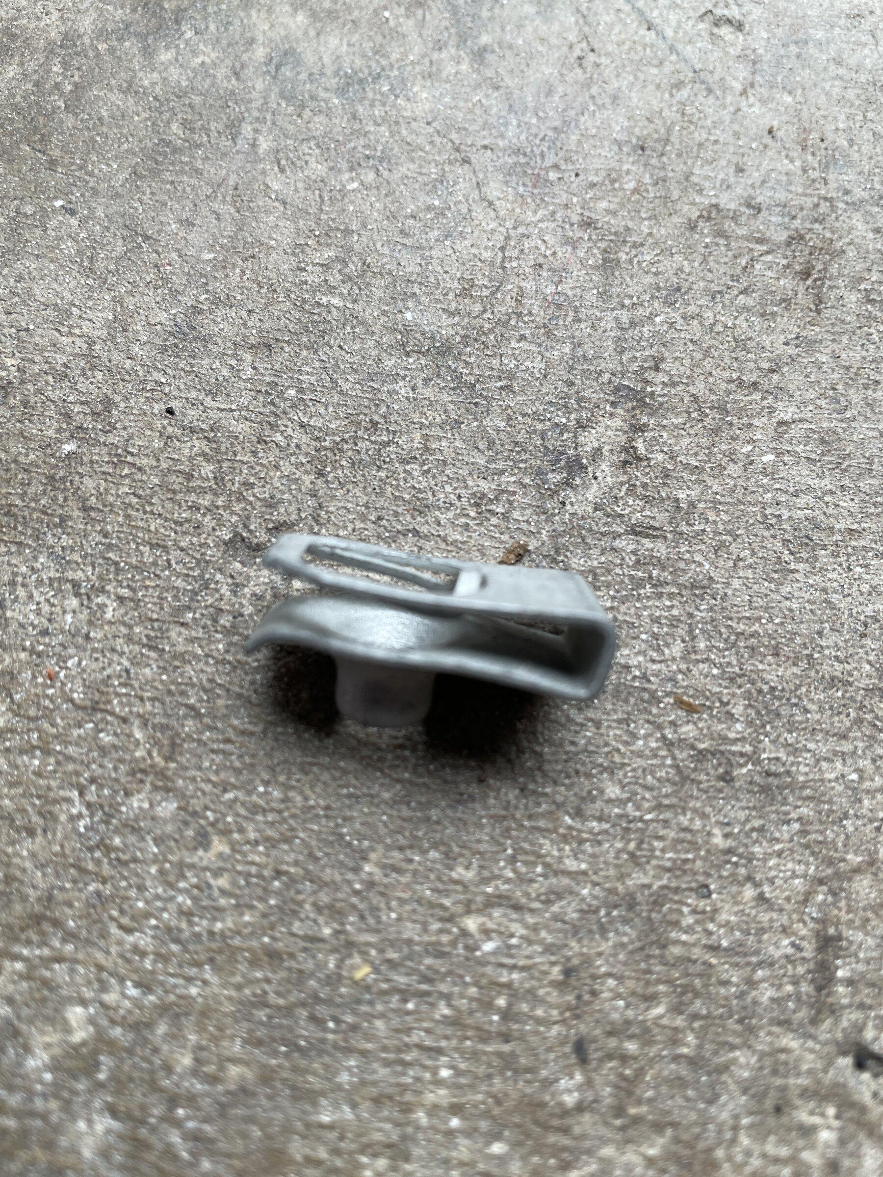

Once you remove the plastic end caps and crash bars you will be left with a bunch of clip nuts which may not stay in place. Gently bend/push the inside tab back with a pair of pliers. Put the clips back where the came from originally and they should remain loosely in place.

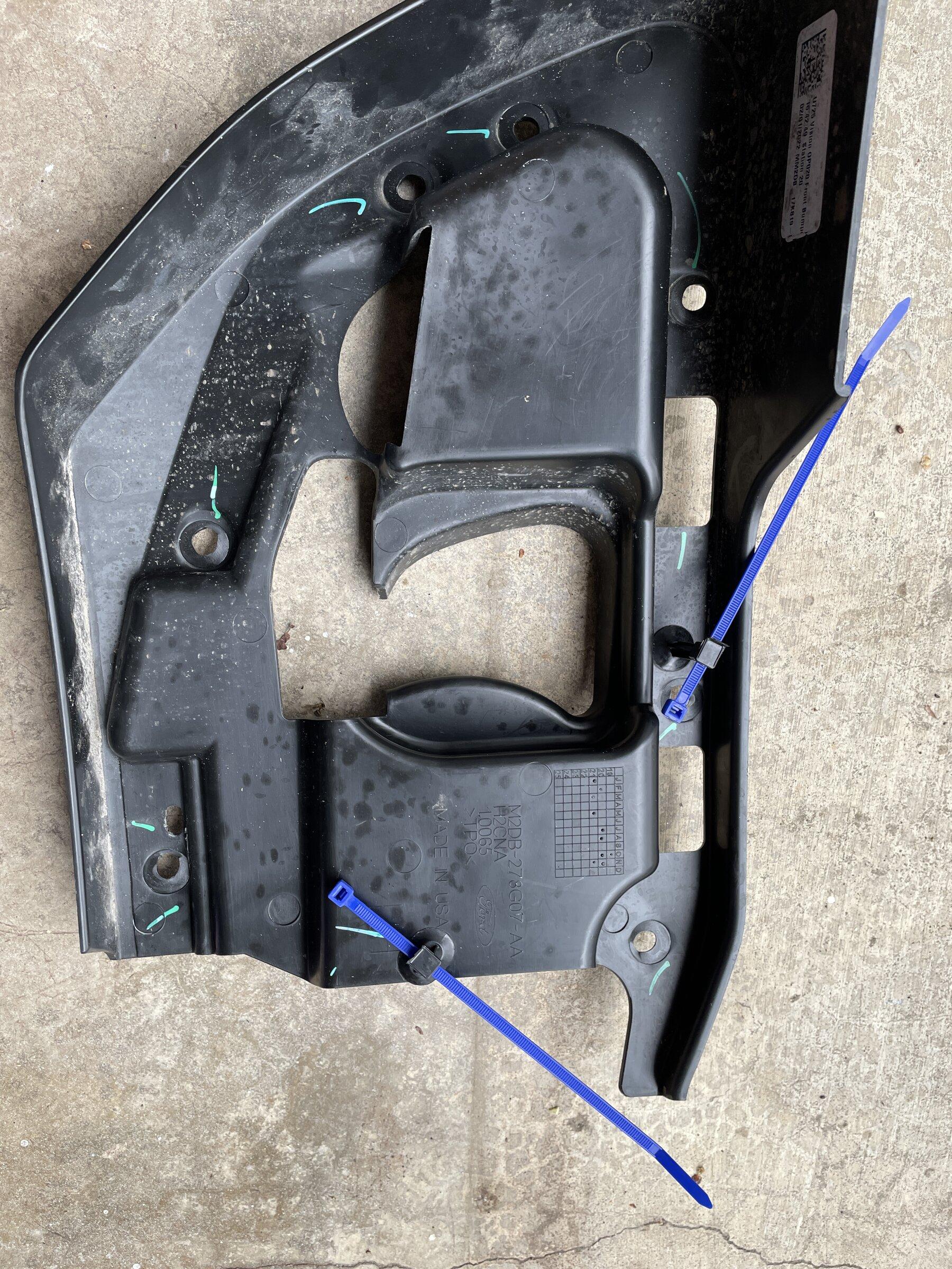

Before replacing the drive side end cap I added zip ties (only had blue) using the original mount points to make it easier once it was back in place

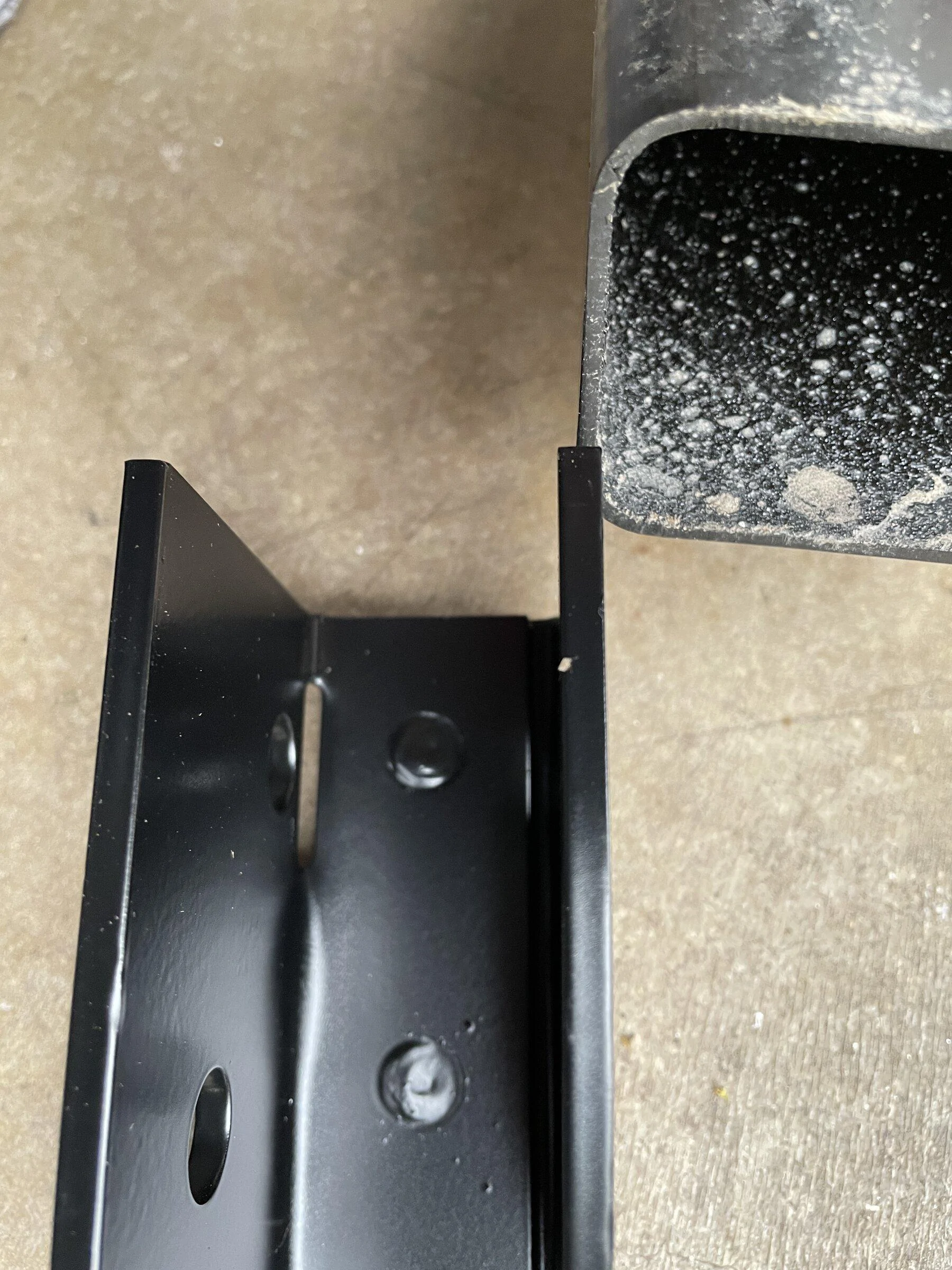

This is a side-by-side of the OEM vs 4WP crash bars. The 4WP is much thicker gauge steel and looks to be well engineered. Rolling the dice since there has been no testing, but it certainly seems like they should do the job.

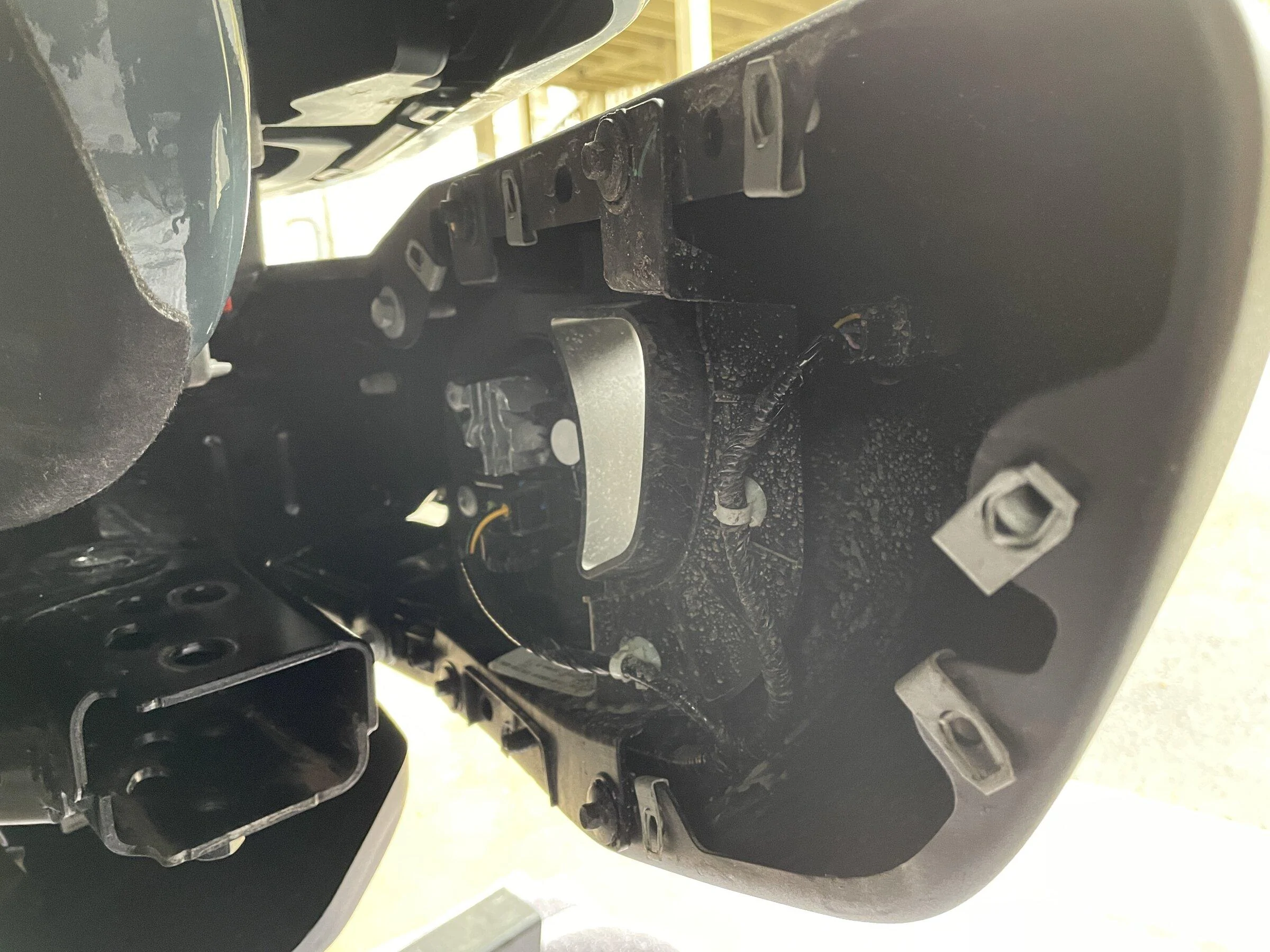

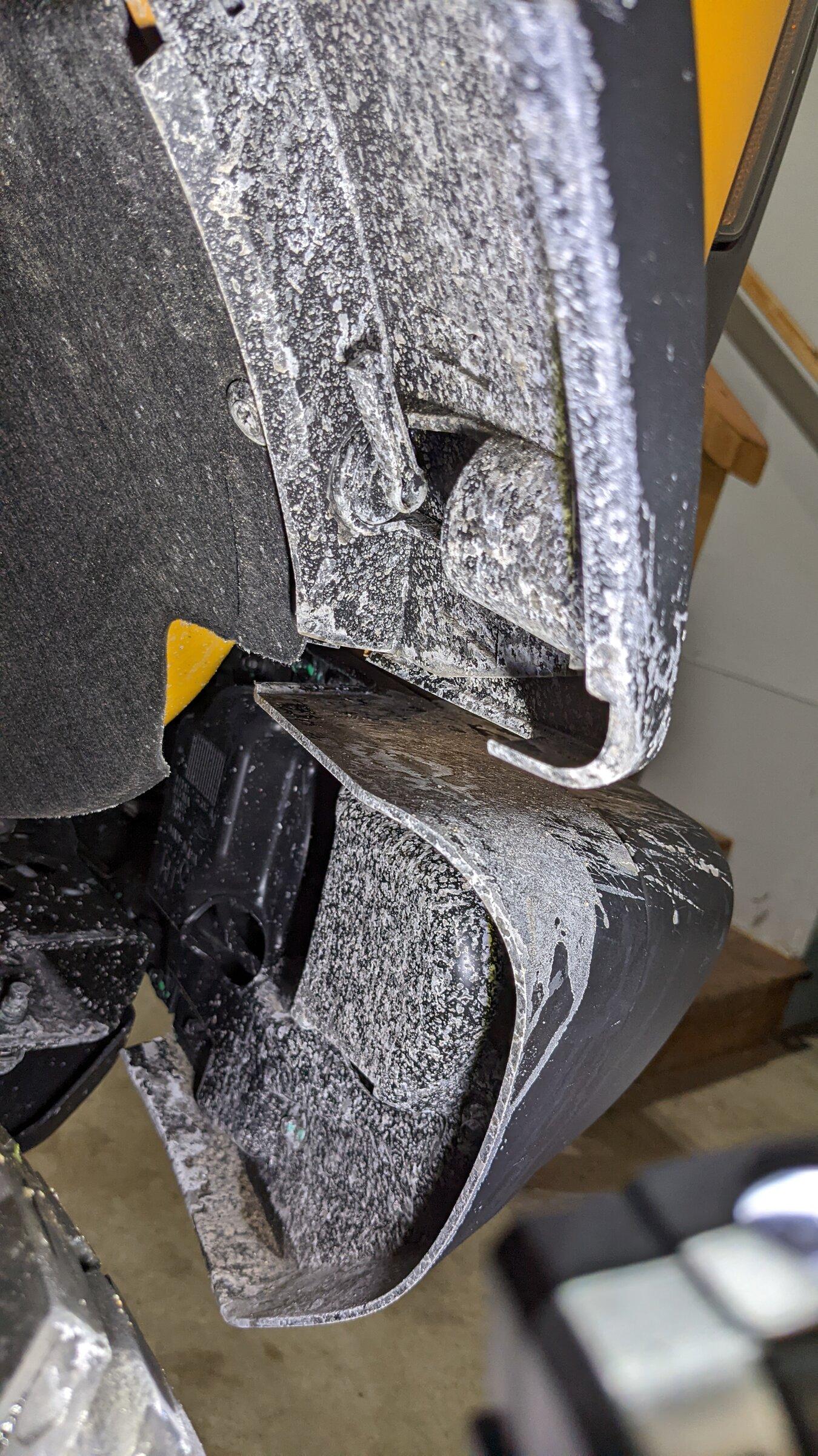

Mine with plastic trim removed …. I kept it off
