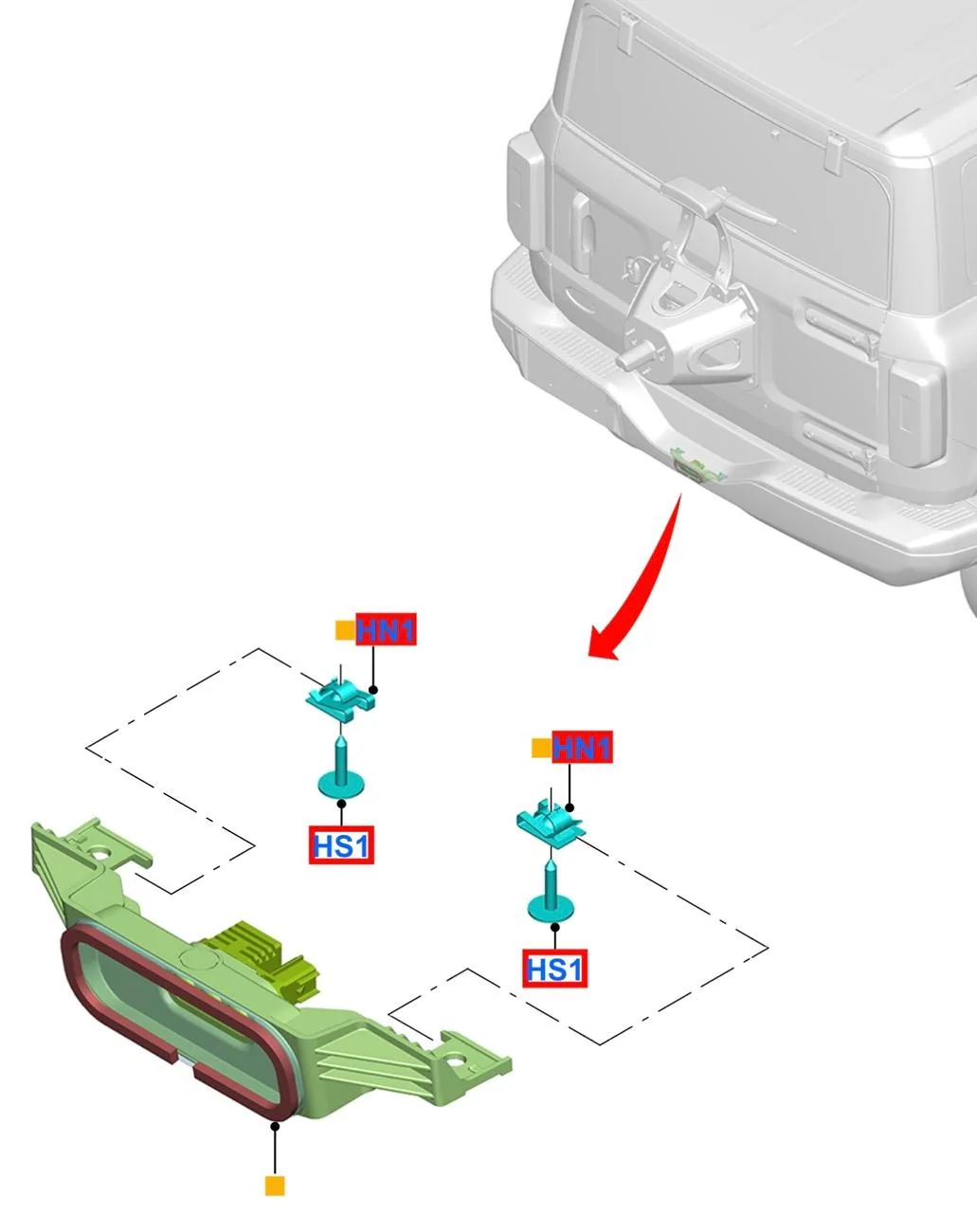

I am ready to attempt this Rear Fog addition.
I already have a -CC switch installed and all Forscan changes made.
I am assuming that M2DZ-15200-A is correct for the Lamp Assembly.
That M2DZ-15K868-G is the correct harness to add the RFL to a Lux package Wildtrak.
That M2DZ-17906-DA is the correct bumper shell with the cut out for the lamp.
What is the p/n for the screws that fasten the lamp to the bumper shell?
Is there a p/n for the bumper cover with the RFL cut-out already in it?
Are there any other parts needed to do it right?
Maybe @Ducati1098 can shed some light on the correct part numbers.
Thanks in Advance!
Ducati1098
10,067
23,464
Midwest
Thanks in Advance!
I can’t see a real picture of how it’s mounted on the bumper or if it uses a different bumper, but here is the hardware:
Screws: W710763-S450B
