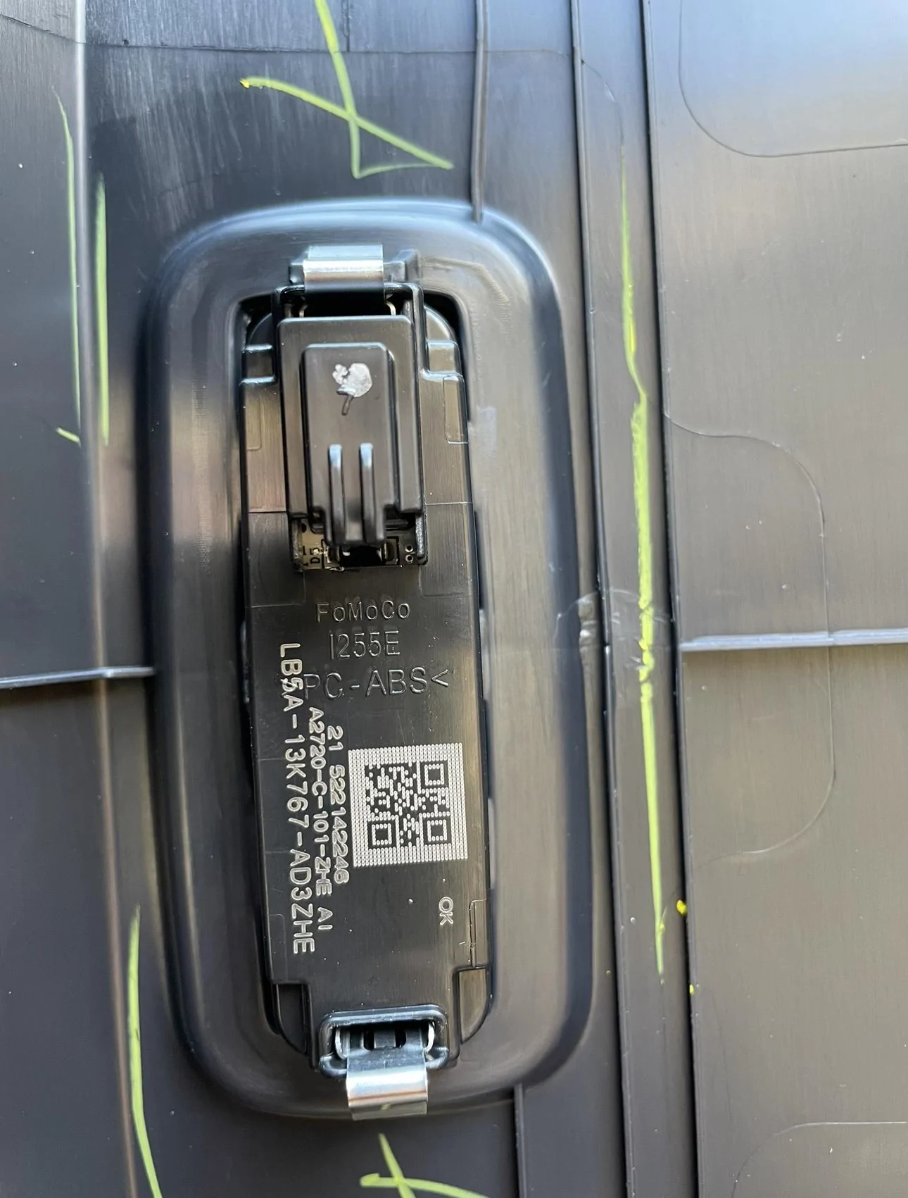

I’ve taken that light off before when trying to add my own interior lights. I broke it trying to pry it out. The service manual has you take the top, speaker pods, and a bunch of panels to get to it. If it’s getting replaced probably don’t care if you break it, just be aware.

Good to know. Thanks. I assume trim tools don't help then if taking the short route and just going straight for the light and not following the manual's instructions?

Nope. I knew what I was dealing with and still broke it. It’s a tight metal clip that you can’t get trim tools on to decompress. Here’s a pic of it.

But we won't need it, right?
