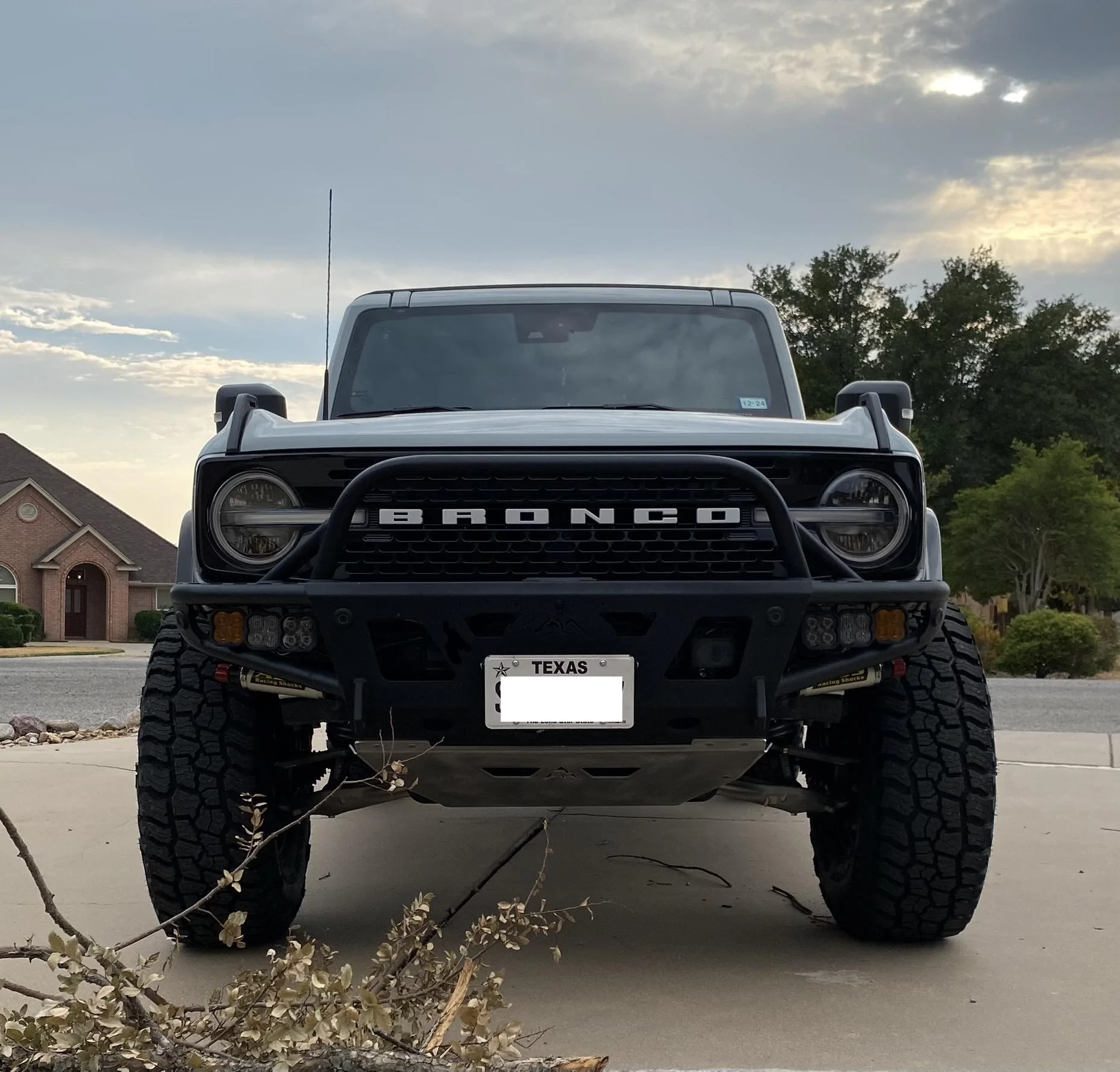

Snapped a few more pics of my SS3’s by themselves. I probably need to adjust the SS3 Max amber fogs down a bit more since I lifted and put on 37’s.

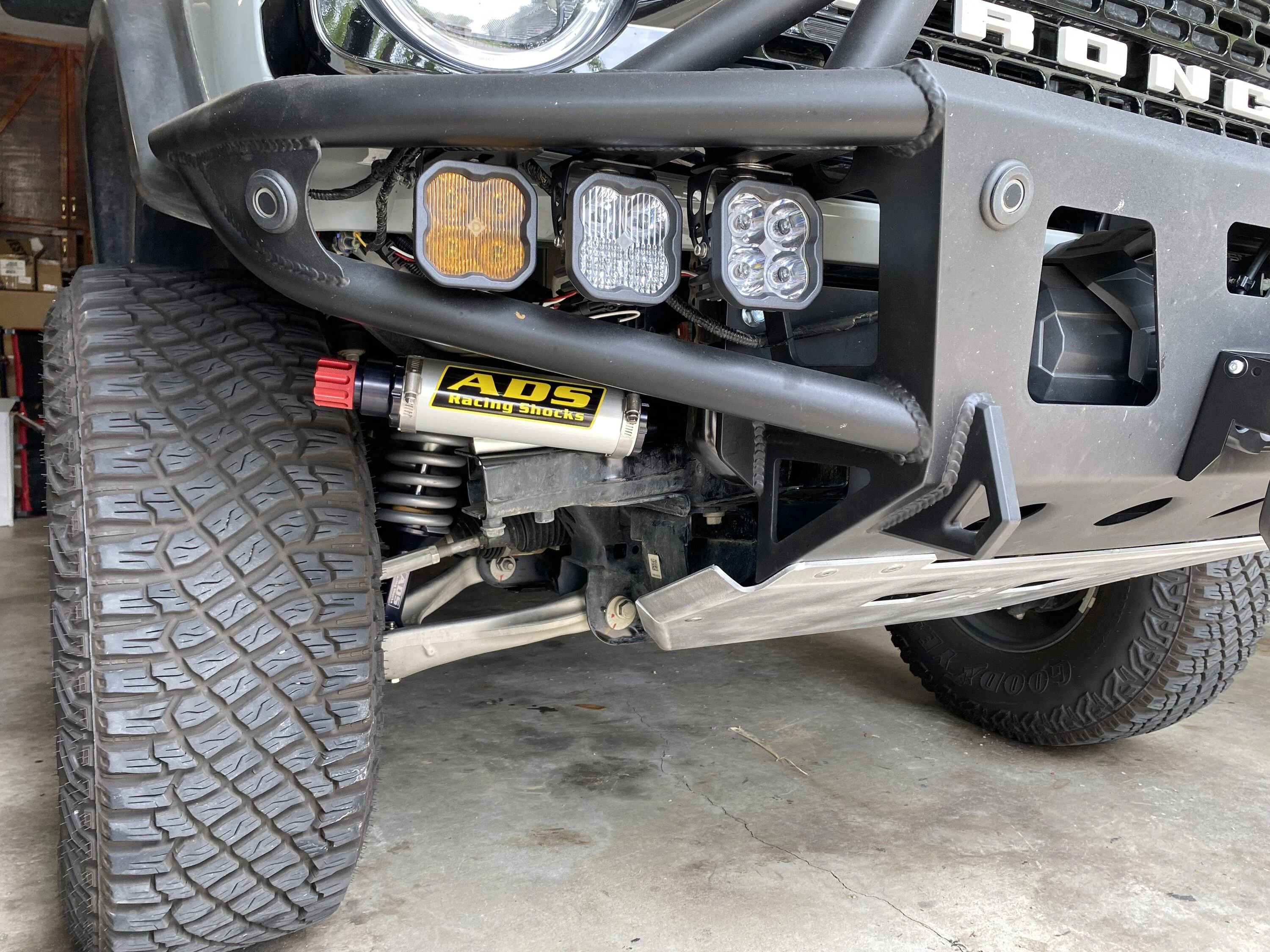

This is how the lights are setup in the bumper:
Ford Bronco Improving low beams with fogs? IMG_6827
Ford Bronco Improving low beams with fogs? IMG_6777
