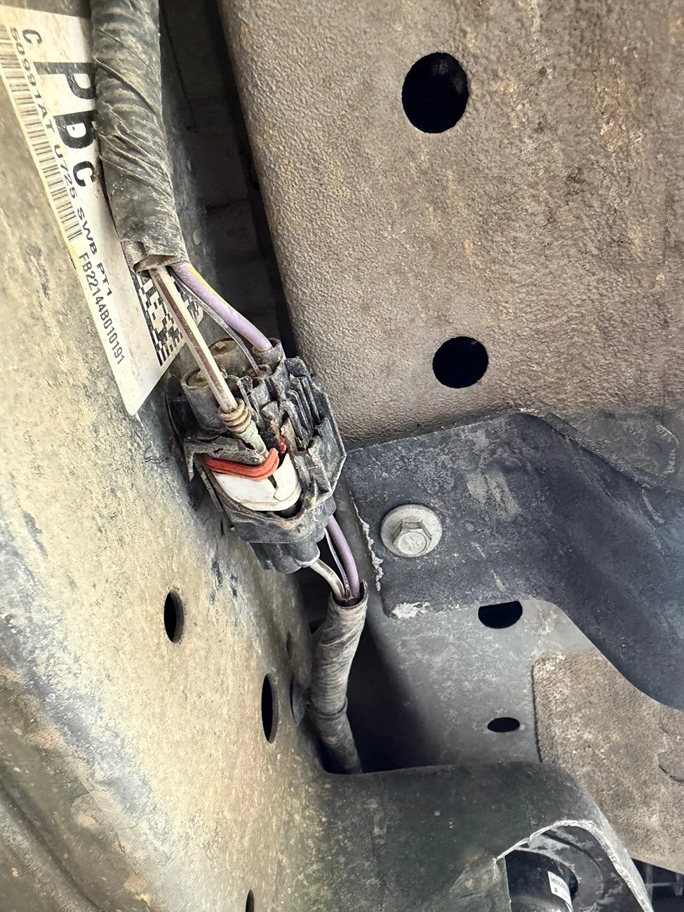

I was changing out my side rails and found a smashed plug next to the frame.
Ford Bronco Identify a plug IMG_6953
this is under the right side next to where the type Temple hold on to the body.
This is a 2022 Wildtrack two door.
Can anyone identify what plug this is? I’ll need to replace this.

Just wrap it in some FlexSeal tape and call it good. Or some of that liquid electrical tape that @SierraBronco loves. I mean, it's still working now... why tempt fate trying to fix it.

I mean, you could repin a new connector on there, but if it were me, I'd just watertight that thing up and call it good... and if I ever needed to get in there again, then I'd repin it.

Absolutely. Repinning a connector on a bench is one thing. Doing it on your back with wires holding the receiver in an awkward position while dirt is falling in your eyes and your abs start to cramp is a whole different level of “fuck I should not have messed with this. But now I have no choice but to follow through”

Liquid e tape has changed my life! And doesn't that wiring have somethng to do with transfer case shifting? I'd Liquid tape it, dry, then wrap.

Replace it. Along the frame is not where you want exposed wires. It will create problems. Looks like larger gauge wiring. These new cars do some weird stuff when their are corroded wires.

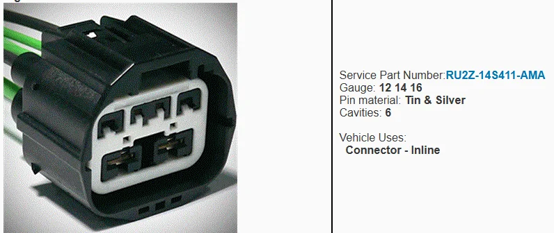

Looks like Ford only offers the female side of the connector as a replacement pigtail.

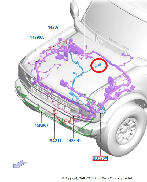

For the male side connector, you would need to buy the corresponding harness going towards the front of the vehicle which would be MB3Z-2B325-GC
