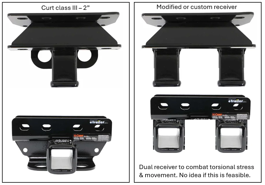

Again still dreaming but maybe a custom receiver would be needed or beneficial to help with the leverage and torsional load.
Ford Bronco Idea - hitch mount rack for 3 jerry cans. IMG_5315
But that would negate the swing out so this is crazy talk.

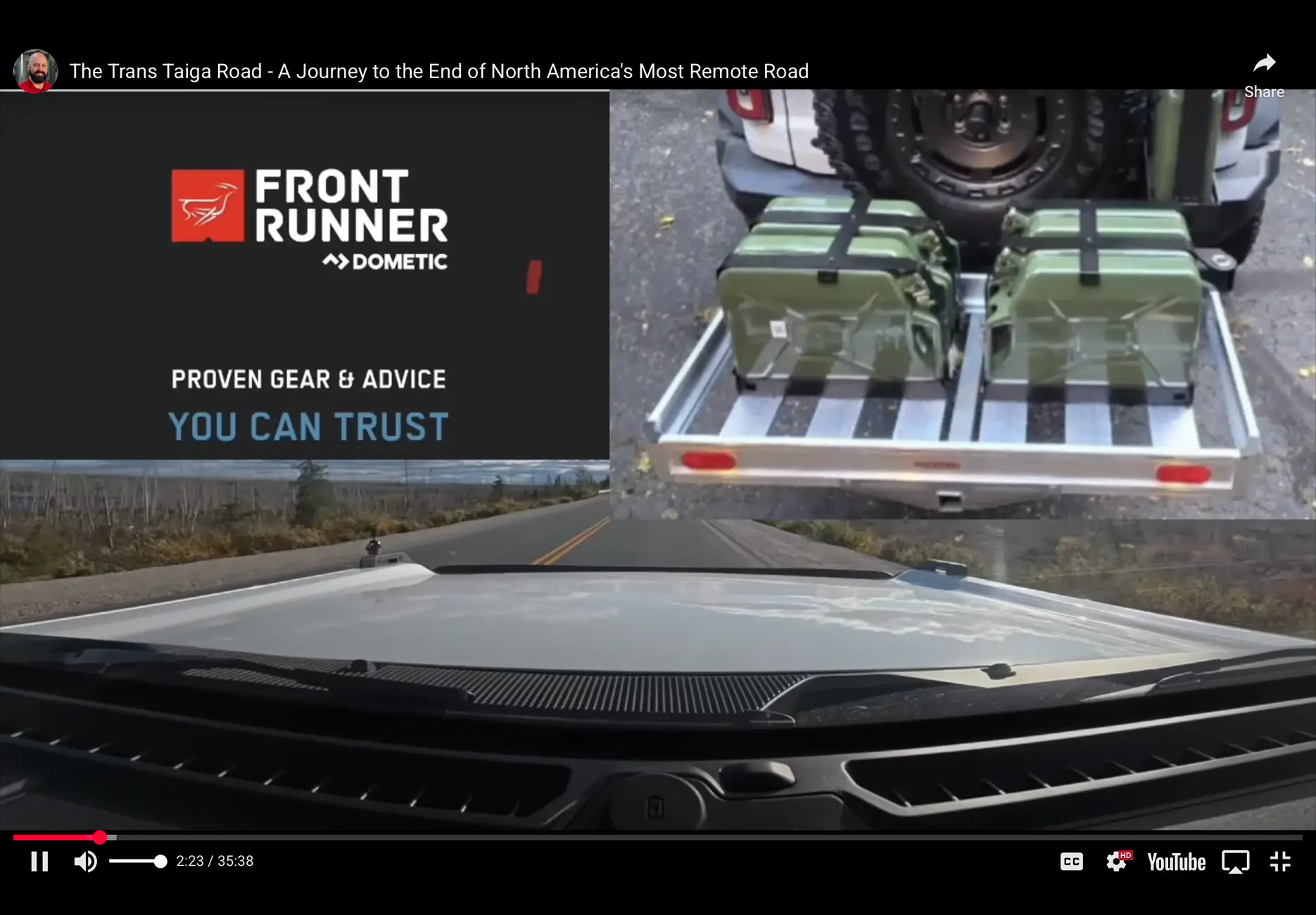

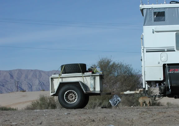

That's a lot of weight to be hanging that far back from bumper.
Especially with all the other gear you will be carrying in the back of Bronco
Perhaps you should consider a small off road trailer.
(Those are 33" tires for scale)

Yup! I have the Turn HD tailgate reinforcement. I’ve considered this type of tray mounted above the tire. However 15 gallons is bloody heavy. Plus my 37’s. I should also say that I need to retain the ability to carry a spare/wheel mounted trash bag. Gotta pack out the wag bags.
Remember the Pintos, gas at the rear and low, is a dangerous combination. Whatever you do, mount it high and protected. It is not just the other guy you need to protect.

Thanks for the suggestion! Dragging a trailer through tea pot canyon would be spicy. Thanks!

In a word, no.
I've got professionally built double swings on two built rigs. The Wagon can carry two Jerry's, the LX three. Both have been to Doll House, (the LX twice, and she's a thirsty piggy, 15 extra gallons on those trips).
Problem is, you get that much weight, cantilevered off the back in order to clear your rear tire. The donkey kick it will give will be significant, and you'll have to triangulate back to the ends of the bumper for rotational forces.
I haven't looked as I don't plan on using my Bronco that way off-road, but does no one make a legit swing bumper that holds the spare and cans? It is the only way to do it right other than a sub tank. And good luck on that with the seemingly low demand for 2 doors.

Thanks for your feedback. I hear ya on the leverage involved.
Yes, there are several rear bumpers out there that can carry twin jerry cans. None that can handle three without additional mods. Plus to be honest none of them have struck me as “oh that’s the one for me”.
That said the Bronco’s body is so narrow that the space between the tail lights is limited. So a triple Jerry would be too wide with a 37. Maybe even too wide with a 35.
Plus I don’t want the weight of a full steel bumper full time. The angles on the 2D are so good I’ve yet to hit my rear bumper on anything more than just a wee love tap. It’s not like my old days where a high clearance rear bumper would dramatically change a Tacoma’s offroad angles. So the investment versus benefit is lacking.
I may just pretend like it’s 1970 and toss some fuel cans in the back for the dirt sections only 😎
