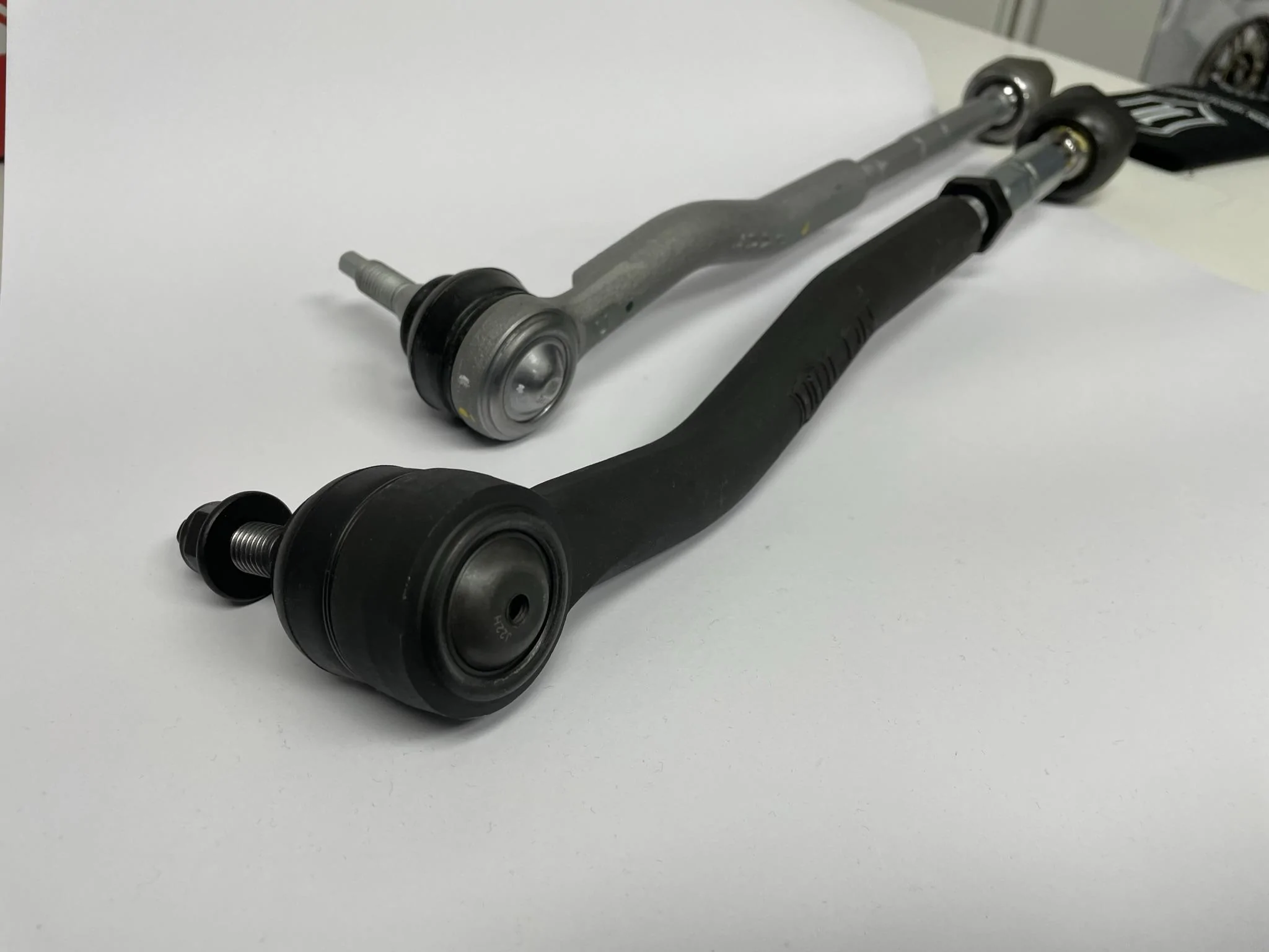

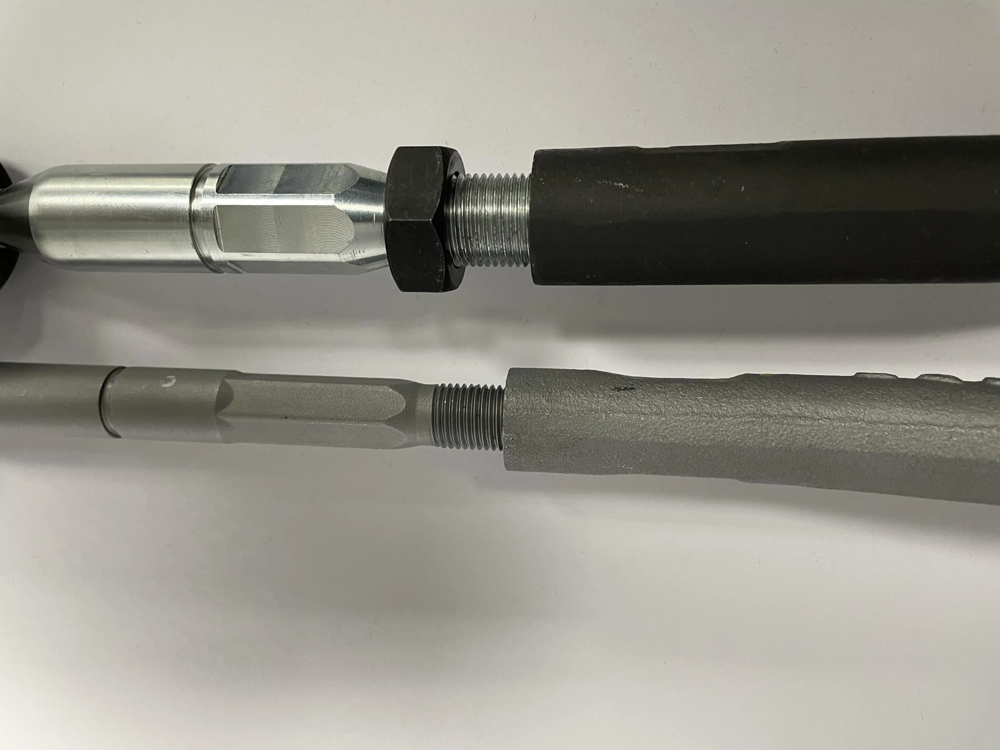

Hey guys I thought I'd post a few spy pics of something we've been working on here at ICON that we've hinted at elsewhere. This is our Extreme Duty Forged Tie Rod, shown in these photos next to a stock Bronco tie rod.
The adjustment threads, where we've seen most of the failures happen on stock tie rods, is 18mm versus 14mm on stock Bronco tie rods.
The outer tie rod is forged steel and has the same bend as factory tie rods for fitting all of the stock factory wheel diameters and offsets, along with just about any aftermarket wheel.
The tie rod end joint is beefier, metal on metal and greasable. It has the same operating range of angle as the stock unit.
The inner ball stud is machined from 4140 chromoly.
Not shown but the tie rods will come with a boot and other associated bits. These photos are of our first prototypes, which we will be displayed at the SEMA show in a couple of weeks. If you're going to be at SEMA, look for them in the ICON booth or in the New Products Showcase if you'd like to check them out in person. We're thinking the first production run will be done and ready to ship sometime in January. Pricing should end up somewhere in the $350 range for the complete kit (both sides). These will work with all HOSS 1.0 and HOSS 2.0 equipped Broncos (basically everything except Bronco Raptor and HOSS 3.0-equipped Wildtrak).
