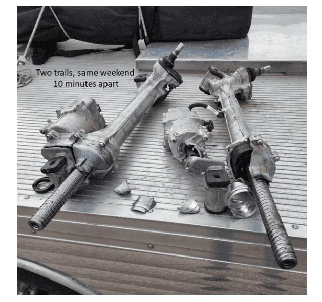

The proof is it’s engineering 101. The point of failure on any design is the weakest part. In the case of the steering system strengthening the tie rod is going to put stress on the steering rack. It’s electric rack and pinion. Why do you think on the upgraded suspension the rack is reinforced upgraded as well.
Show me the racks that have failed because of upgrade tie rods.

The BroncBuster guy has broken several. Not exactly sure what the circumstances were where he broke but it's definitely a case where he beefed up the tie rods so other stuff started breaking instead.
Stage lll heavy-duty passenger billet aluminum housing – Broncbuster (broncbustertx.com)
we should really stop using him as a benchmark...he's an anomaly. He's running 40" tires, lifted to the sky and he abuses the ever living hell out of the Bronco. He's not your normal user.
Wow! Hey, you don’t have to take anyone here’s word for it. Not the guy who works for one of the top aftermarket component shops in the world, nor the anticdotal replies from others on the forum.
Go on out there with your hardened tie rods and remember, “you don’t care bout no stinking Steering racks! The OEM one in your Bronco; it’ll drive ain’t it?” Nope, you just go out there and bash them little old boulders cause your Bronco is big and bad and you’re basically an Ultra4.
Truly appreciate your gracing us all with your expertise on the subject matter. Sorry that no one hammered out a PowerPoint slide with data, peer reviewed research, and pics. Cause you know, if there ain’t no pics, it really didn’t never happen! :cautious:
Feel better man!
Jdyount
Jason
1,065
3,019
Kansas
2021 Badlands
I agree, I do. Personally I think he breaks stuff intentionally so that he can market over-priced fixes.
That being said, this is the example where that has happened. I'd like to hear if anyone has ever done it with 37s.
Feel better man!
I have no idea what this rant is about. You're losing it man.
