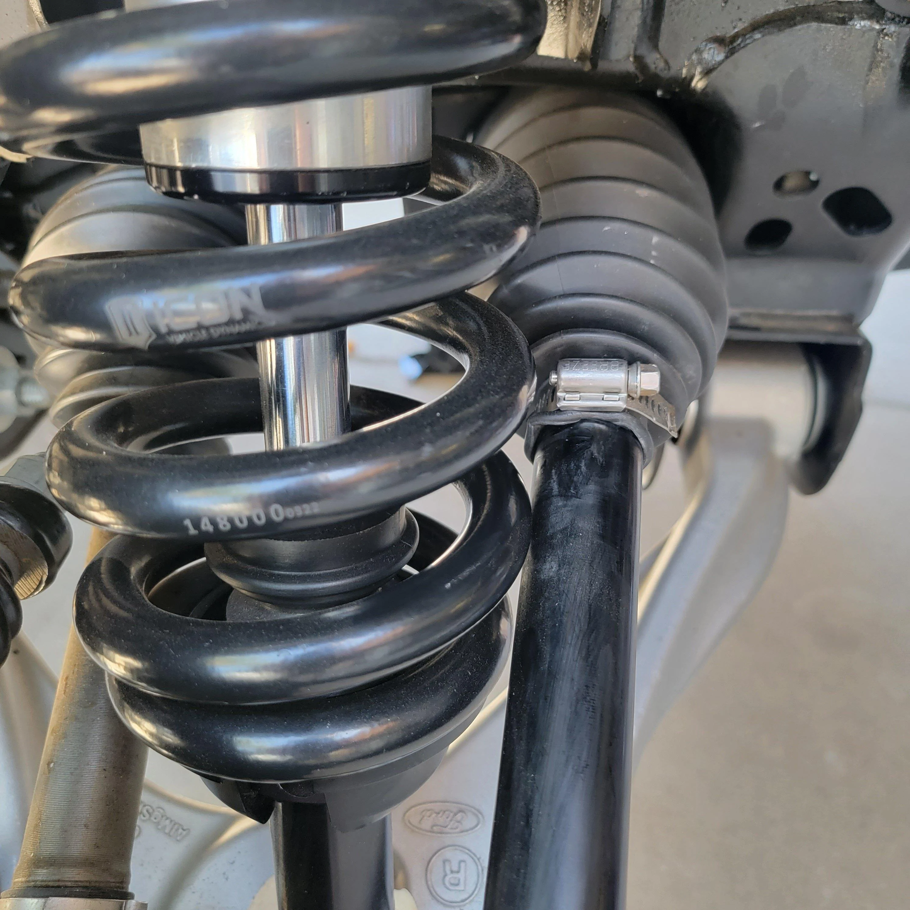

I went to the icon facility in riverside today, they added the fix to my bronco. I’m happy to report at full lock I am not touching the springs. I want to shout out to the team at Icon for the assistance, while I’m sure we can all agree this is not exactly what we signed up for, I’m glad to see them step up and try to take care of the problems.
Full lock drivers side

What does your sway bar look like now?

Think you can get a brace or at least a sleeve on that?
I think a thin sleeve would work maybe even the chaos one. Broncobuster would be tight. I honestly am not going to brace, I’m content to let the tie rod break rather than my rack.
