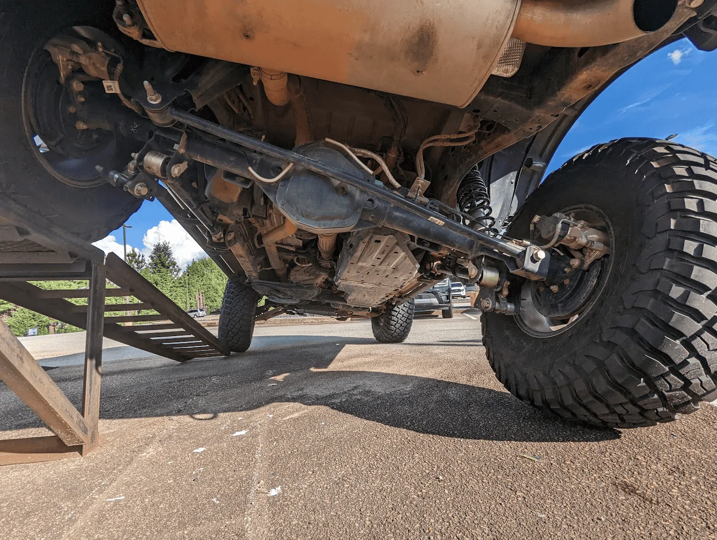

As bad as the pics look at a static load, I’m hoping the fix takes into account how things are under load while articulating on the trail.
Had been debating carrying an extra tie rod and tools, but I feel it’s a necessity now.

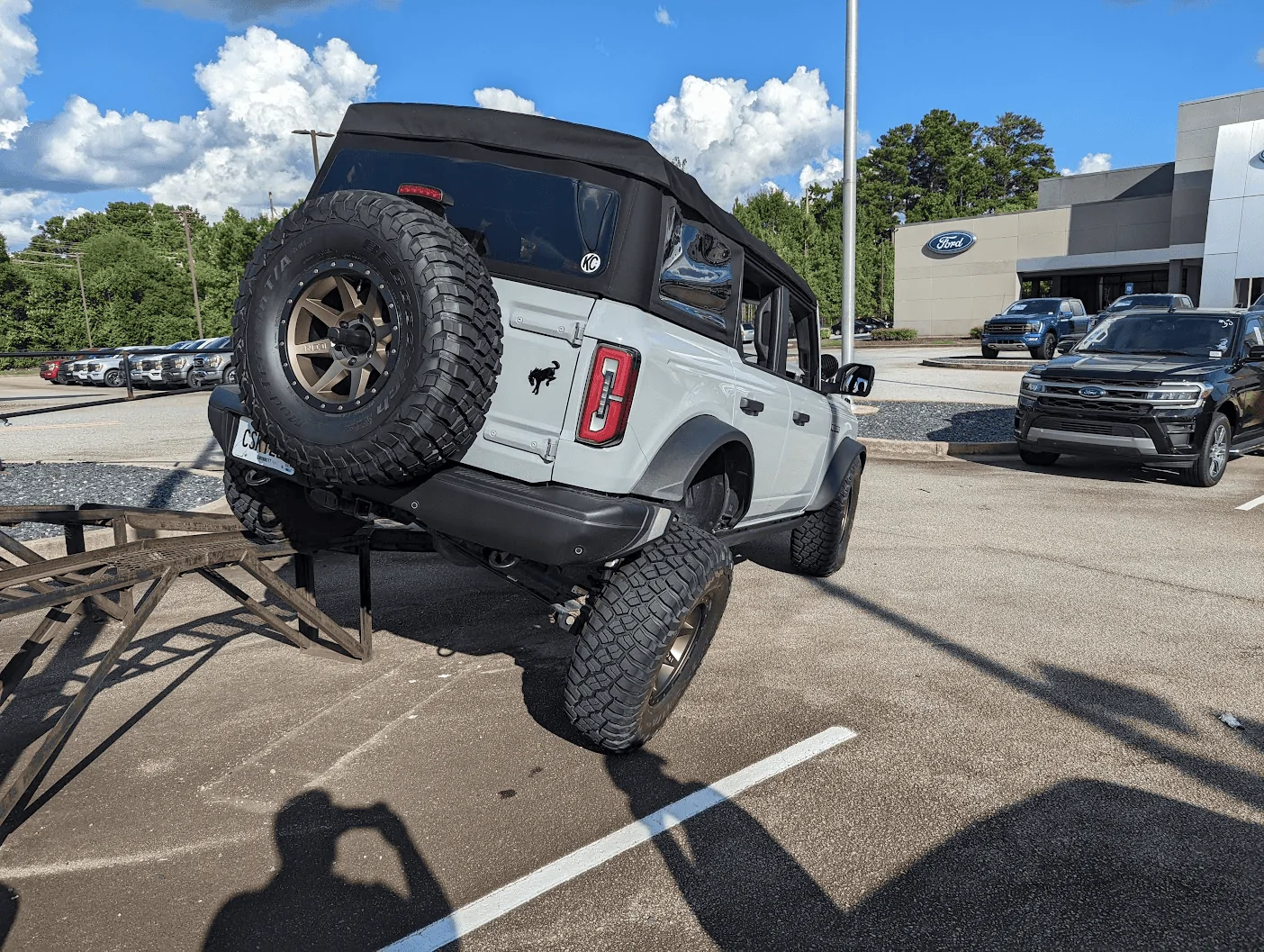

How about rear brake lines? Are y’all using longer lines or relocation brackets?
This is as far as my lines can go, and the tire is not off the ground yet. I don’t think I want to lift a tire as is.
Off the ground I have a tiny amount of play… Badsquatch so I don’t know if there are any differences.

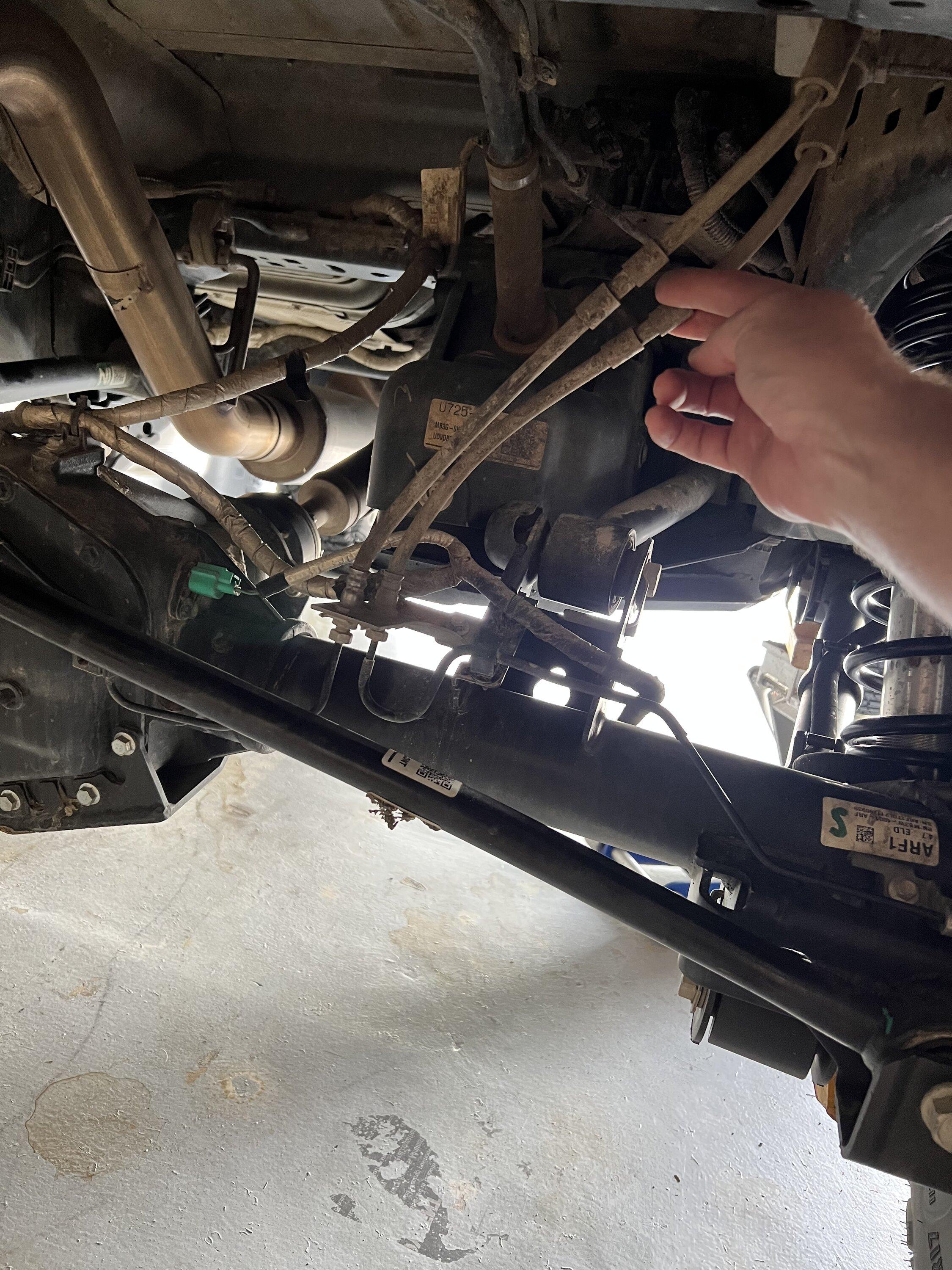

While making some adjustments under the rear of my bronco I noticed that my brake lines are also maxed out before the tires even come off the ground. Definitely needs some longer brake lines or a new bracket.
I have Camburg trailing arms and Icon track bar, which does help with a small amount of articulation, so maybe my axle is able to move a little more than stock.
I am looking at getting the Rockjock track bar relocation bracket as my track bar is at quite an angle.
I've looked for brake line relocation brackets. RC has brackets they include in the 3.5 and 5 inch lift kits, but don't offer them separately. I've email them to see about purchasing separately but haven't heard back from them.

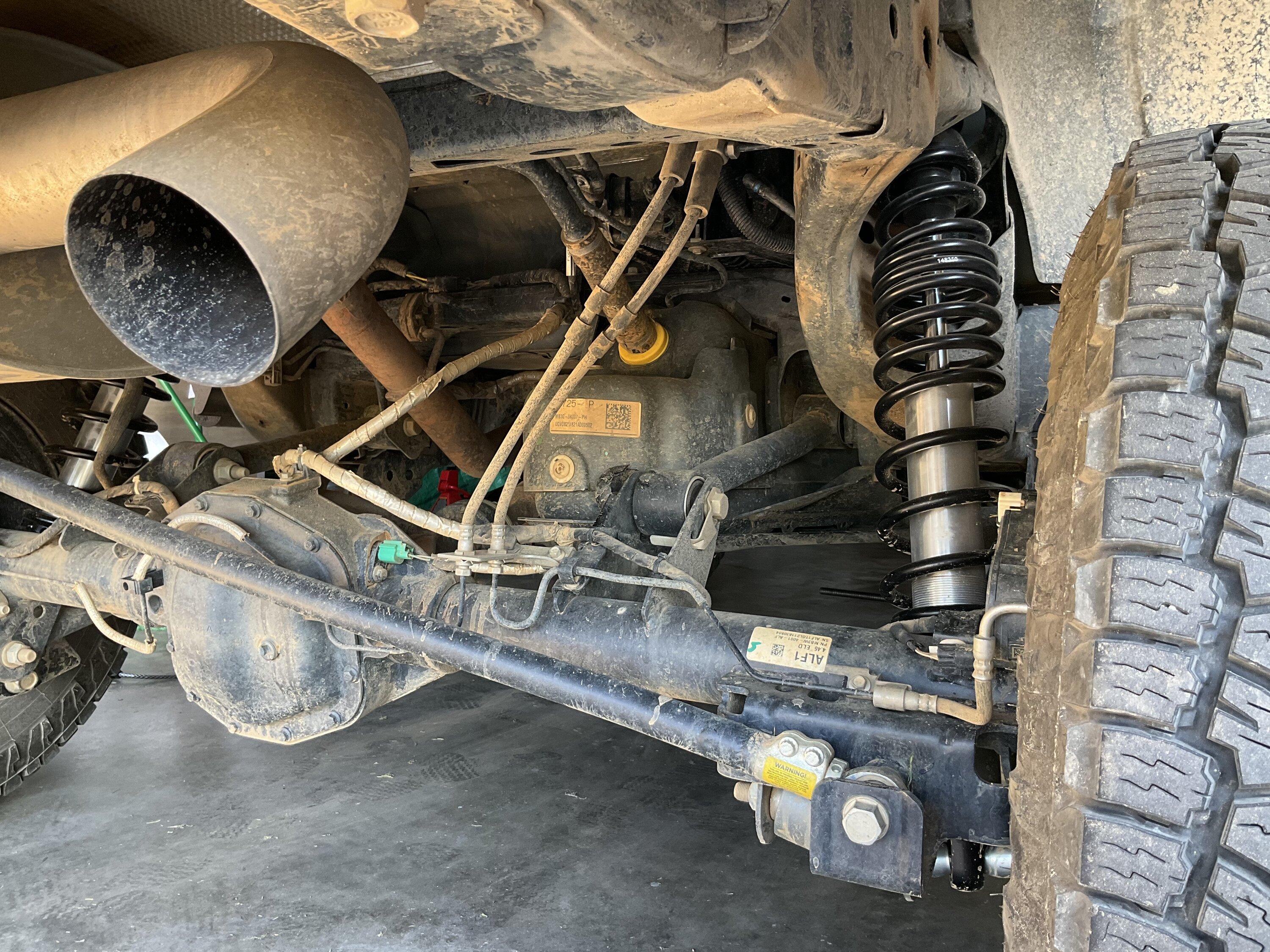

Flexed it as much as I could at work today. brakes lines seem to have plenty of play. If I got a tire in the air it might be close though.
I think where you’ll see issues with the brake lines is if you have entire rear is at full droop.
