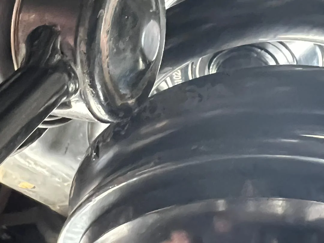

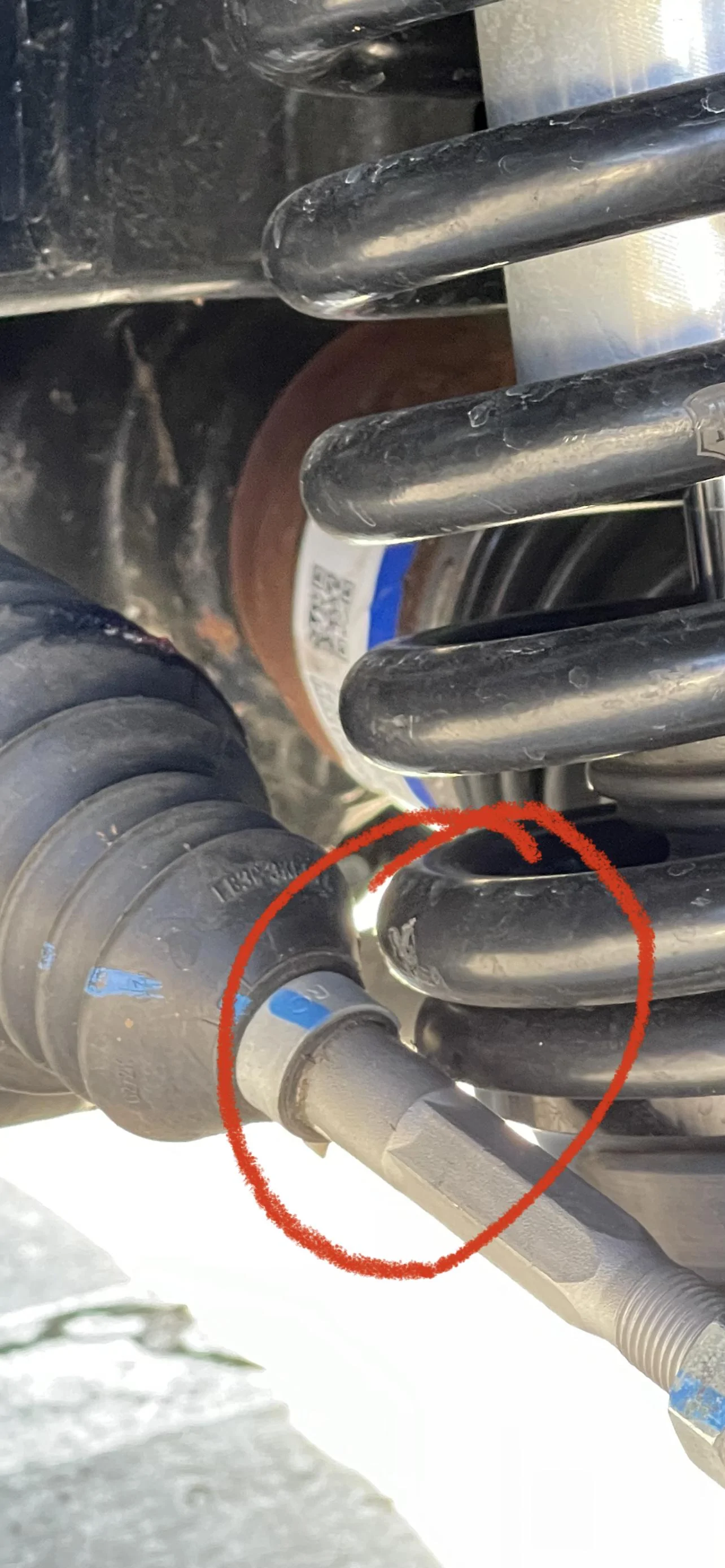

Well his is not an isolated incident, here is my tie rod with out a sleeve making contact and taking chucks out of my springs. Icon should be ashamed that this is even happening. But worse I’m ashamed that I spent $7k+ on these to make my bronco inferior . The only silver lining is my wife isn’t on this forum to know how much money I wasted.

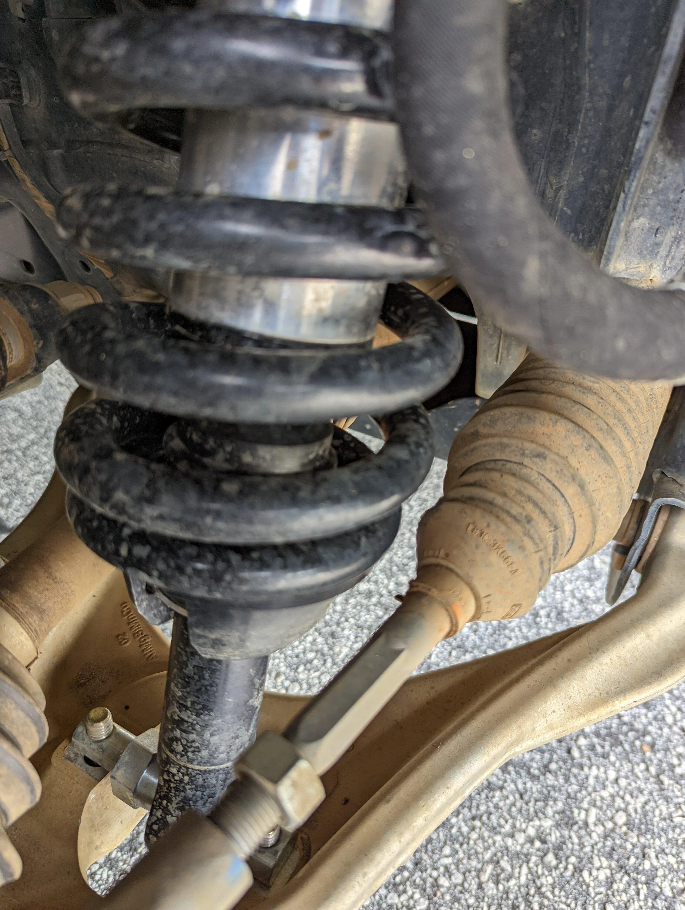

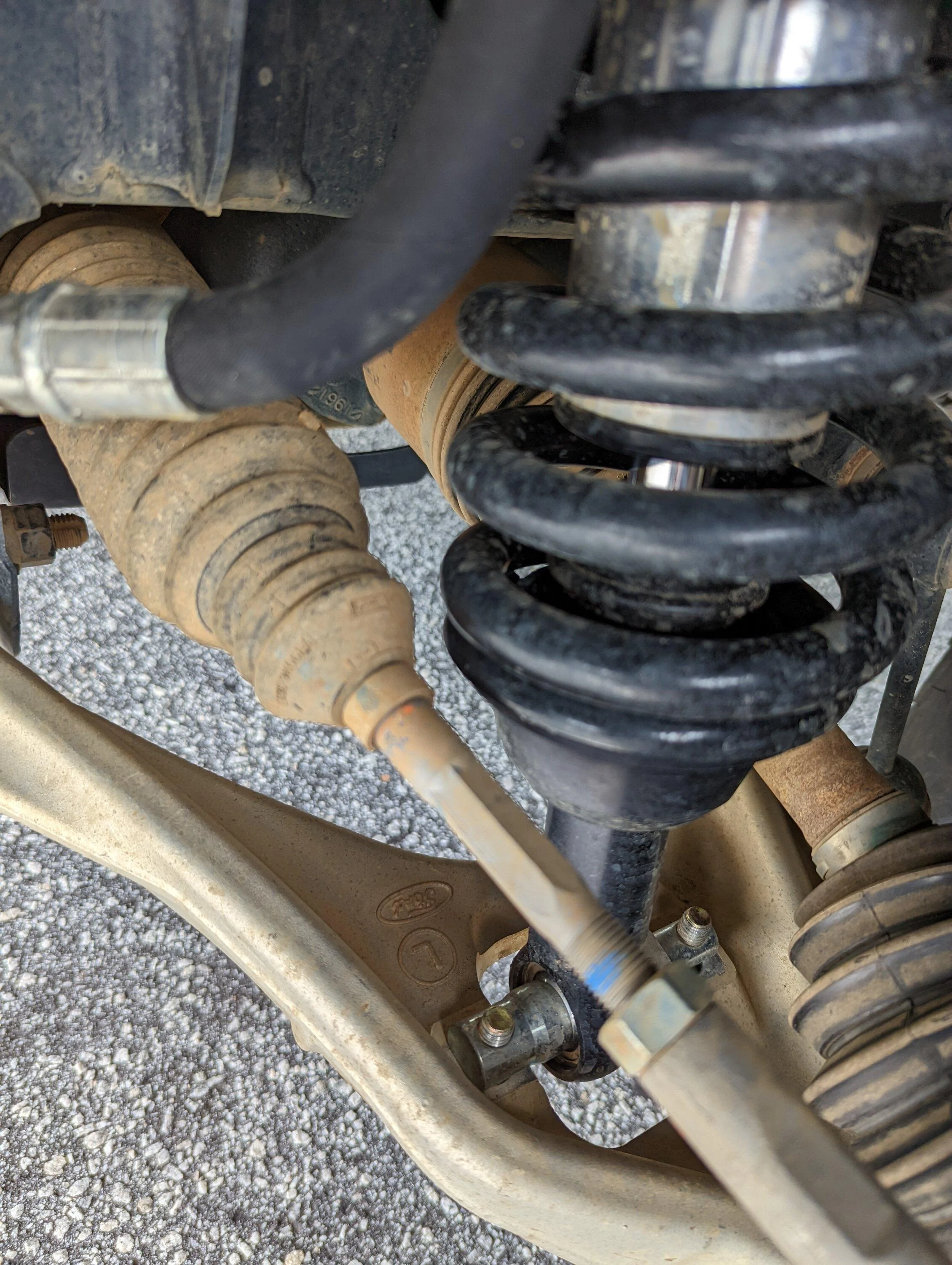

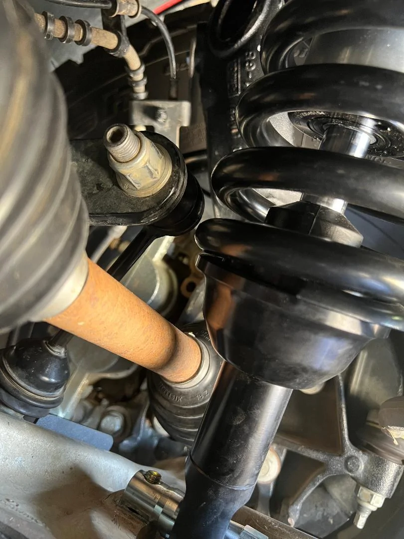

Well installed stage 8 on my bronco and I’m not comfortable with how close the tie rod is to the coil. It really seems like a design flaw by Icon. I’ve since driven about 700 miles and you can see they make contact on the picture below. Not sure I could get a sleeve on them if I even wanted to. I’m super frustrated by this. Totally unacceptable design. Cup should have been raised about 3/4 inch.
This is too close. looks to have been rubbing on the coil already.
Looks like the lower Bar-pin is un equal in offset from center. What does it look like when you turn it around? Looks like a ton of clearance to the axle.
IIRC when I worked on one of the Chevy 1500 kits, the bar-pin needed to be offset to clear something. Made it clear in the instructions to check for that.
Yeah, several posts above address that. It's to clear the sway bar connects on the other side.
I saw. Hard to tell but in some of these picture, there looks to be room. The SB end links shouldn’t move with steering input.

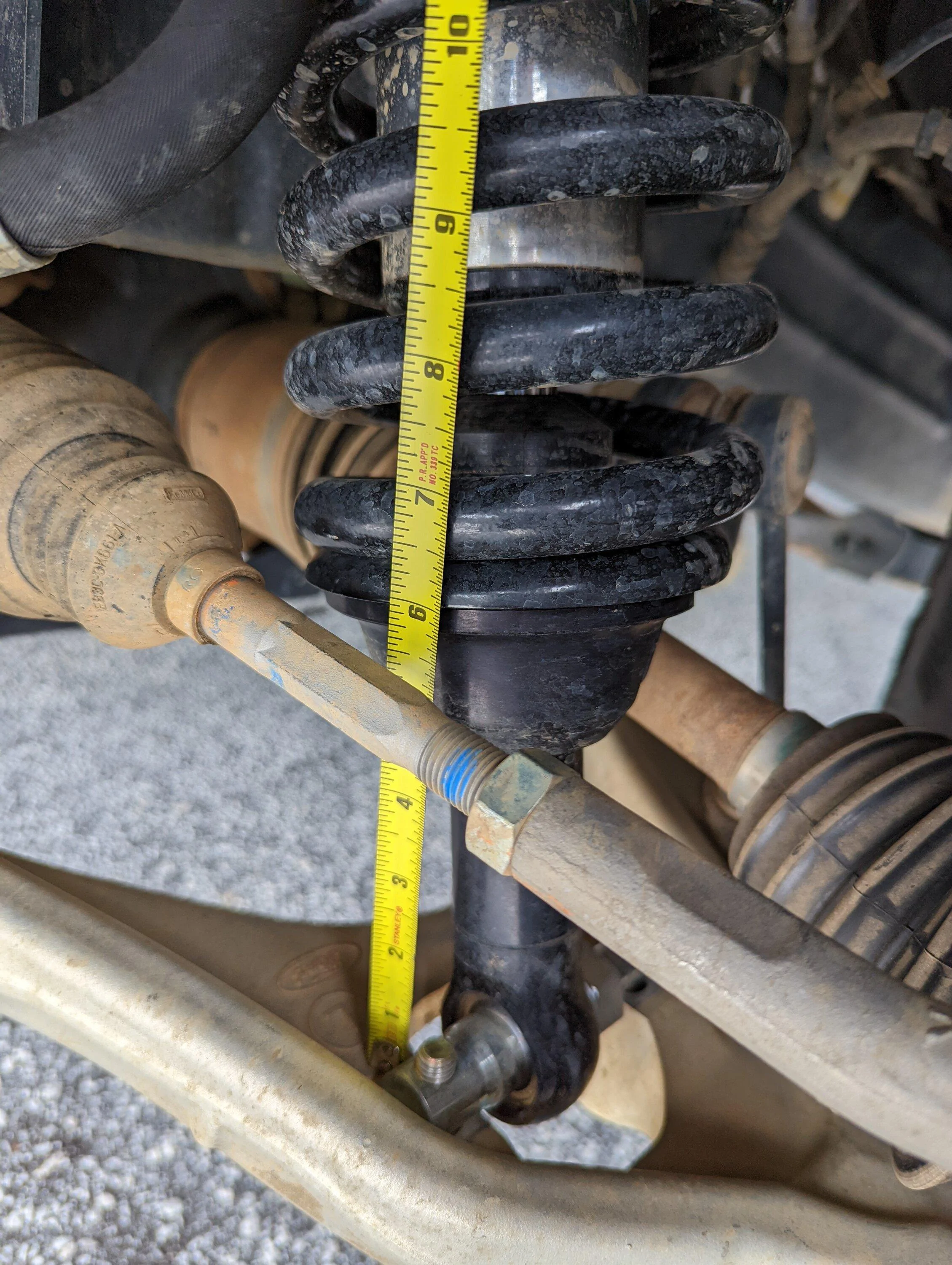

Curious what the measurement is from the lower mount to the spring. One other mfg is 6.5”.

Best I could get in a quickness
Ford Bronco ICON Complete Coilover Suspension Systems (Stages 3 through 8) PXL_20220824_164858245
DREWR13
DREW
529
1,898
ATLANTA GA
2003 Miata....
I also had someone help me and hold the wheel full lock on both driver and passenger sides. no rubbing sitting on flat ground.
Ford Bronco ICON Complete Coilover Suspension Systems (Stages 3 through 8) PXL_20220824_164938538
Ford Bronco ICON Complete Coilover Suspension Systems (Stages 3 through 8) PXL_20220824_164950871
Driver side is a little closer and might have 1 small scratch but cant tell if it was from install or rubbing.

I'm very curious to see how they try to alleviate this issue. As @rtaylor showed with his install, if you install the front coilovers with the offset towards the front of the vehicle, the sway bar link comes just as close to the spring as the tierod did with the other orientation.
These were a few photos from the sway bar link damage to my springs when I swapped the coilovers with the offset towards the front. The same type of damage occurs on the spring from the sway bar as the tierod did from the other side.
As someone else stated, I'm curious if the King or Fox coilovers have the same issue. If they can have their spring and spring cup positioned a little higher, we would be able to confirm that changing the offset of the lower pin is not going to solve most problems people will run into installing the ICON kit.

@Triceratops I apologize for responding before I had better understanding of the issue and what our folks here were doing about it. I regret that I chose my words poorly. We understand your frustration, and If ultimately you want to return the product I think we can arrange that for you. But I really think you'll be happy with the system once we get past this. If you want to try the retrofit we've come up with, we can send the kit to you, probably by tomorrow. Just DM me your address, and please let us know which dealer you originally purchased through.
Everyone, the retrofit kit is a fairly simple installation that anyone who has ever worked on their own stuff should be able to do fairly easily, with no special tools. The kit yields an additional .530" of clearance between the stock tie rod and the coil cup, which should be enough clearance for most tie-rod stiffeners, once caster has been properly set. We have 6 kits that we made in our R&D shop, which we can send out as soon as we're done writing up the instructions and boxing them up, hopefully by tomorrow as I told triceratops. If you would like us to send you one, please DM me your address along with which dealer you originally purchased your kit from. (we are pushing a larger run of them through our production shop, but we have the 6 kits now from R&D, for those with an immediate need).
@JustSendItDude, the retrofit does move the back of the coil cup closer to the sway bar link joint, but not as close as simply flipping the pins around. On our Badlands with the electronic sta-bar, there is plenty of clearance. On non-Badlands it may be a little tighter but should be OK. We're working to verify that now, and I will report back.

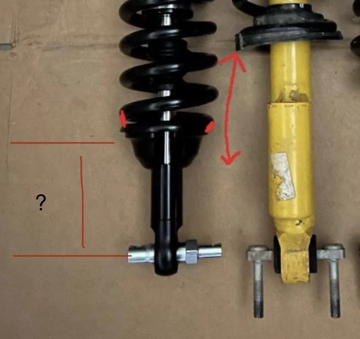

So, I stumbled upon a not-so-good picture of the tierod and King suspension setup. It looks to me that the tierod goes under the lower spring cup on the King suspension, similar to how the SAS coilover allows it to pass under. The owner said the only issue he had with the tierod and KIng coiloverc clearance is when he had the larger BroncoBuster brace.
