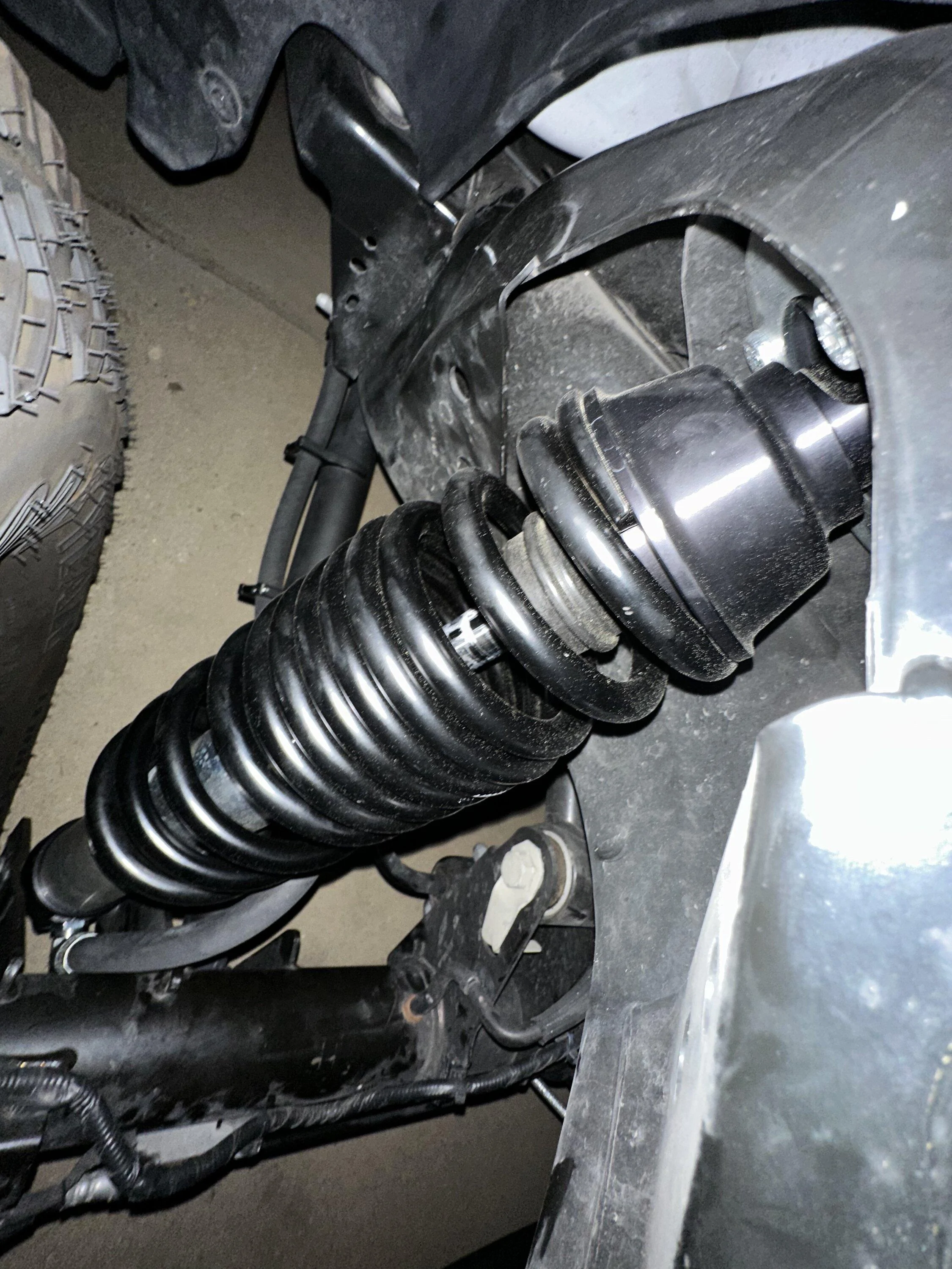

Yay… Icon Squeaks… just installed, rear is squeaking within 20miles

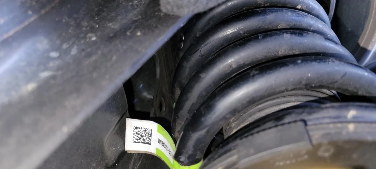

Does it sound like this?

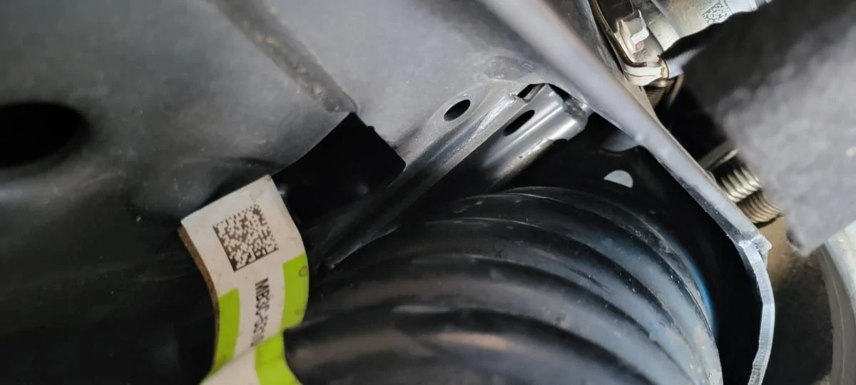

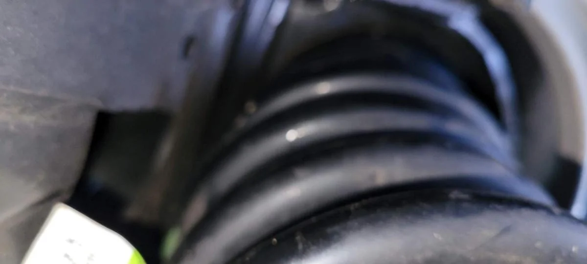

Bent coil spring left front. Coils were making contact with the shock tower.

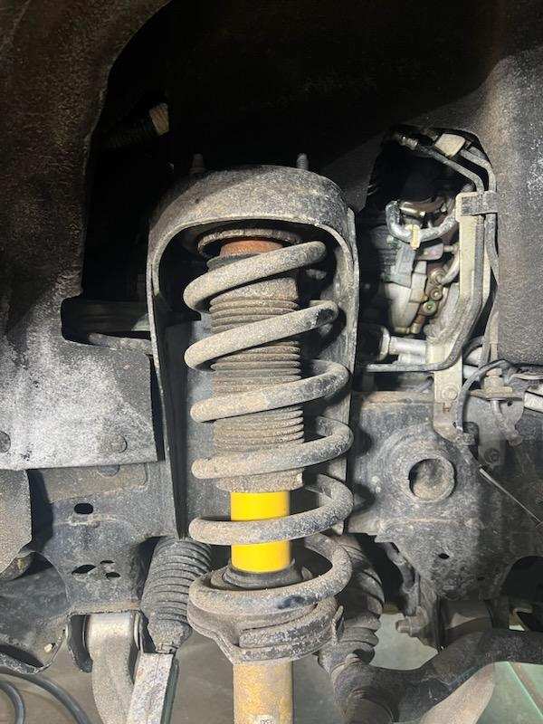

Having this same issue, seems to be coming from the passenger rear. Mine have been on since March but just recently started noticing the squeaking. Also, both rears have corrosion on the body of the shock and the adjustment threads. Did you get any kind of resolution?
