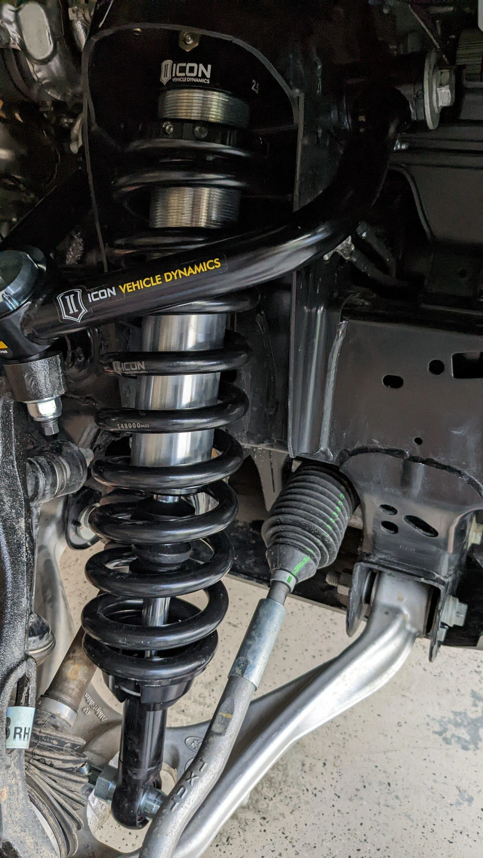

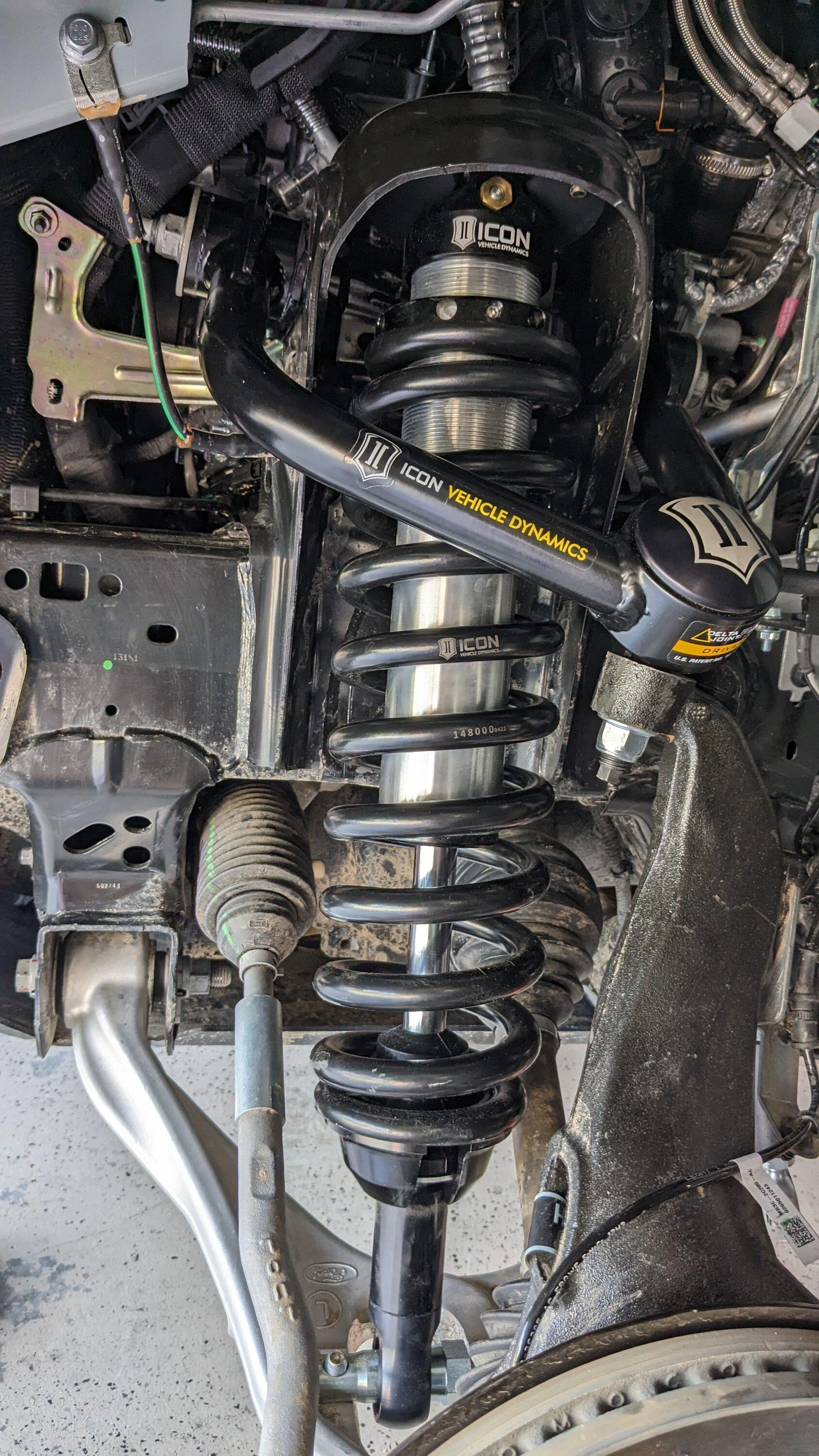

I just installed the icon stage 3 (coilovers without reservoirs and tubular uca's). I am getting some noise from the front coilovers also. This is just 2 weeks after install. I've torqued everything down after a week of use and no change. Everytime I hit a bump or when the weight shifts left or right, I'm hearing a clunk sound. I wish others shared this before dropping $4k on this set up. Had I known, I would have gone another brand.
Still trying to investigate where the sound is coming from. I have the rough country tie rod sleeves and thinking the springs might be hitting them. If that's the case, there's definitely not enough clearance in their design.
You can clearly see the marks where the sleeve is hitting the spring.
I wonder if flipping that lower mount would fix the clearance.
There are serious clearance issues that vary between Broncos. You can try rotating the lower mount, but there is a good chance that your swaybar link will hit the spring instead. I wasn't willing to sacrifice turning angle or rip up my tie rod boot, so currently my swaybar links contact the spring near full droop (may be limiting travel).
Icon is aware of the problem. They provided prototype fixes to a few owners about 2 months ago, but the rest of us are still waiting for a "production" fix (replacement stud that centers the shock instead of offsetting forward or rearward). @Dusty at ICON was keeping a list of people needing the fix, but maybe now you just have to complain directly to Icon. I suppose another option is to send them back.
